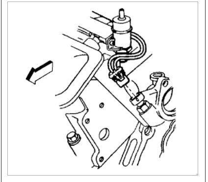

To me it sounds like the engine coolant temperature sensor is shorting when the engine is cold. Here is a guide to help you see what you are in for where doing the job:
https://www.2carpros.com/articles/coolant-temperature-sensor-cts-replacement
Here is the location for your car. Check out the diagrams (below). Please let us know what you find.
