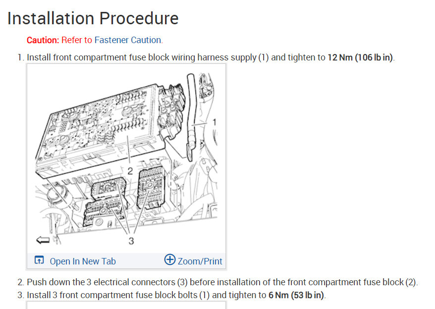

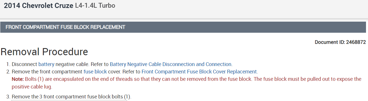

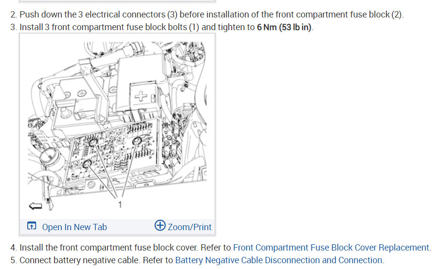

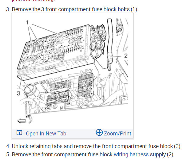

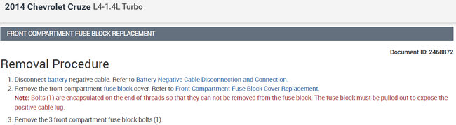

Wow thats hot, I have seen the junction box go bad and cause this problem, but it would be good to run a scan as well and check the alternator output. Here is how to replace it which is easy because it self learns. Check out the images (below). Please let us know what happens.
Jul 5, 2024 at 9:50 AM

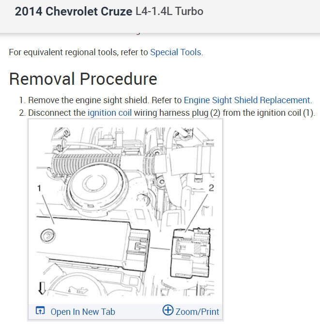

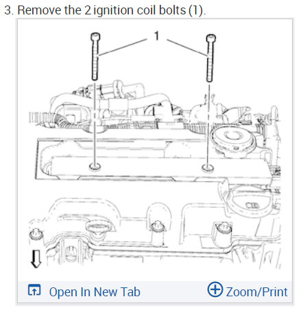

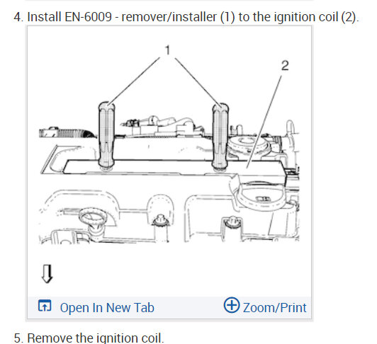

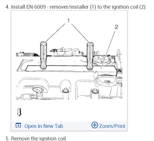

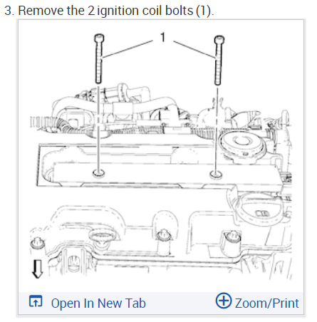

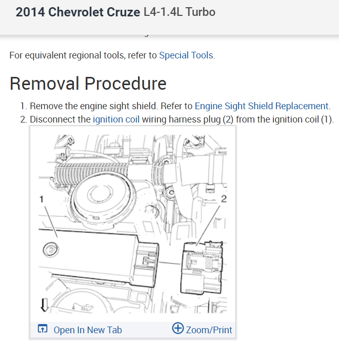

I would replace the coil pack as well, it sound have an internal connection problem. I have heard of the coil packs having issues as well. Check out the images (below). Let us know what you find.
Jul 9, 2024 at 9:59 AM
