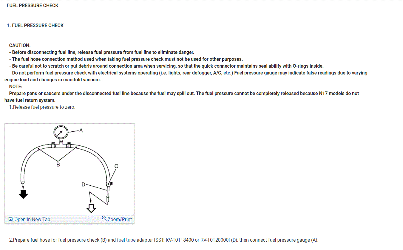

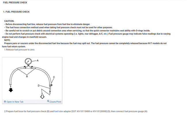

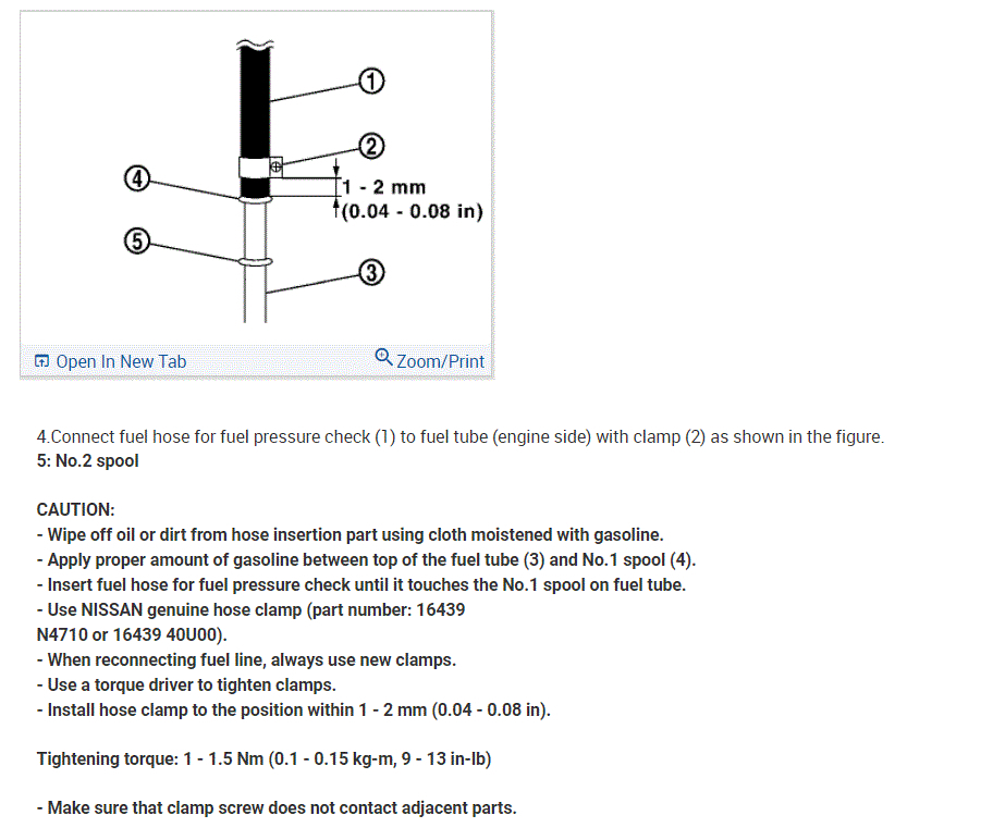

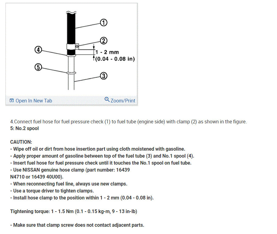

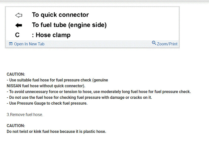

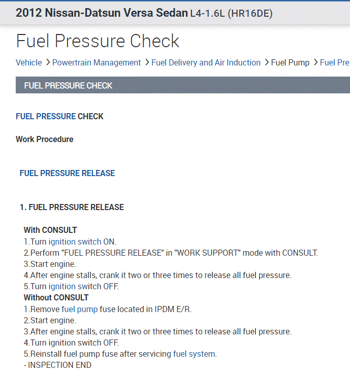

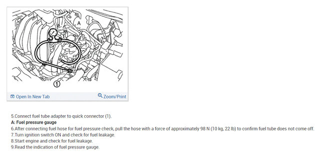

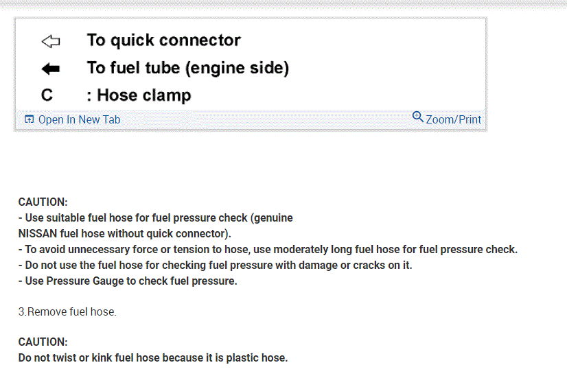

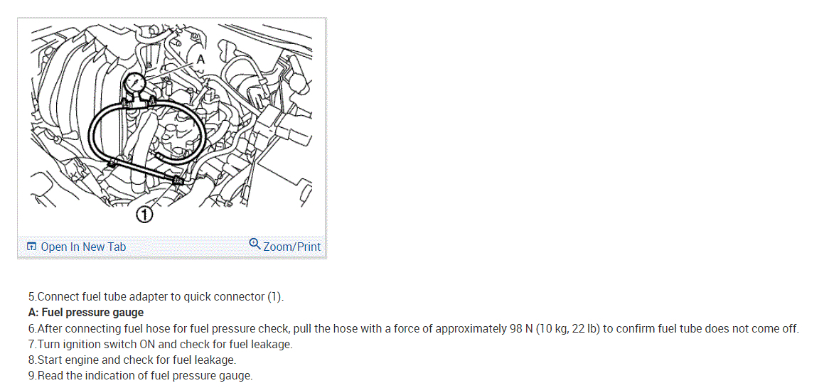

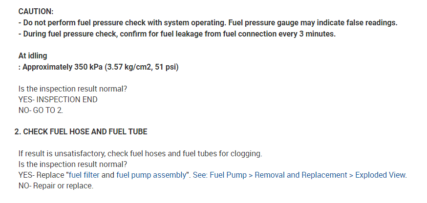

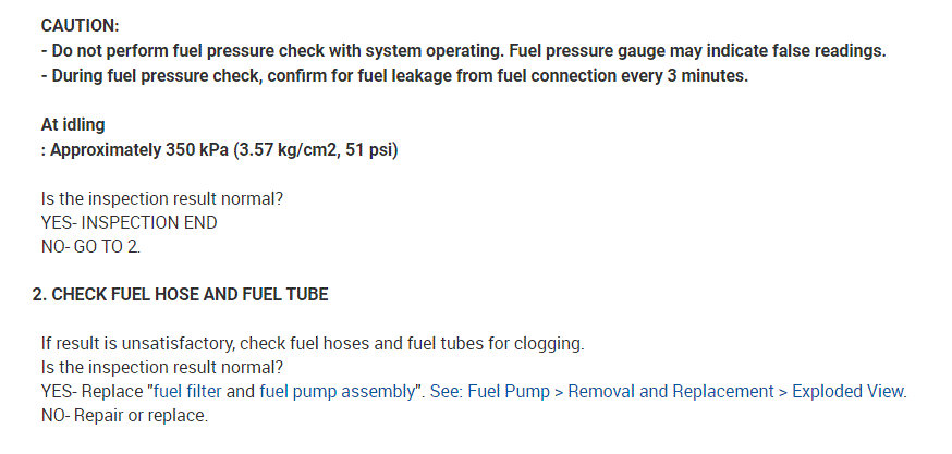

The lean mixture could indicate low fuel pressure. If you haven't already, check the pressure. Here is a link that shows how it's done:
I've also attached the procedures specific to your vehicle and the manufacturer's fuel pressure specifications below.

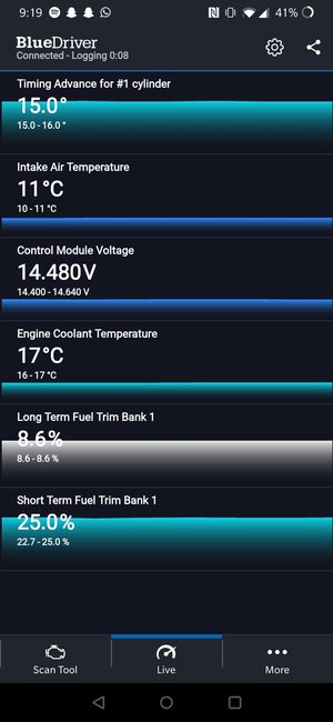

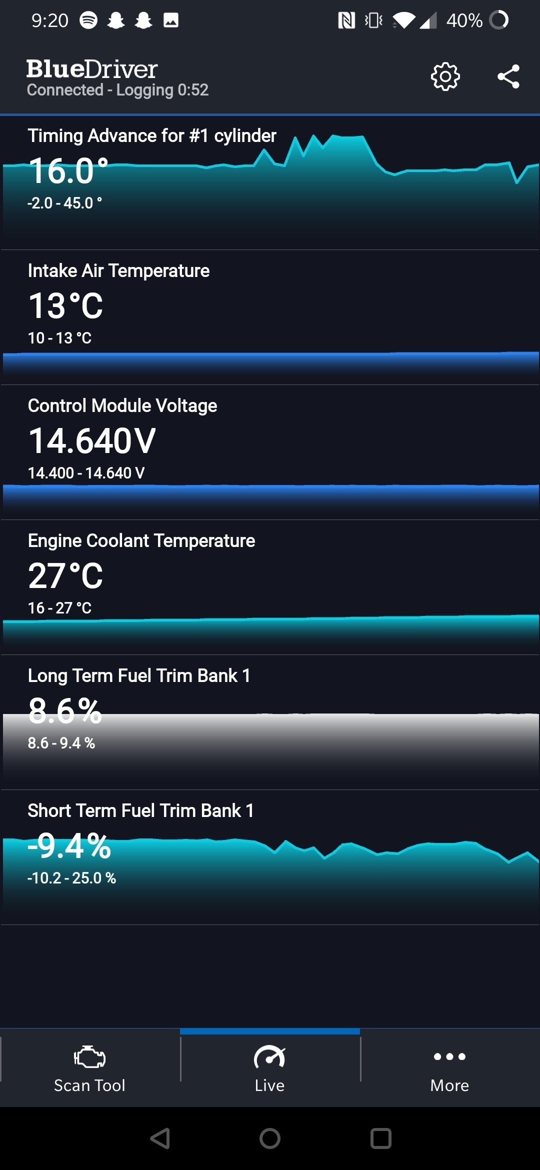

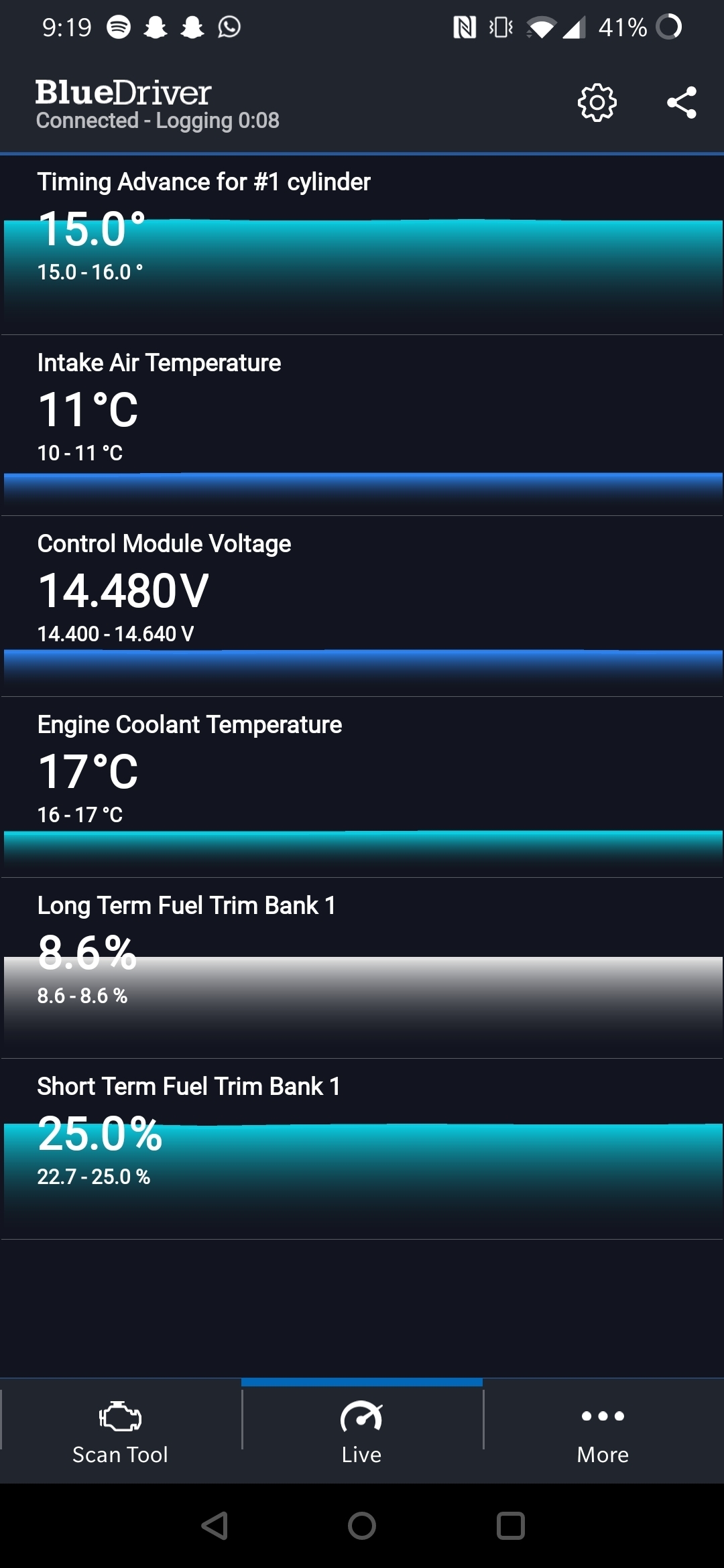

If you have a live data scan tool, you can check the short-term fuel trims. That will help you determine if there is an issue.

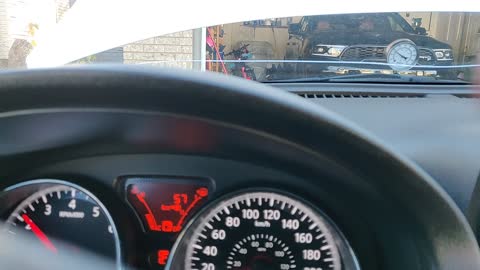

I am not really sure how to read the short-term fuel trim. But when I turn the car on and it's cold it shows 25% and when I rev it goes to -9/-10%.
Something else weird that was happening last time I was testing is that the traction control light turned on and the ABS light as well for a few seconds, even though I didn't press the button.
I also heard a clicking noise (relay) from the left side of the steering wheel, where the traction control button is. That happened every 3 seconds.

Under normal conditions, fuel trims should be between -10% and +10% at idle. I do notice the coolant temperature is showing approximately 17c. What that the approximate outside temperature when it was checked?
Also, the trims (short term) are very high. That indicates the computer is trying to add fuel to the engine to reach the best air/fuel mixture. However, that could be because it is cold. Could you recheck trims at operating temperature?

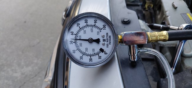

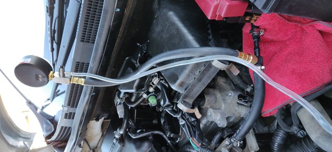

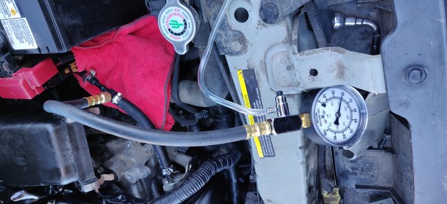

The fuel pressure gauge shows around 30PSI when idling and it loses around 2-4PSI when I press the gas pedal.
Should I assume the fuel pump / filter is bad and replace it? I still didn't get the crankshaft position sensor.
I also didn't find any leaks in the fuel line; it is still the same (30 psi) after 30 minutes.
I'll recheck the trims with car at normal temperature, outside temperature now is ranging from 0 - 7 °C.
Oct 30, 2021 at 1:35 PM

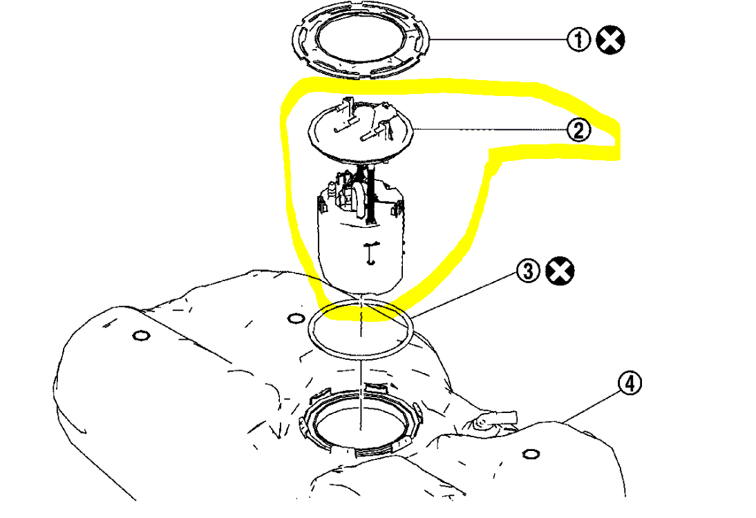

The drop in pressure when you hit the throttle is normal. The pressure is too low, however. It indicates 51 PSI in the manual when idling. Either you have a filter plugged or a tired fuel pump.
The filter is in the fuel tank. I circled the pump, sender, and filter in the pic below. Let me know what I can do to help.

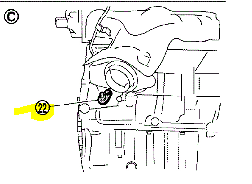

Just waiting for the fuel pump to arrive now. I'll try to install the crankshaft position sensor as soon as I locate it, I've tried with some diagrams but no luck so far.
Nov 3, 2021 at 8:46 PM
The crankshaft position sensor should be toward the rear of the engine block. Take a look at the pic I attached and let me know if that helps.
