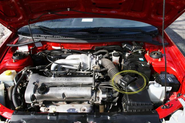

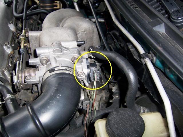

which one do we need to check sir roy, i have two pictures here. thanks for helping us sir.. were a little bit confused now :))

or this one?
May 12, 2013 at 9:59 AM
the second one. that is the idle air. the first is the mass air flow

I see thanks Mr. Roy if ever wiring is good, then we have to replace the whole thing that is connected to the throttle body right?
