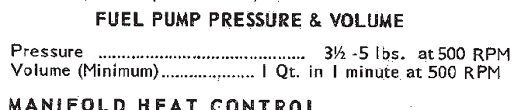

SO FAR
THOSE 2 ITEMS ARE THE FURTHEST FROM MY DIAGNOSIS, MAYBE AFTER THE RIGHT FRONT TIRE! lol!
I'M STICKING WITH FUEL (OR SOMETHING IN THAT SYSTEM)
OR IGNITION
THE "NOT FULL FUEL FILTER" IS NORMAL (MOST OF THE TIME) AS ONLY WHAT'S NEEDED GOES THRU
YOU MIGHT VERIFY THIS BY HOLDING THE OUTLET END UP (VERTICAL) AND WATCH IT FULLY FILL AS IT MUST FILL UP TO REACH THE UPPER HOSE
STILL, WITHOUT RULING OUT A CARB PROBLEM (OR MAYBE A FILTER, A SMALL ONE, SCREWED INTO THE CARB, THAT YOU MAY HAVE OVERLOOKED, THAT MAY BE MOSTLY STOPPED UP) I HAVE SEEN FOLKS THAT DID NOT KNOW THAT WAS A FILTER - NOT PART OF THE CARB. CASE IN POINT FELLER W/ 1976 FORD F-150 2 BBL CARB AT ADVANCE AUTO PART'S PARKING LOT
LET'S RULE OUT A TANK TO THE FUEL PUMP PROBLEM
WE'RE GONNA "JUG IT" (THAT IS, IF YOU DO NOT HAVE A RETURN LINE TO THE TANK)
LET'S GET A ANTIFREEZE JUG (OR SIMILAR) AND DRILL A HOLE BIG ENOUGH IN THE JUG'S CAP FOR THE RUBBER HOSE THAT ENTERS YOUR FUEL PUMP- SUCTION SIDE (GAS TANK SIDE)
(MINE, ON MY JEEPS WOULD BE 5/16)
TIE/ WIRE THE JUG NEAR THE FUEL PUMP TO THE VEHICLE
TAKE THE "FUEL TANK" HOSE LOOSE AT THE FUEL PUMP
USING A LONG ENOUGH, NEW/ FRESH PIECE OF HOSE, STICK IT INTO THE DRILLED HOLE ALL THE WAY TO THE BOTTOM OF THE JUG
THEN HOOK IT TO THE FUEL PUMP
NOW, THE SCREEN/ SOCK/ CRIMPED OR COLLAPSED LINE/ OR ANY HOLE PRIOR TO THE PUMP IS NO LONGER IN THE EQUATION
FILL THE JUG WITH FUEL, AND DRIVE IT 'ROUND AND 'ROUND THE BLOCK, JUST IN CASE YOU MIGHT HAVE TO WALK BACK!
DID WE MAKE IT FURTHER?
