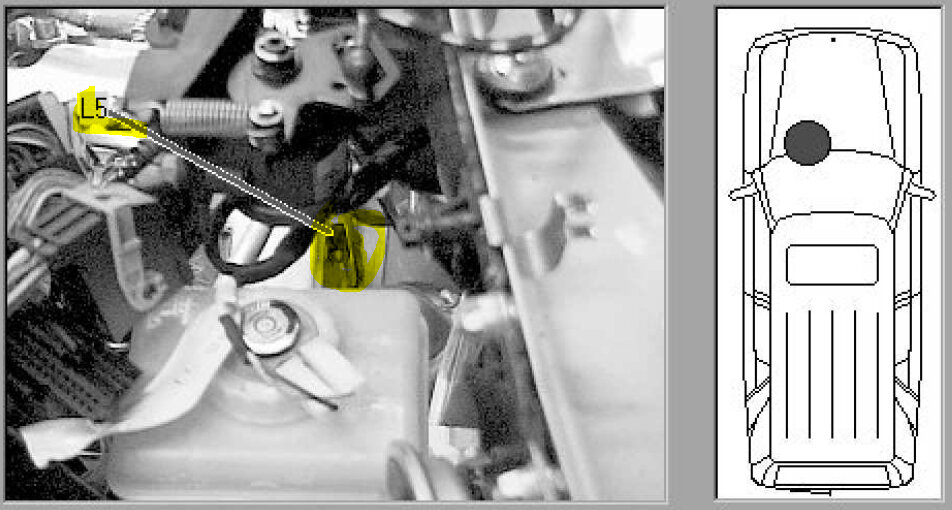

It sounds like the crankshaft position sensor is bad. When they begin to fail, they are adversely affected by heat. When the engine gets to operating temperature, the sensor fails, and you lose spark to the spark plugs. That would explain why it wouldn't start with starting fluid.
Do me a favor and take a look through this link and let me know if it mirrors what you experience:
If that makes mirrors what happens, I attached a pic below showing the sensor location, at the top rear of the engine at the flywheel housing.
Let me know if this helps or if you have questions.
See pic below.
