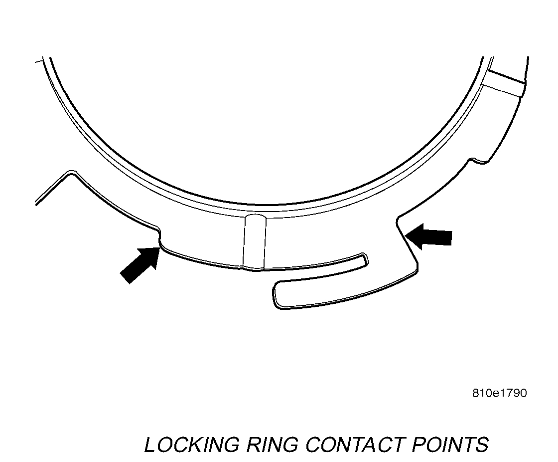

6. Remove Fuel Pump Module lock ring.

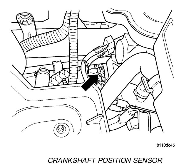

Locking Ring Contact Points
picture 1
NOTE: Use a brass punch to remove the 1/4 turn lock ring. Make contact only at the points.

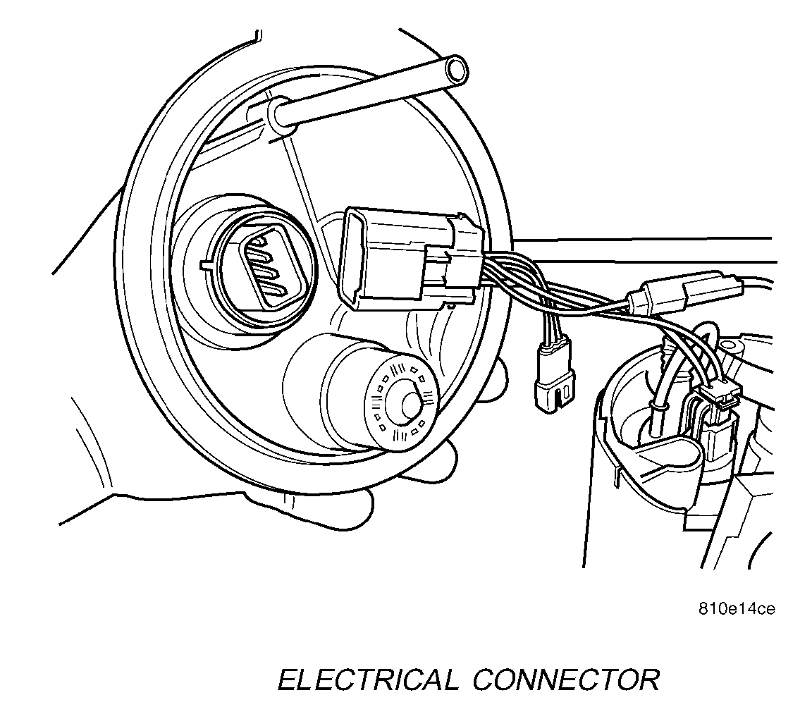

Electrical Connector
picture 2
9. Disconnect electrical connector.
10. The wire connector to the passenger side level sensor needs to be disconnected before removing the reservoir from the tank.

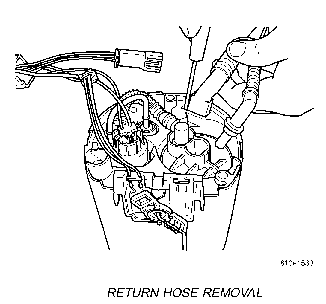

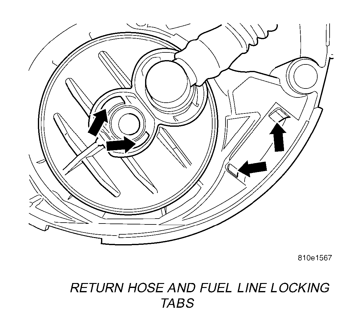

Return Hose And Fuel Line Locking Tabs
picture 3
11. Tab location in fuel pump module for return line and fuel supply line.

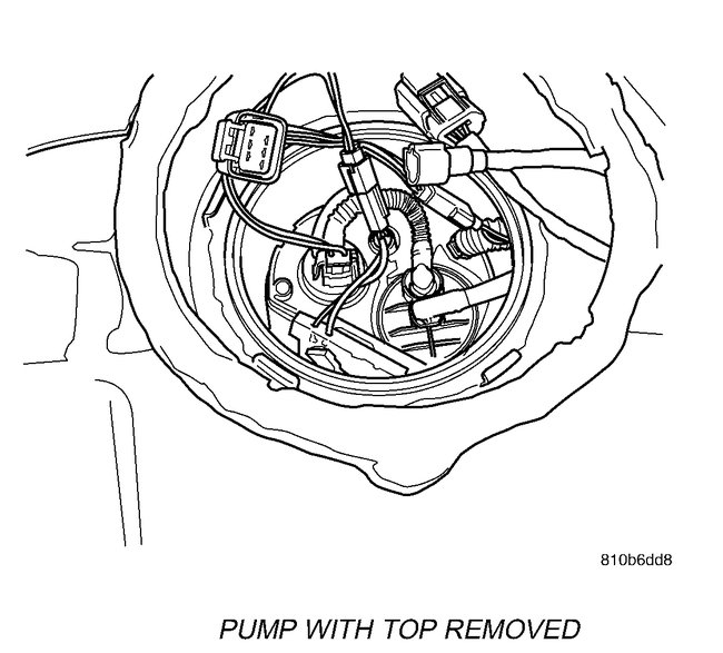

Return Hose Removal
picture 4
12. Remove return line from pump module. Use a small screwdriver to pry tab back and tip hose to one side. Pry tab on other side back to release hose.
CAUTION: Care should be taken to not crack/break the locking tabs or supply line fitting.
13. Remove fuel line from top of the pump module. Use a small screwdriver to pry tab back and tip hose to one side. Pry the tab on other side back to release hose.

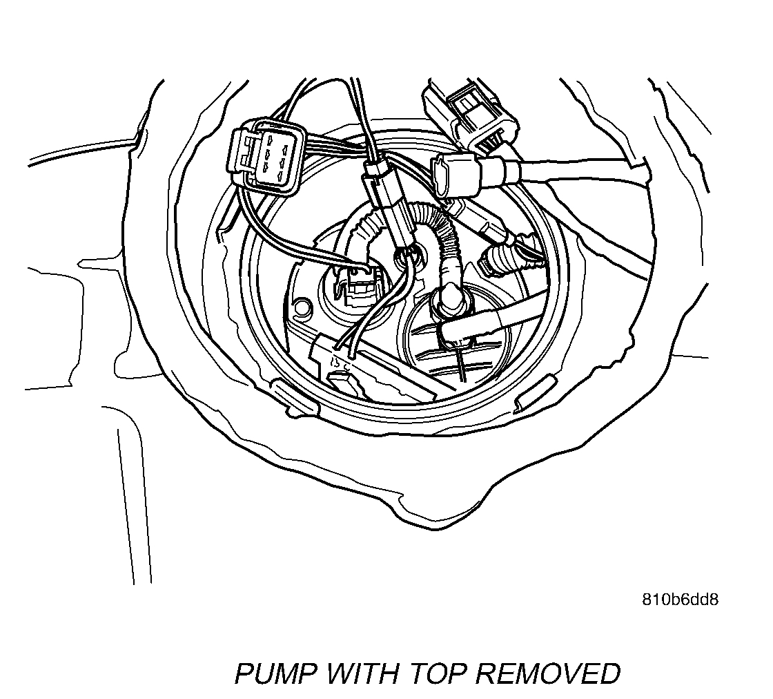

Pump With Top Removed
picture 5
2. Connect siphon and fuel line to fuel pump module.

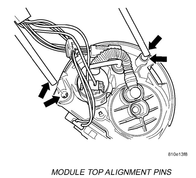

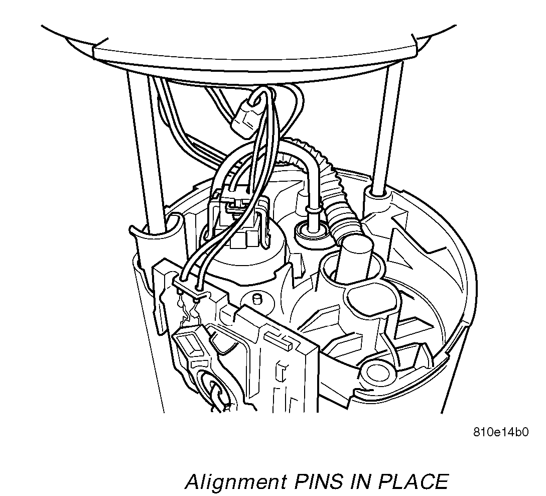

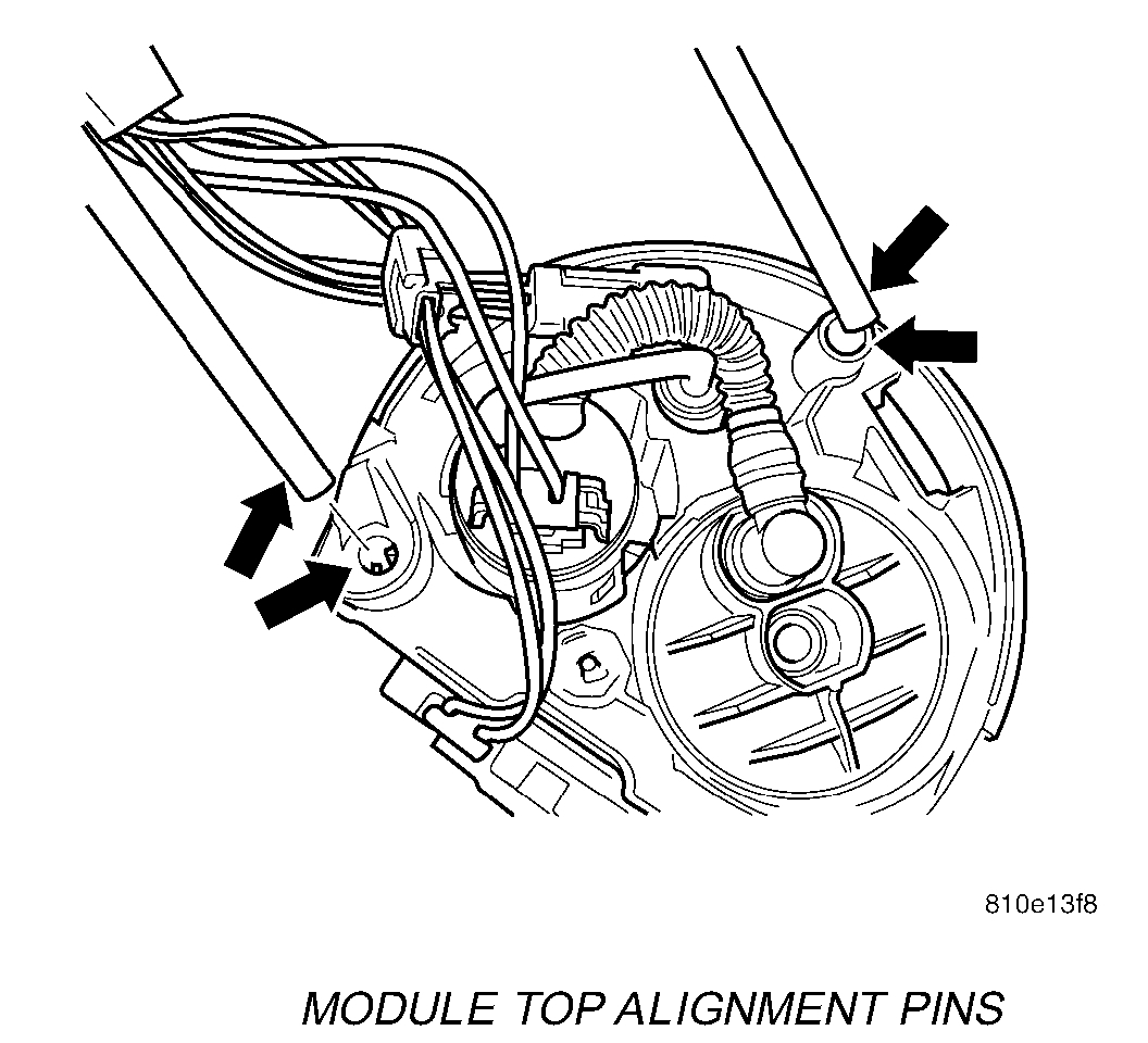

Module Top Alignment Pins
picture 6
Alignment Pins In Place
picture 7
5. Install fuel pump module top to module.
6. Install Fuel Pump Module gasket and lock ring.

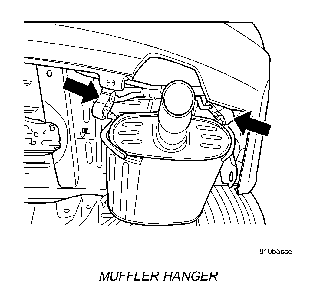

Muffler Hanger
picture 8

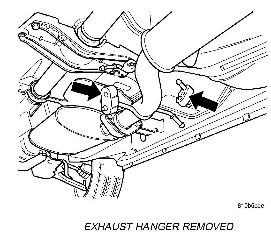

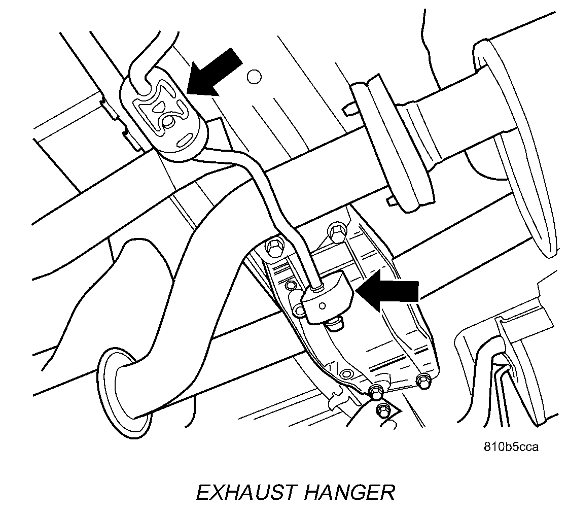

Exhaust Hanger
picture 9
Exhaust Hanger Removed
pic 10
8. Remove the center exhaust hanger rubber grommets.
9. Remove the rear portion of the exhaust system and set on floor.

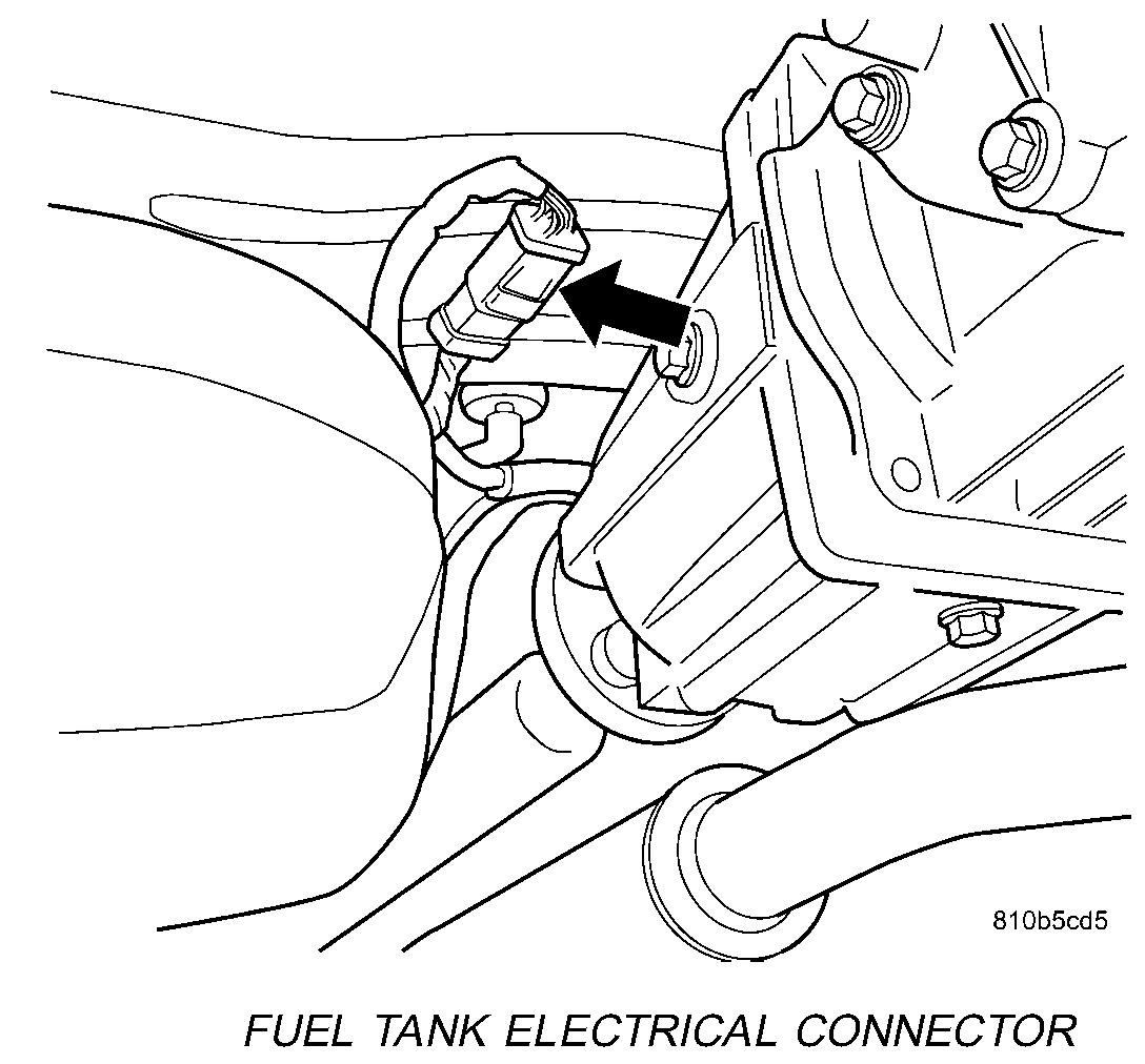

Fuel Tank Electrical Connector
picture 11
10. Disconnect the fuel tank electrical connector.

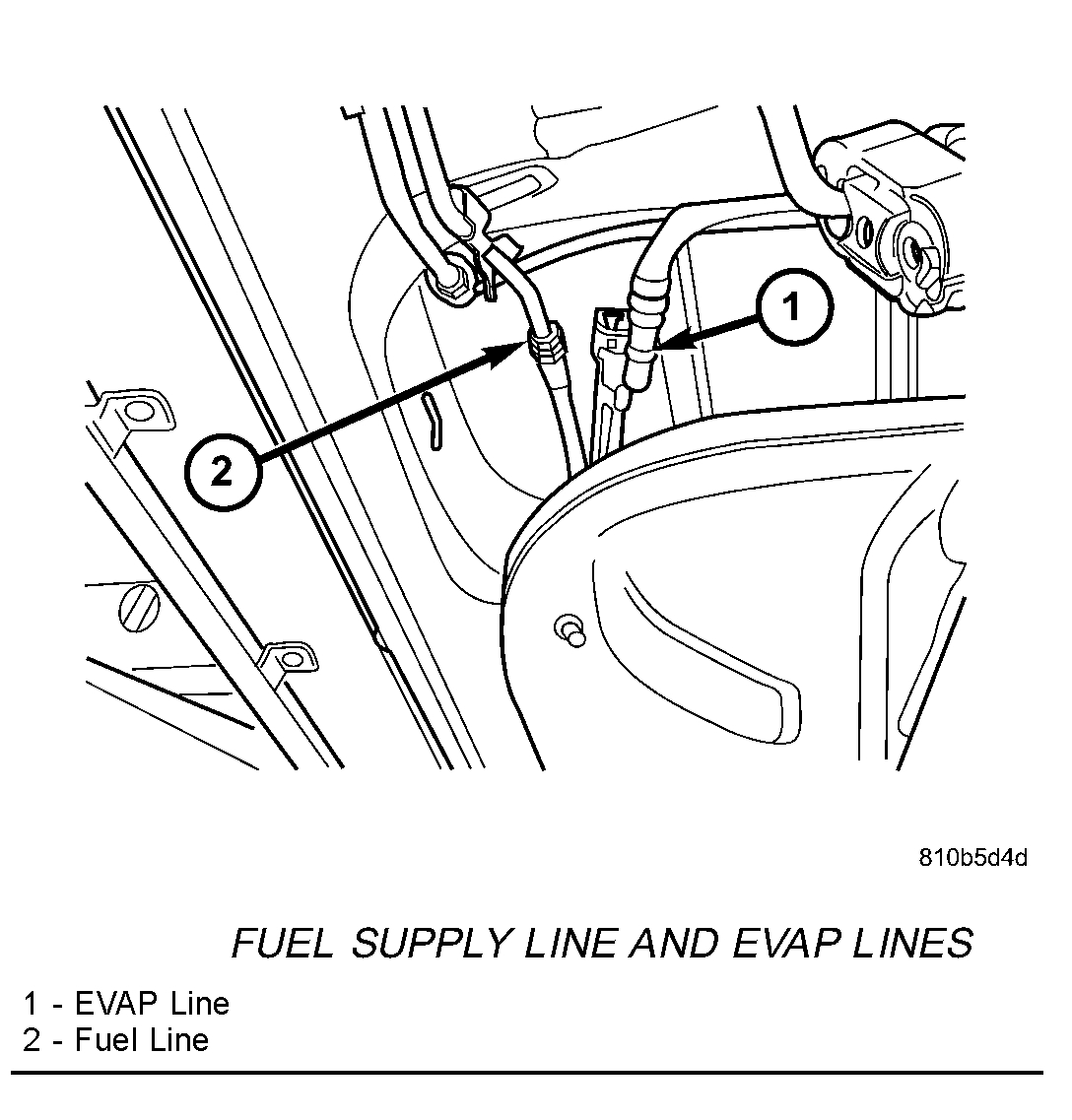

11. Disconnect the fuel line and EVAP line.

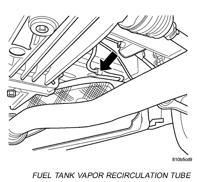

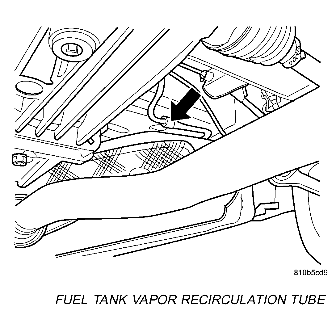

Fuel Tank Vapor Recirculation Tube
picture 13
12. Disconnect the vapor recirculation tube.

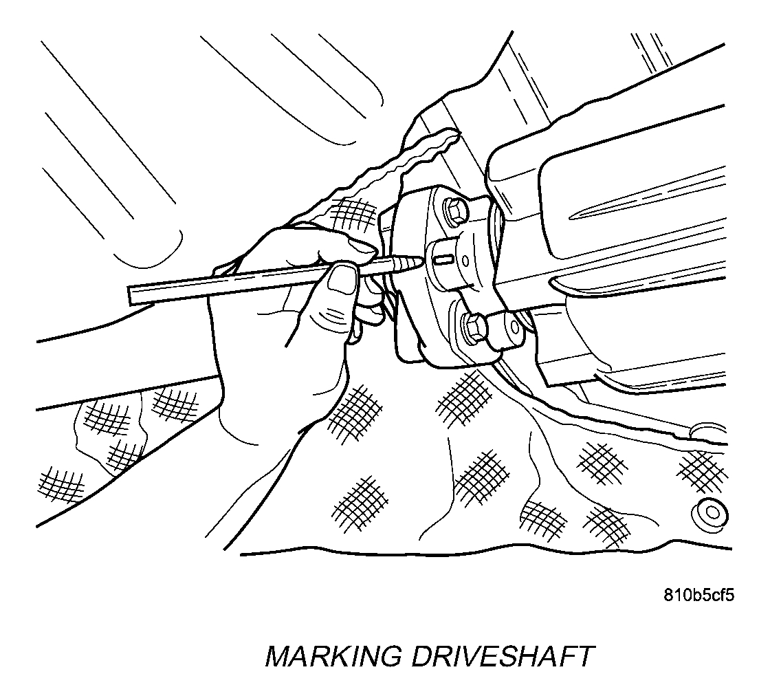

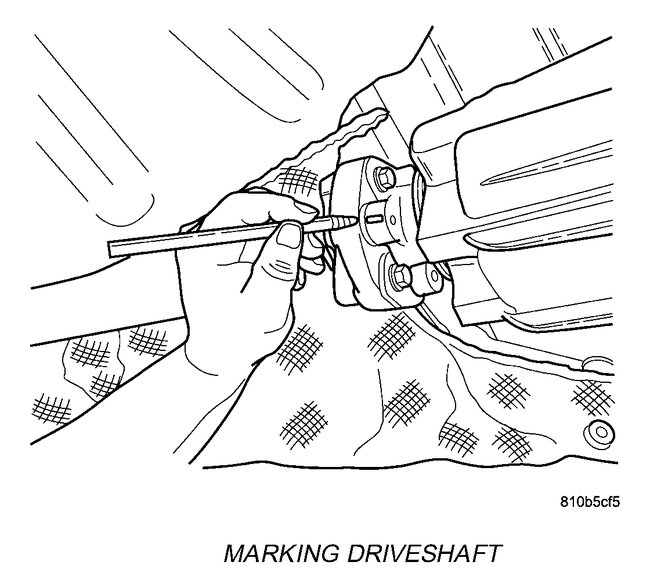

Marking Driveshaft
picture 14

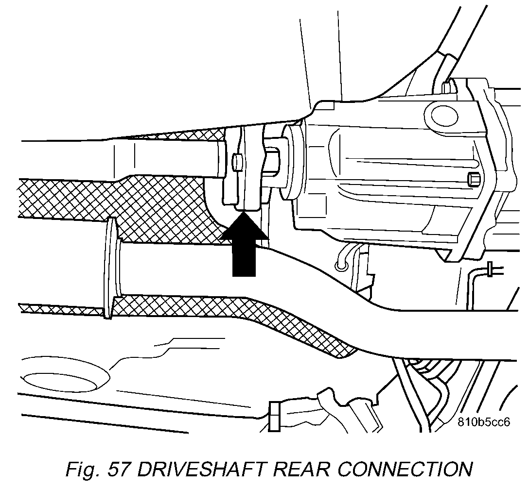

13. Mark the driveshaft rear connection.
Driveshaft Rear Connection
picture 15
14. Disconnect the driveshaft rear connection.

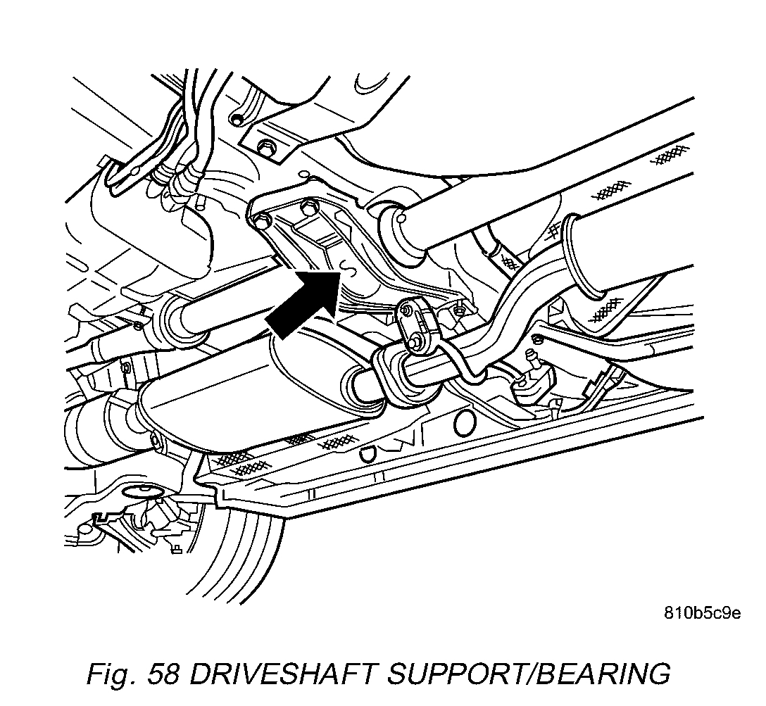

picture 16
15. Remove the driveshaft support/bearing.
16. Support driveshaft on jack.

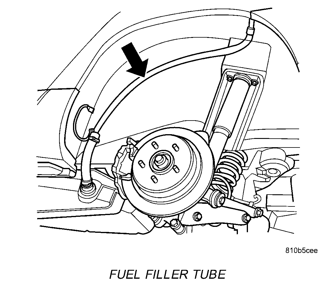

Fuel Filler Tube
picture 17

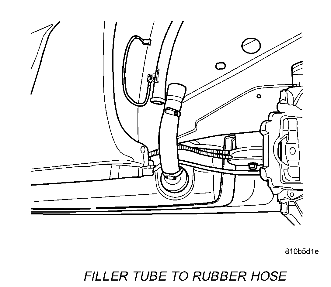

Filler Tube To Rubber Hose
pic 18
18. Remove the fuel filler tube from the rubber hose at fuel tank.

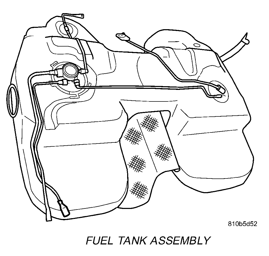

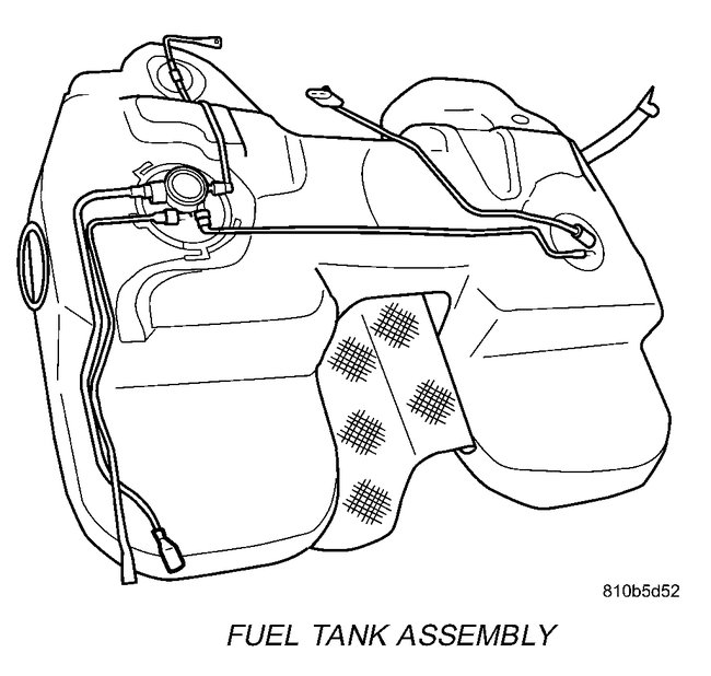

19. Support the fuel tank with a transmission jack.

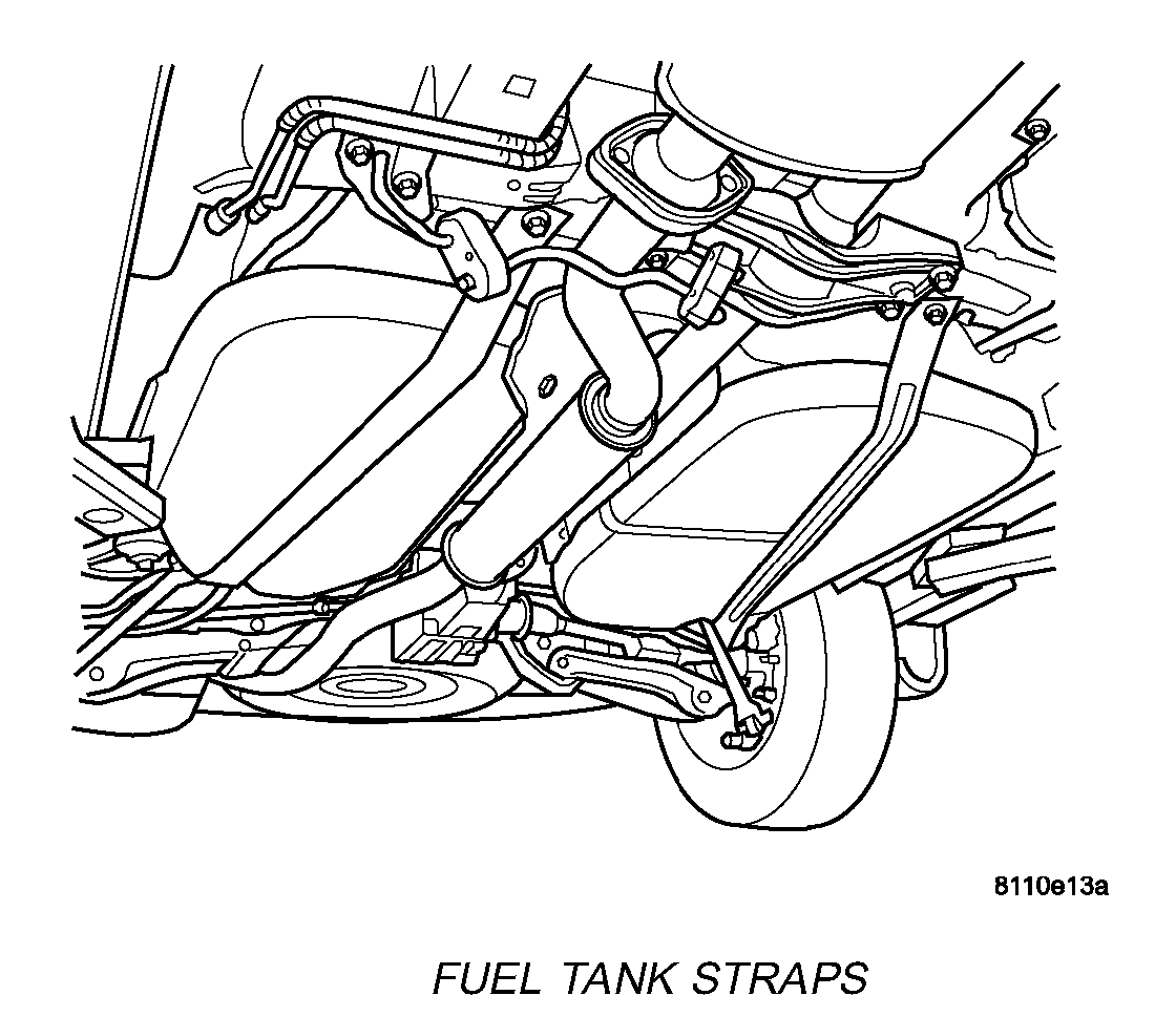

Fuel Tank Straps
picture 19
20. Remove the 2 fuel tank straps.
21. Lower fuel tank
22. Drain Fuel Tank, use an approved GASOLINE draining station.
Fuel Tank Assembly
picture 20
23. Remove tank from vehicle.

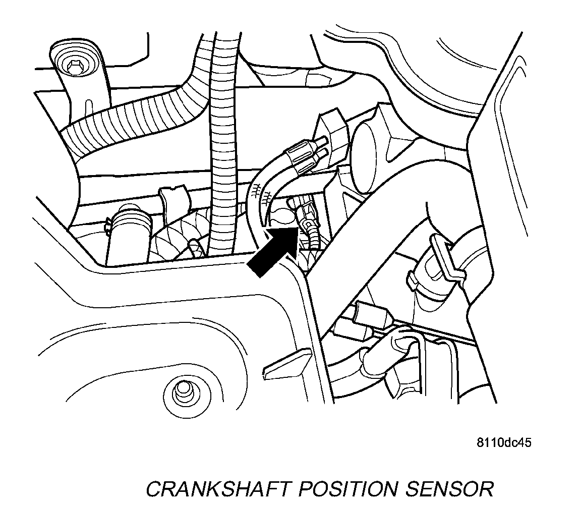

Here are the directions specific to replacing the sensor for your vehicle. The last two pictures correlate with this procedure.
REMOVAL
Crankshaft Position Sensor
Picture 21
The crankshaft sensor is located on the driver side of the vehicle, above the differential housing. The bottom of the sensor sits above the drive plate.
1. Disconnect the negative and positive battery cable.
2. Remove the battery.
3. Unlock and disconnect electrical connector from crankshaft position sensor.
4. Remove sensor mounting screw. Remove sensor.

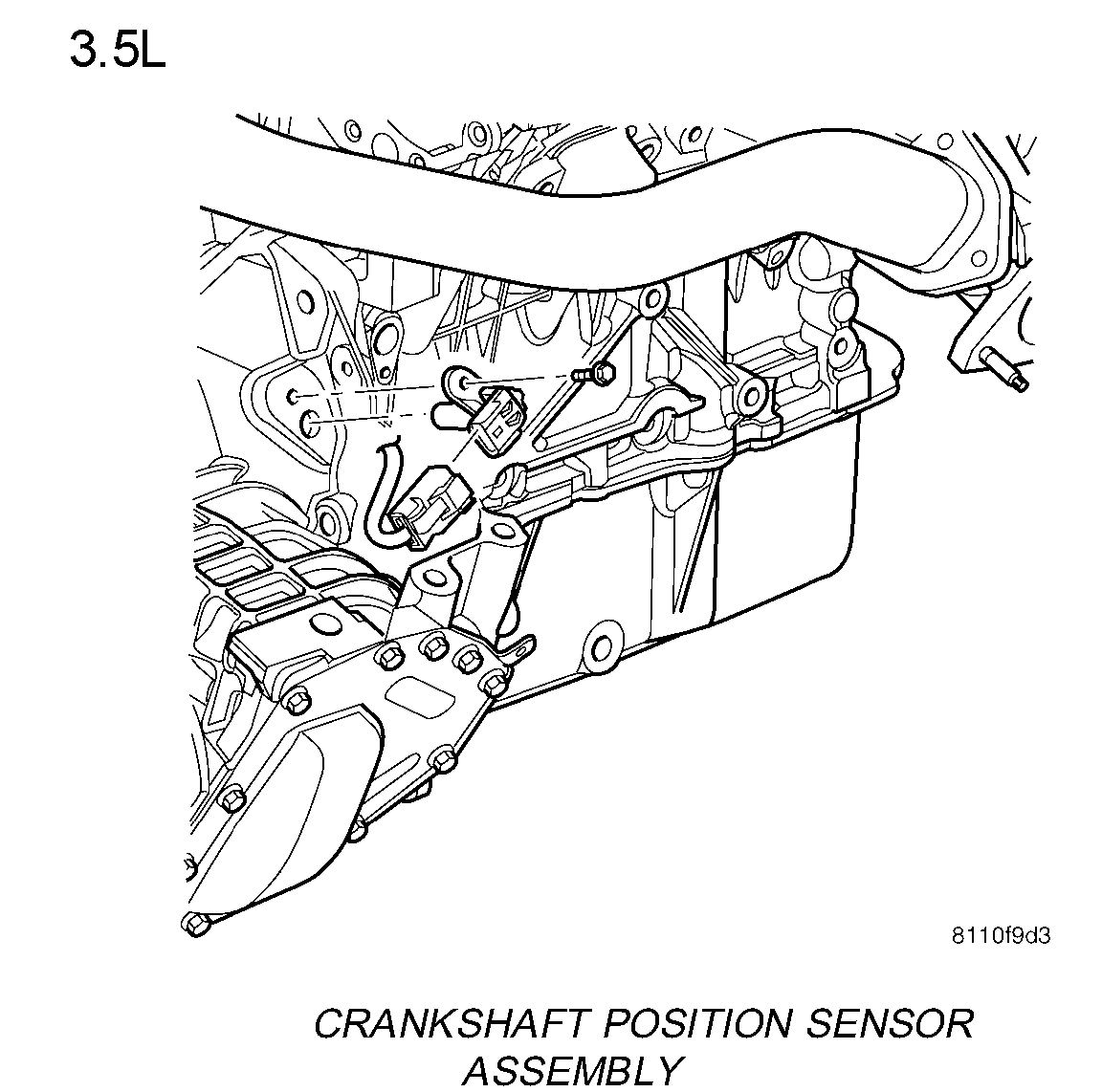

INSTALLATION
Crankshaft Position Sensor Assembly
Picture 22
1. Install sensor and push sensor down until contact is made with the transmission case. While holding the sensor in this position, install and tighten the retaining bolt to 12 N.m (105 in. lbs.) torque.
2. Connect electrical connector and lock to crankshaft position sensor.
