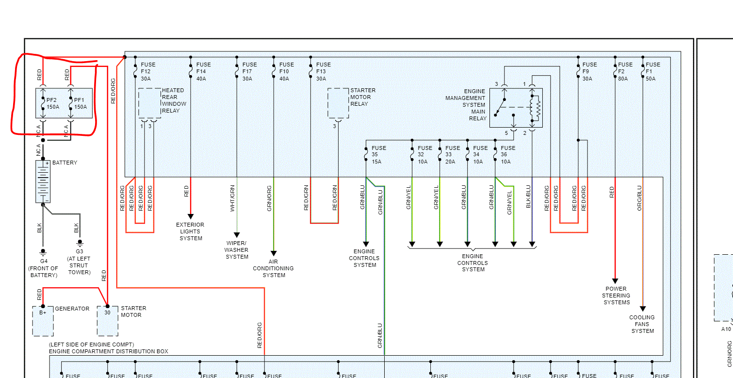

Also, if the battery in the car is good, there are two fuses that are mounted to the positive battery cable. These are high amperage fuses. Check them to make sure they are not blown. If you look at the attached pic, you will see they power nearly everything.
