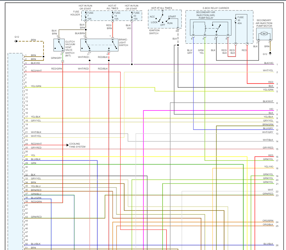

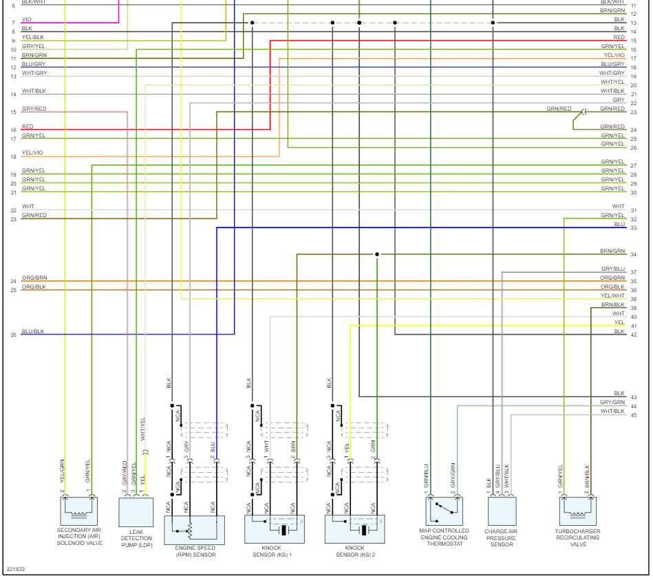

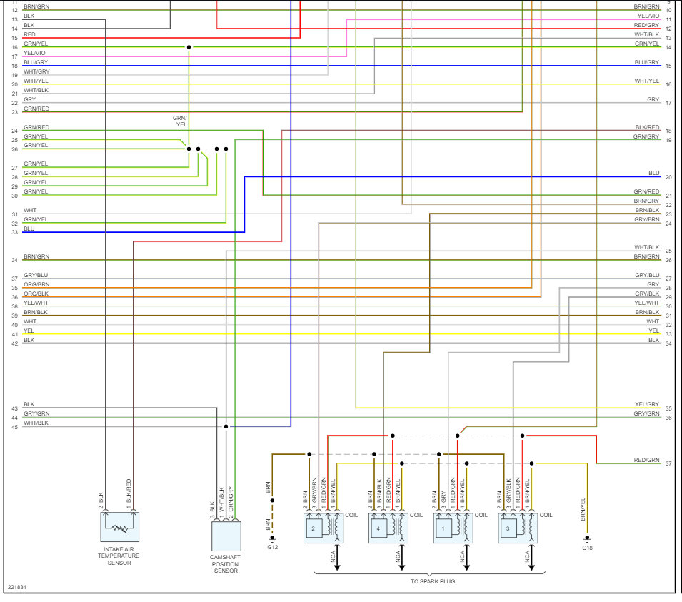

Engine cranks but does not start, can I get the wiring diagram for the connector to the camshaft position sensor?
2005 AUDI A4
19,600 MILES • 1.8L • 4 CYL • TURBO • 4WD • MANUAL
HATDOZER

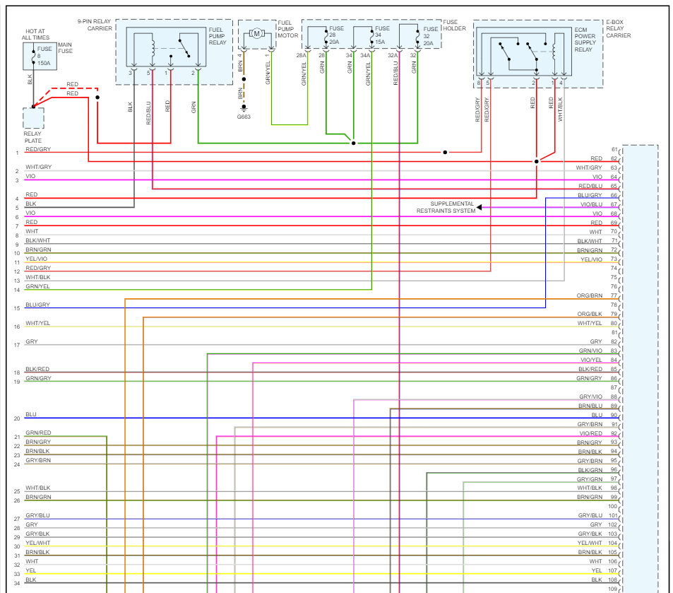

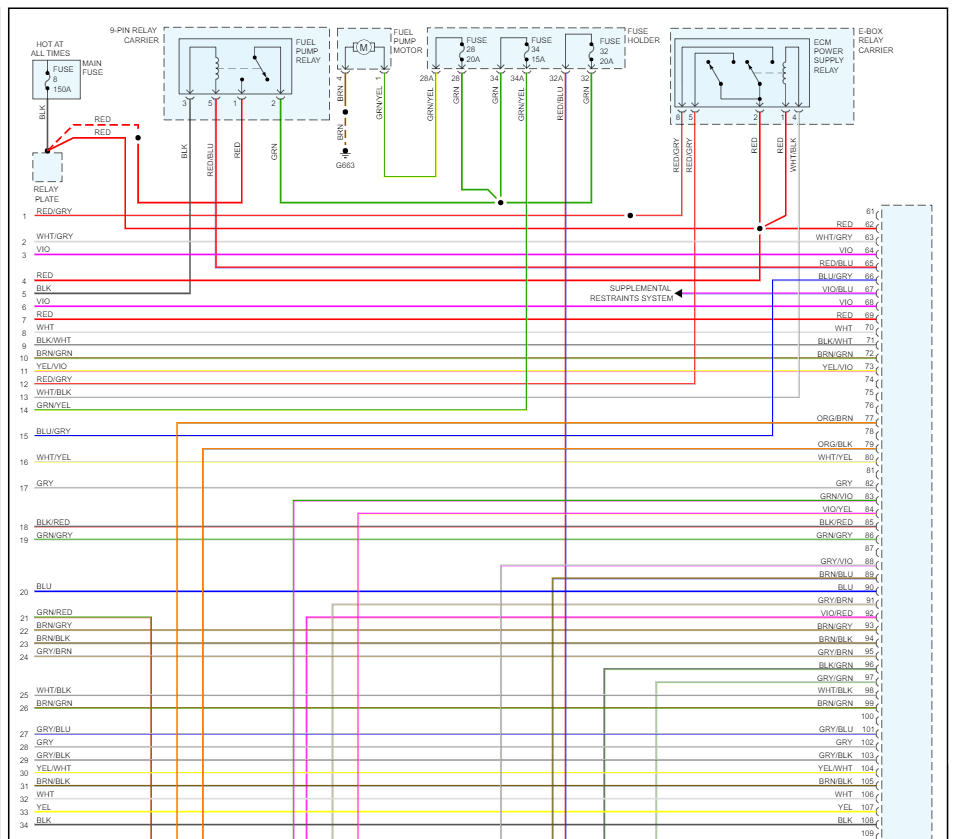

The car had a missing. It changed plugs ignition coils check engine light came on the next day. Started blinking car started running like running bad. Took it straight home. Parked it. It still started up the next day. No start cranks no start. So, I changed the fuel injectors, and I also changed the wiring connectors to the ignition coils. And now I've got to change the wire connector to the camshaft position sensor but I'm not sure. I pulled the pins out of the old one because it was broken without paying attention and now, I don't know how they go back with the aftermarket connector. I need a diagram bad and I'm still showing a code of a p0668 which is the ECM PCM power relay sensor underneath the hood that's located by the seat ECM. But even if I close that manually and keep it closed, the car still won't start crank no start.

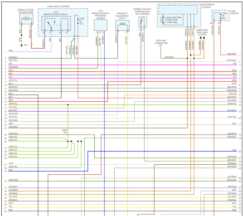

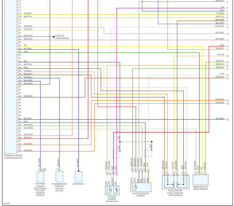

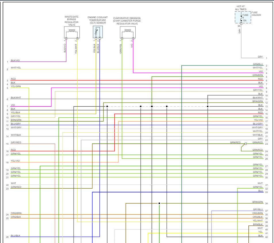

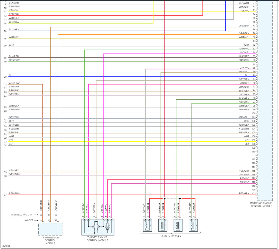

Sure, here is the engine and camshaft position sensor wiring diagrams and a guide to help you test the connections.
This guide may help as well:
https://www.2carpros.com/articles/car-not-running-advanced
Check out the images (below). Please let us know how it goes.
