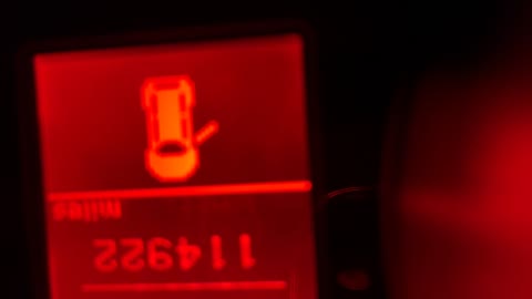

I sprayed starting fluid into the throttle body, but it still wouldn’t start. I have included a video of what it sounds like now.

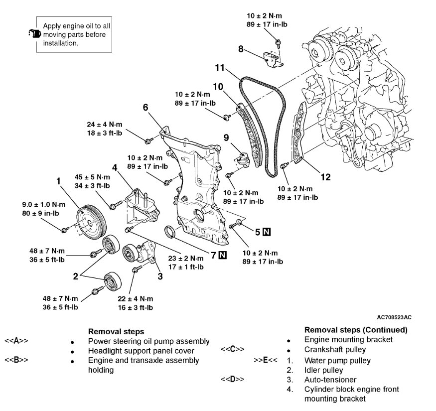

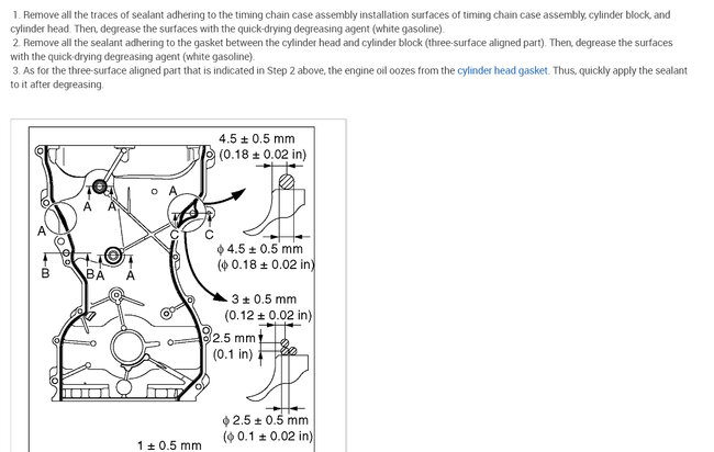

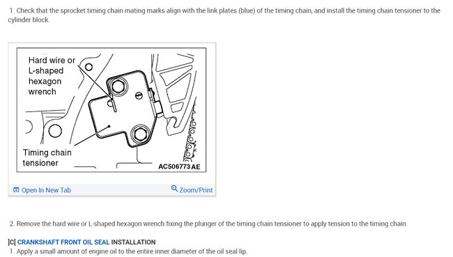

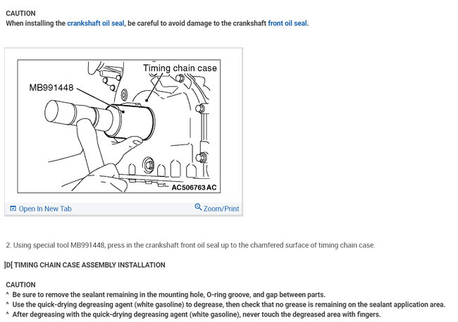

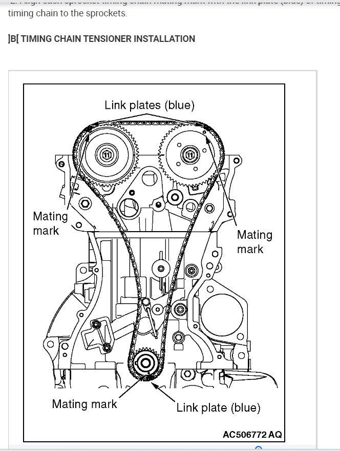

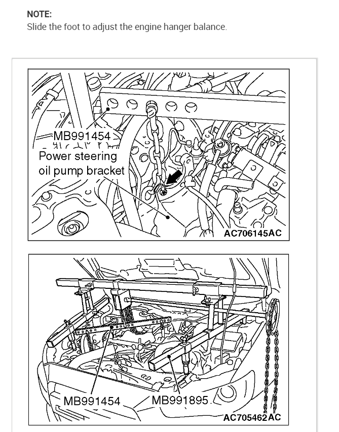

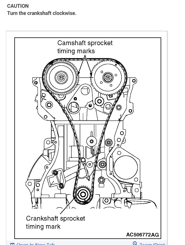

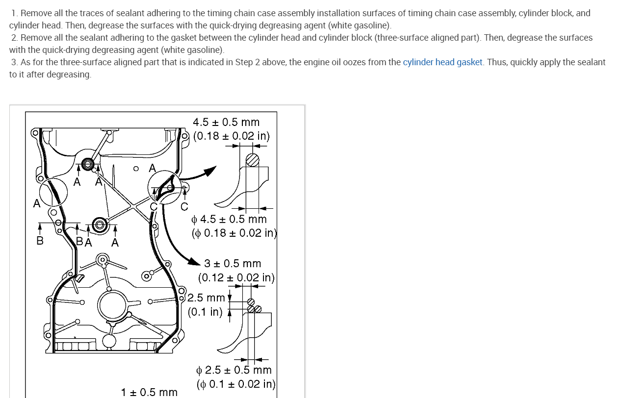

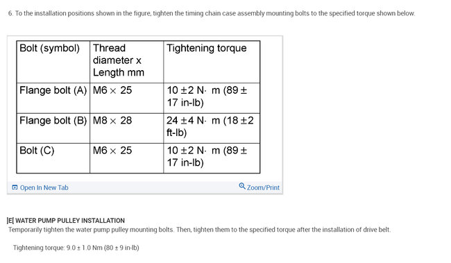

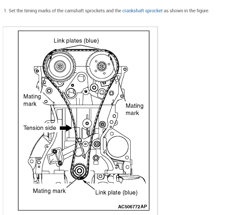

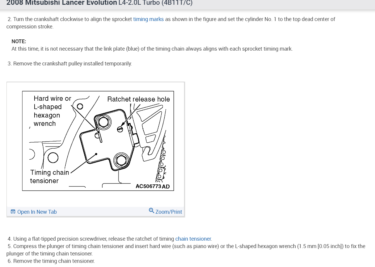

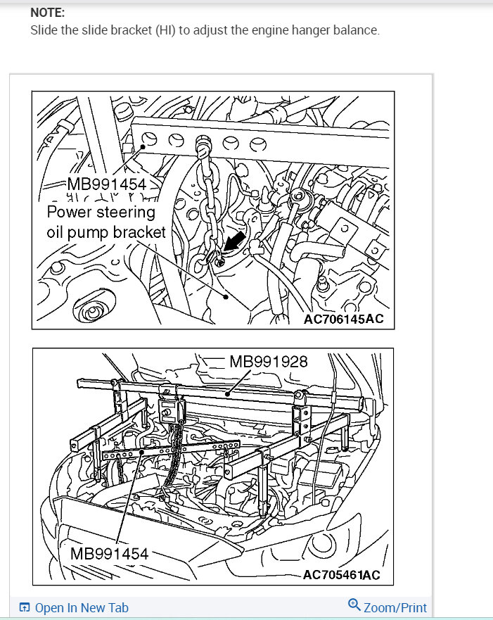

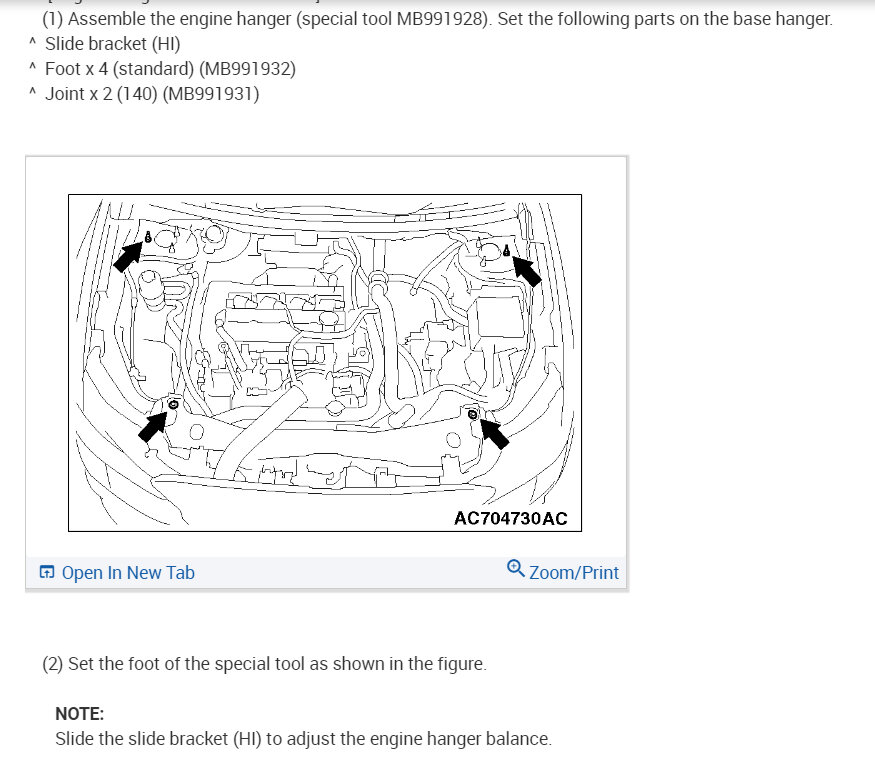

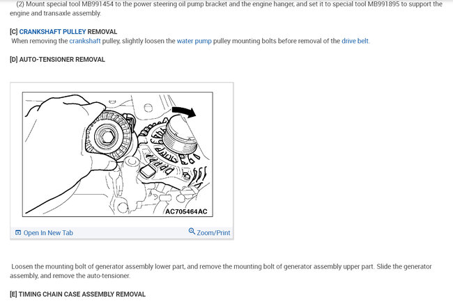

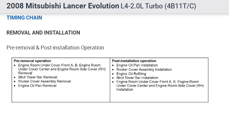

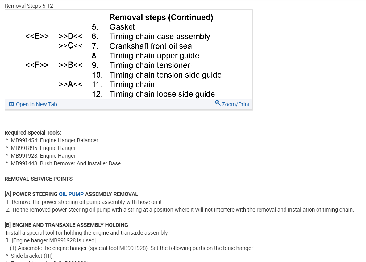

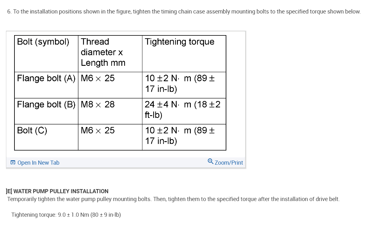

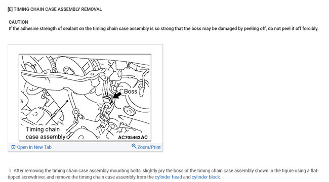

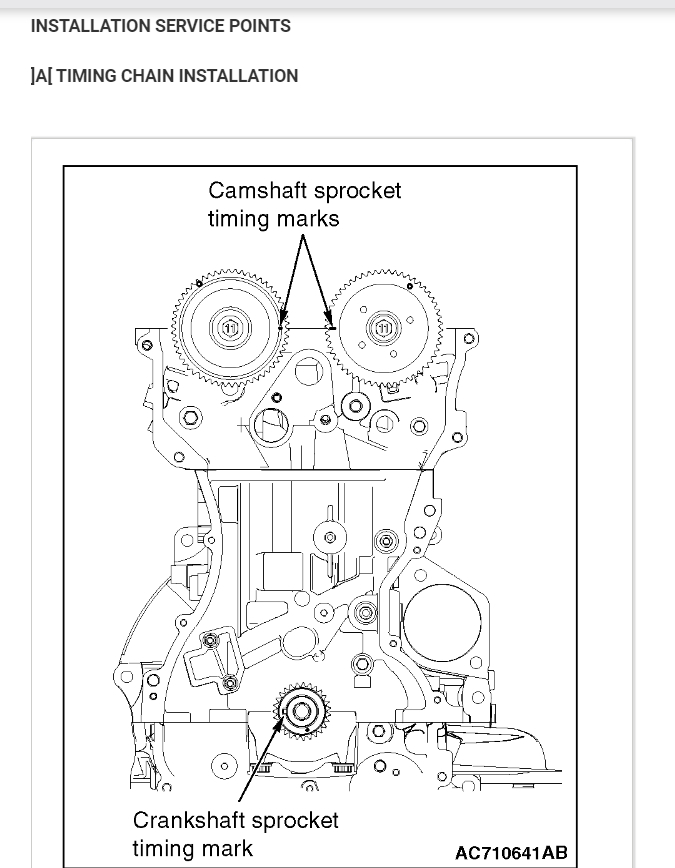

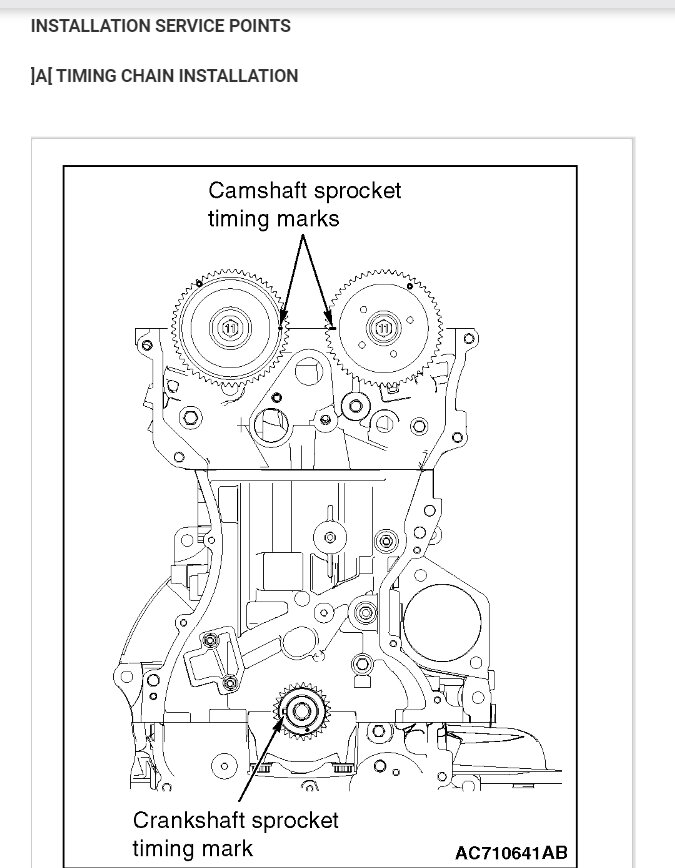

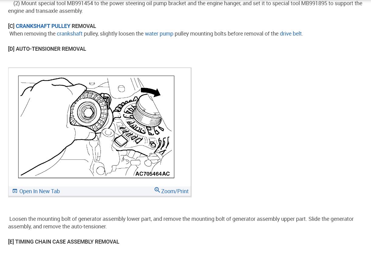

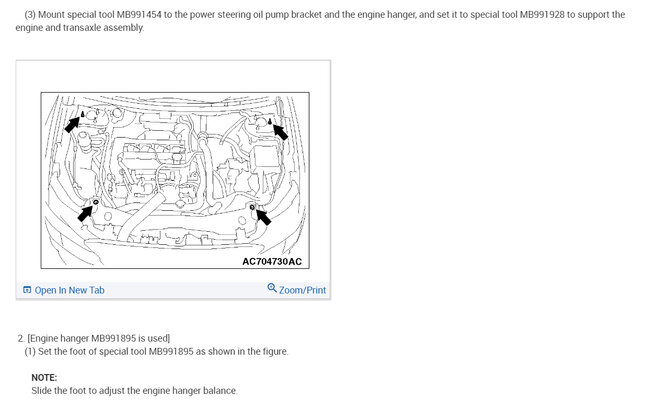

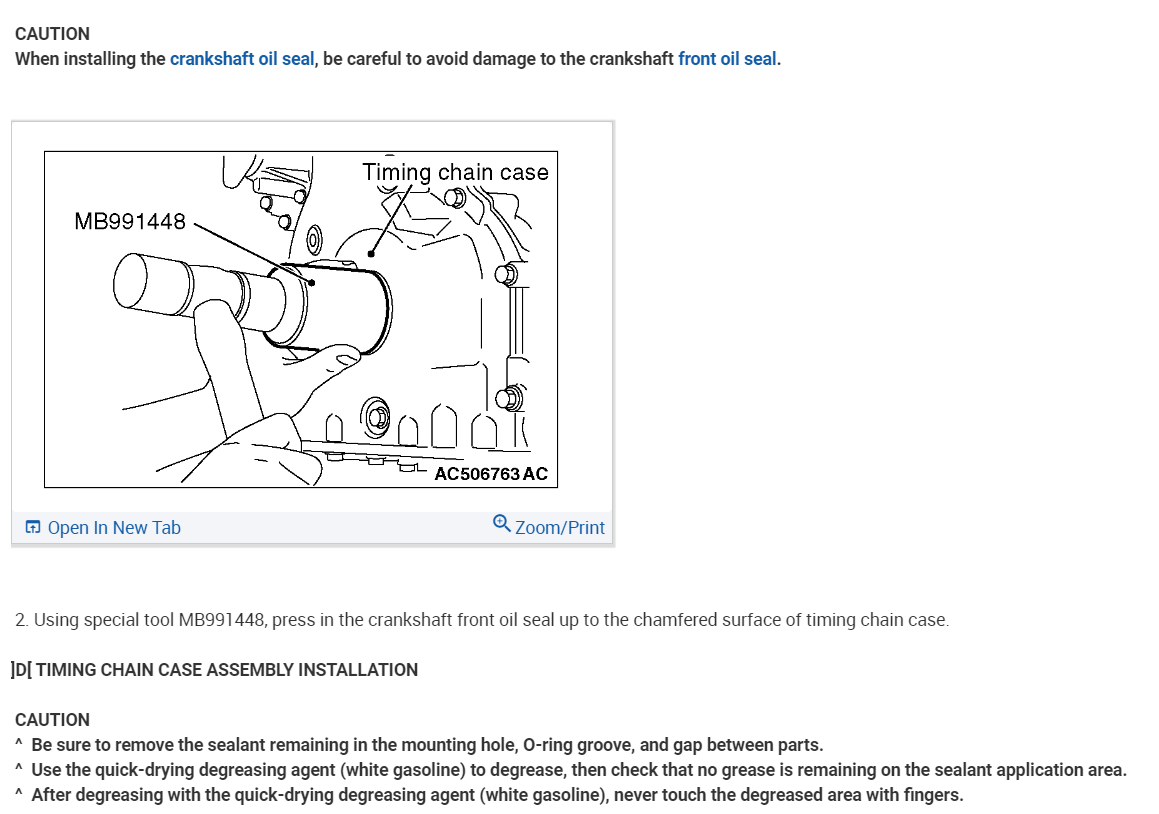

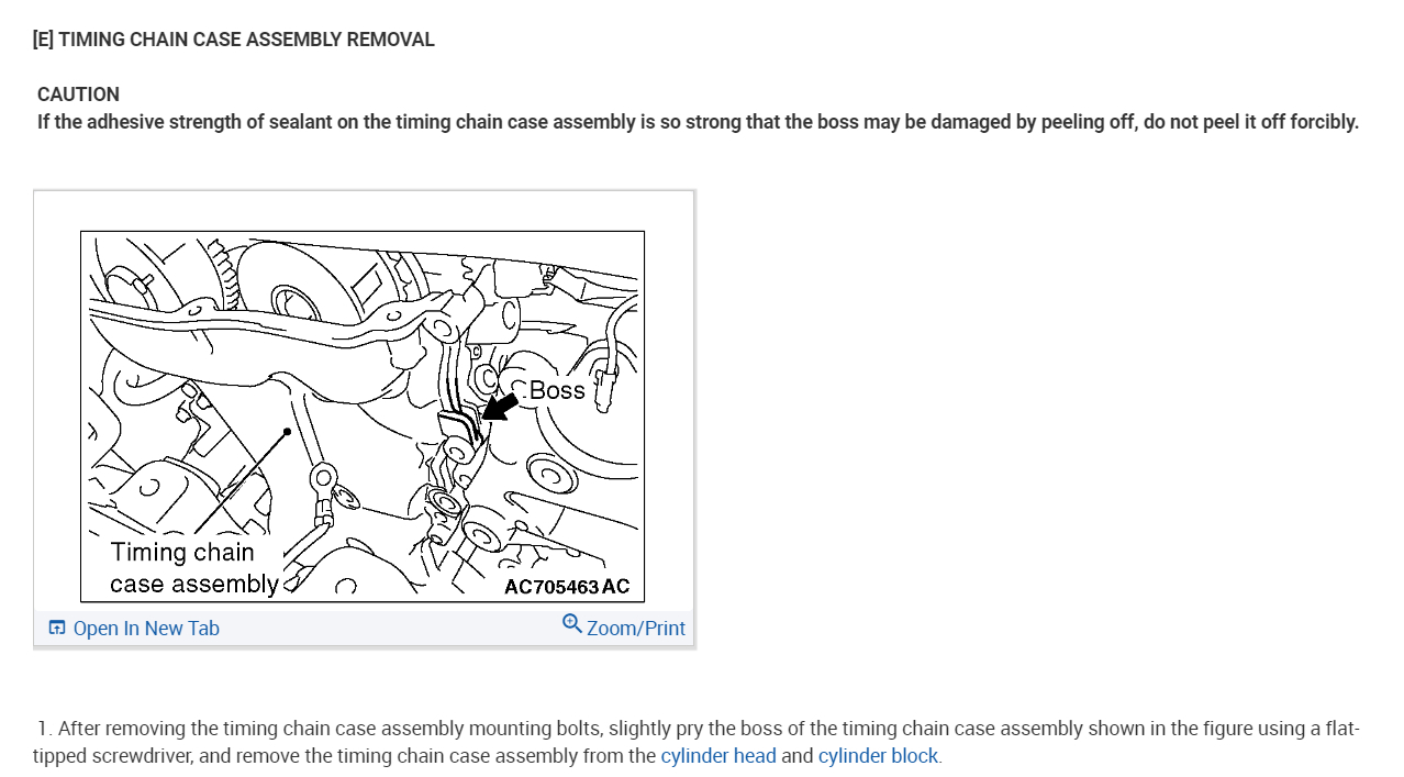

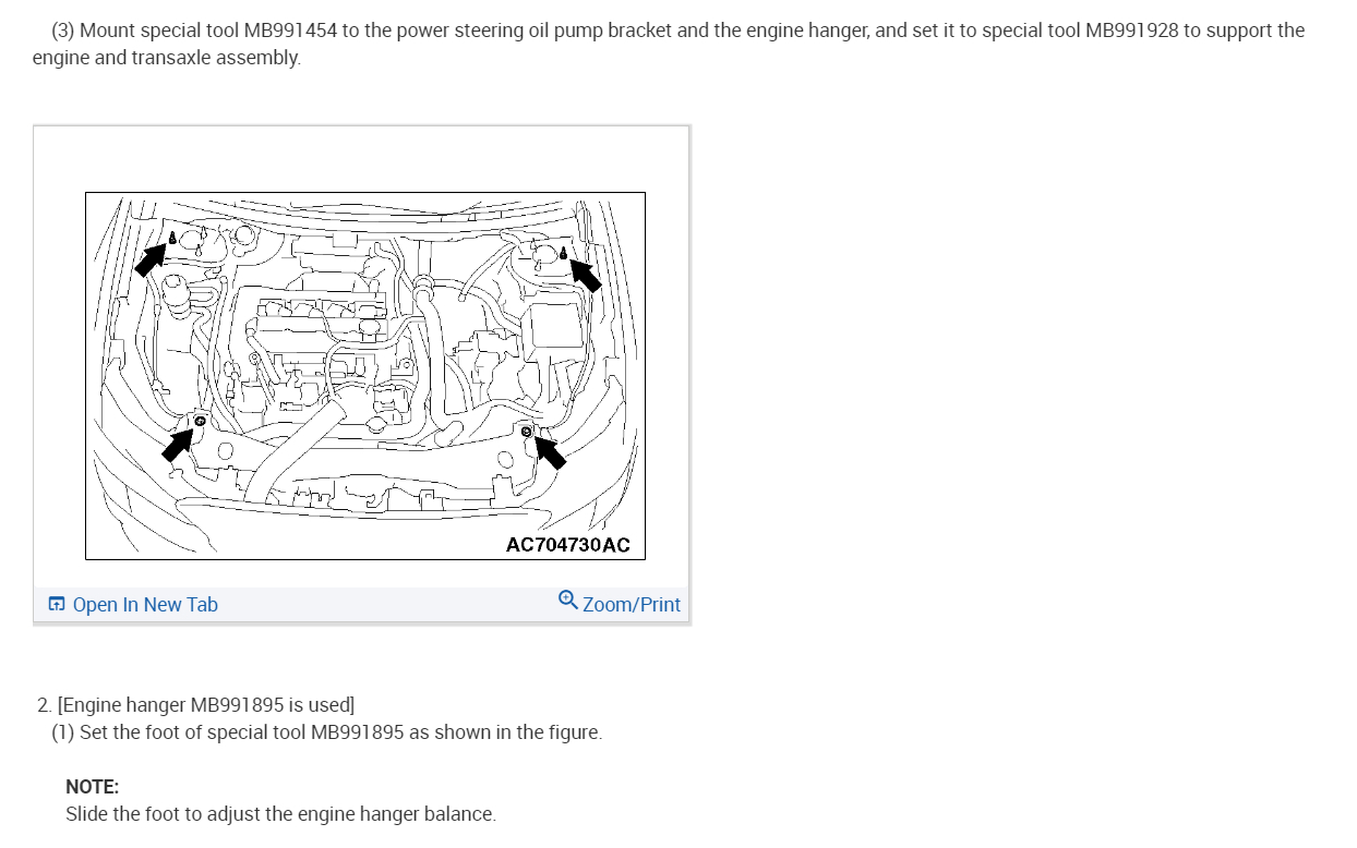

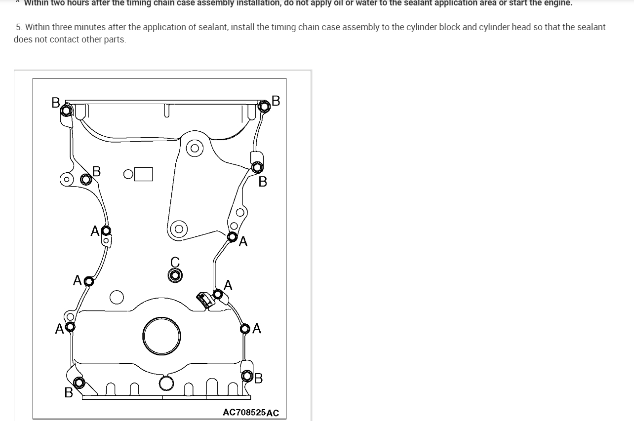

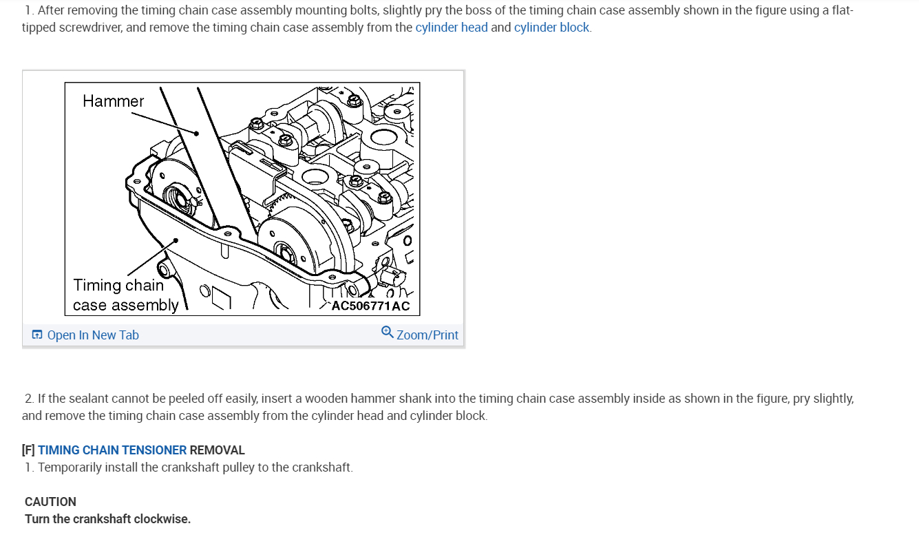

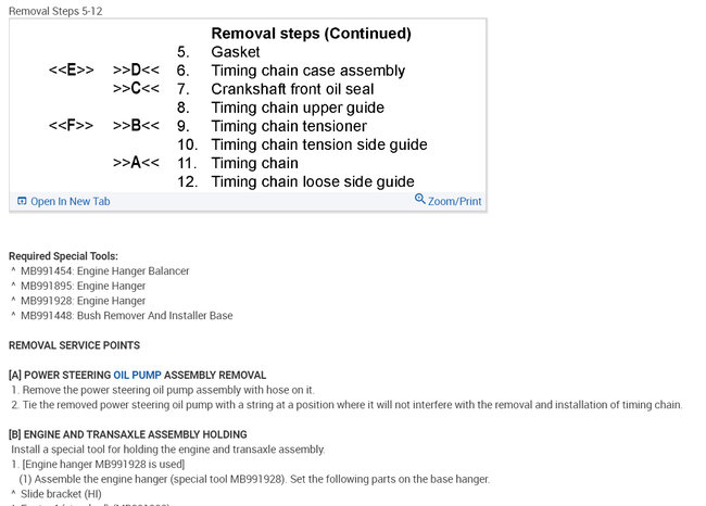

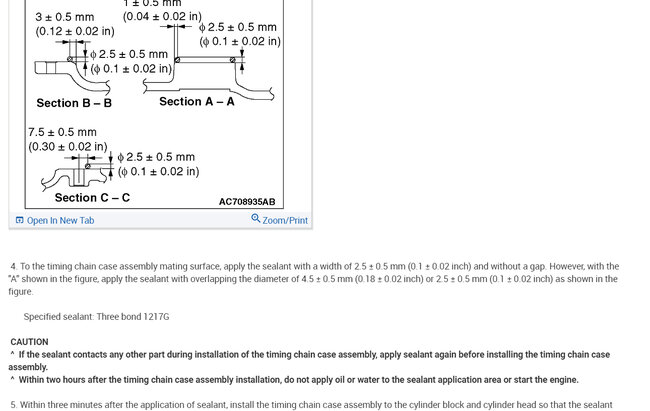

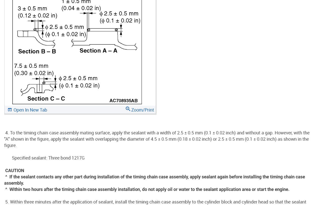

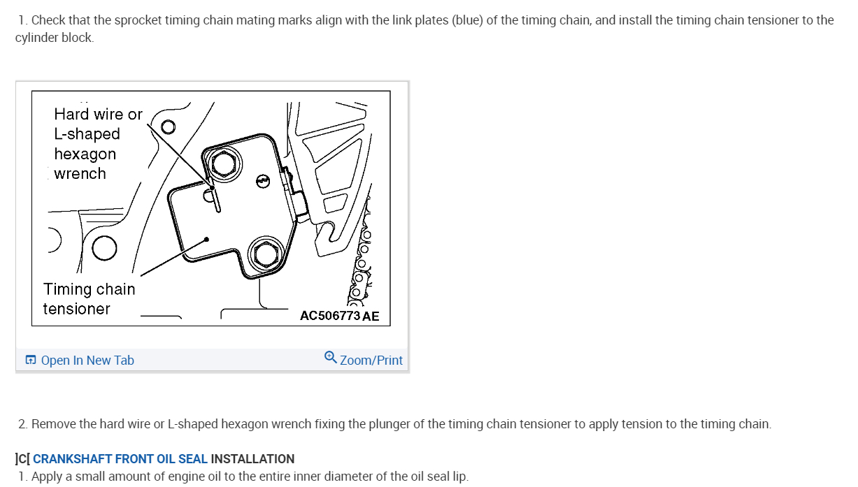

Thanks for the video. Yep, the timing chain has broken. Here is how to replace it to fix the problem. Check out the images (below). Please let us know if you need anything else to get the problem fixed.
