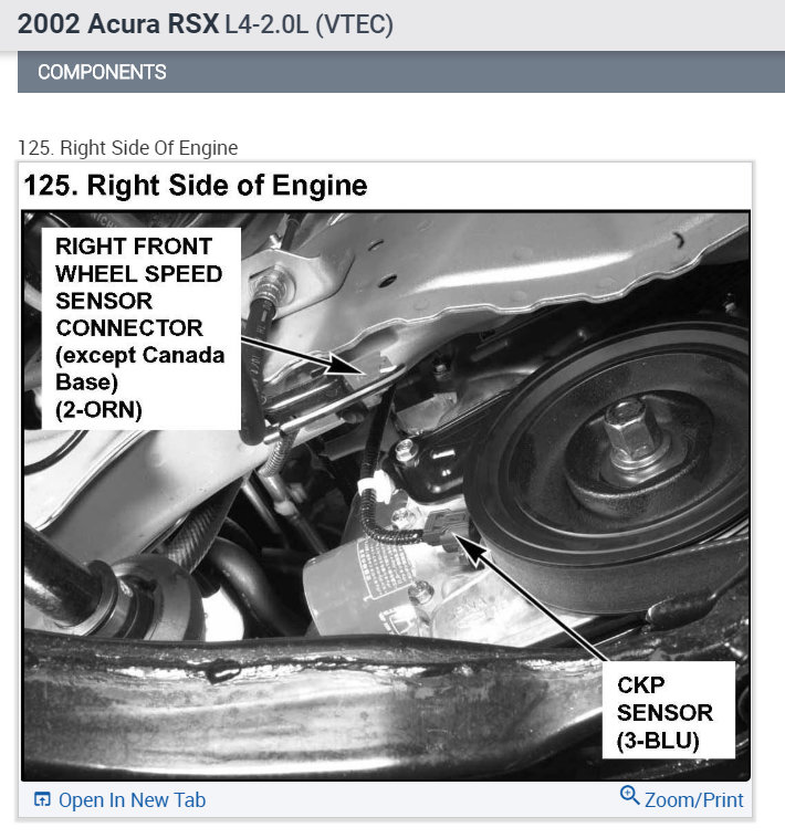

Will it run with starting fluid? Also, can you hear the pump run in the tank key on not cranking the engine over? It could be a crankshaft sensor. When they go bad they don't leave a code. Go over the guide JONNYB1963 suggested to start. Here is the crankshaft sensor location and a guide to help you through the steps:
