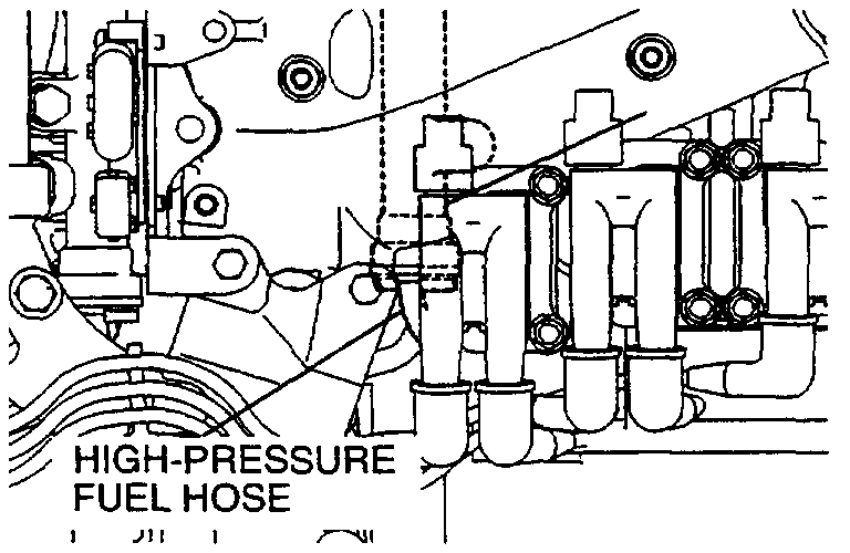

1. Release residual pressure from the fuel line to prevent fuel spray.
WARNING: To prevent a fire, cover the hose connection with shop towels to prevent splash of fuel that could be caused by some residual pressure in the fuel pipe line.
pic 1
2. Disconnect the high-pressure fuel hose at the fuel rail side.

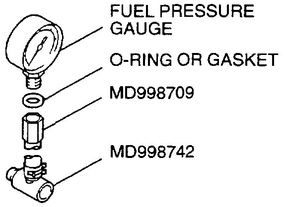

3. Assemble special tool, M0998709 and special tool M0998742
pic 2

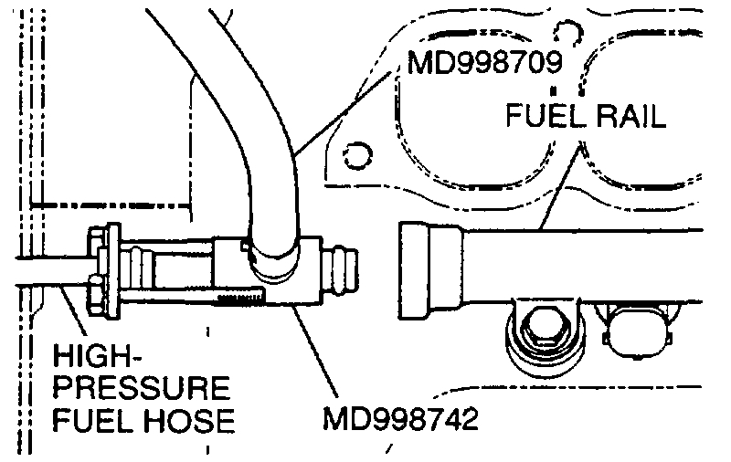

4. Place a suitable O-ring or gasket on the assembled special tools MD998709 and MD998742 and install the fuel pressure gauge.
pic 3

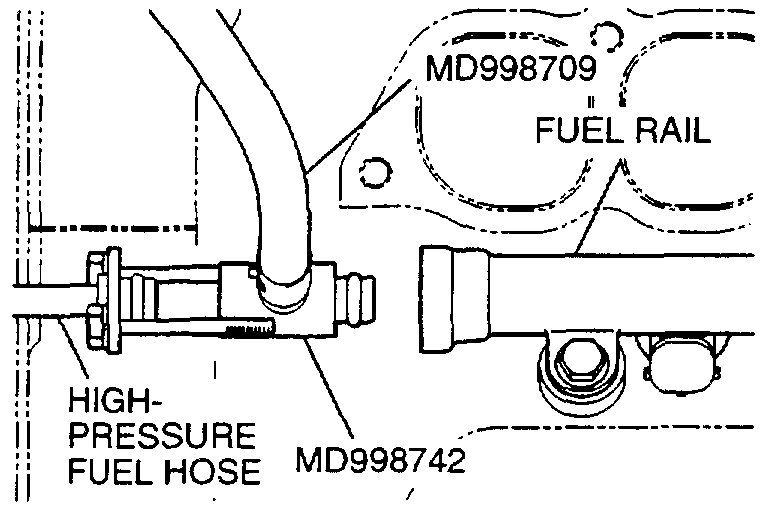

5. Install special tool MD998742/MD995709 (created in steps 3 and 4), between the fuel rail and the high-pressure fuel hose.
pic 4

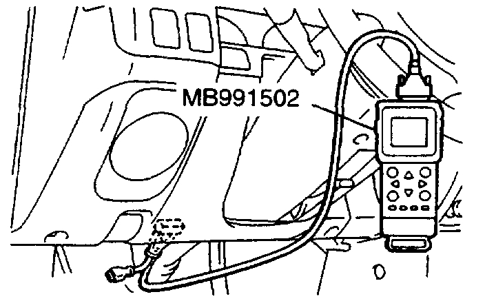

6. Connect scan tool MB991502 to the data link connector.
7. Use the Actuator Test 25 to drive the fuel pump. Check that there is no fuel leaking from any section when the fuel pump is operating.

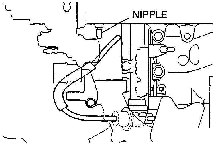

11. Disconnect the vacuum hose (blue stripe) from the air intake fitting and then plug the nipple.
Measure the fuel pressure in this condition.
Standard value: 330 - 350 kPa (47 - 50 psi) at curb idle

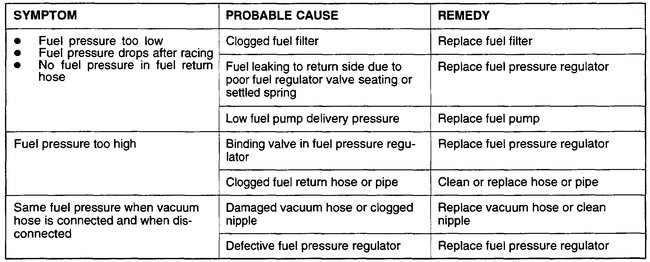

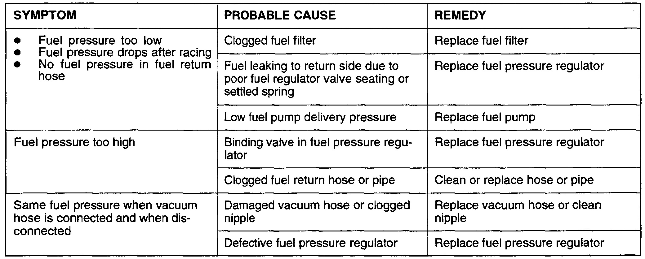

14. If any of fuel pressure measured in steps 10 to 13 is out of specification, troubleshoot and repair according to the table above.
pic 7

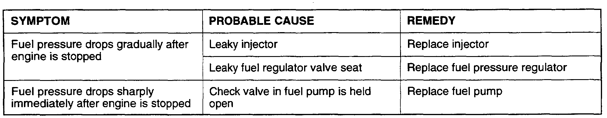

15. Stop the engine and observe fuel pressure gauge reading. Normal if the reading does not drop within two minutes. If it does, observe the rate of drop and troubleshoot and repair according to the table above. Start, then stop the engine.
(1)Squeeze the fuel return line closed to confirm leak-down occurs from defective fuel pressure regulator.
(2)Squeeze the fuel supply line closed to confirm leak-down occurs from defective fuel pump check valve.
(3)If pressure continues to drop with both fuel lines squeezed closed, injector(s) are leaking.
