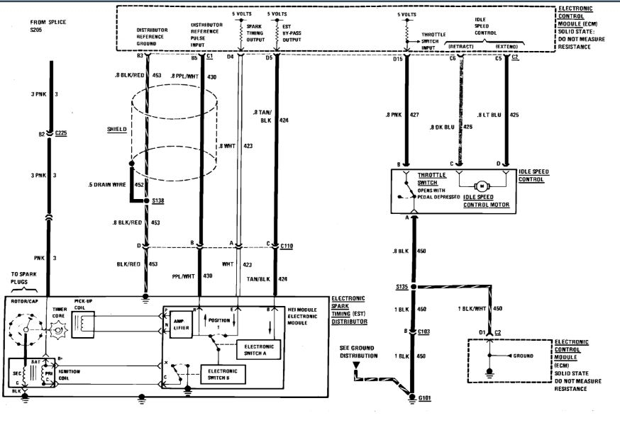

He is going to have to start from scratch.
Test the pick up coil for proper resistance, should be around 1200 ohms. Take out the module and have a parts store test it. That is a free service.
Verify battery voltage to the distributor as well.

No, it either has a distributor or crank sensor, not both.

Yes, if it was not allowing power to the distributor.
