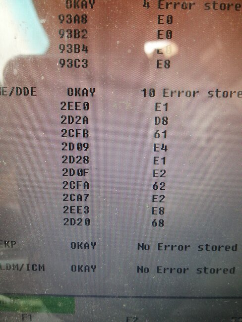

Please, I need help guys. Ps the code for electric water pump was because I disconnected it before scanning for error code via INPA.

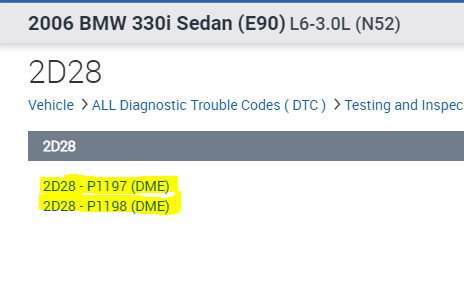

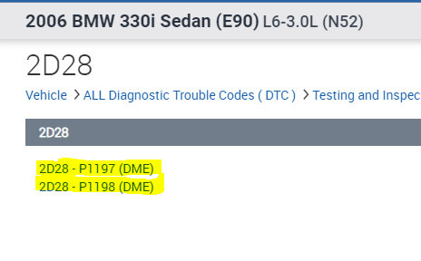

Wow, that's a list. By chance, do you have the P codes? My manual provides multiple P codes for the manufacturer's codes you provided. Each one takes me in a different direction. See pic 1

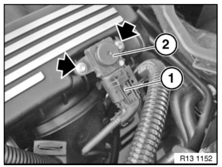

Also, have you checked the differential pressure sensor (pic 2)?
See pics below.
