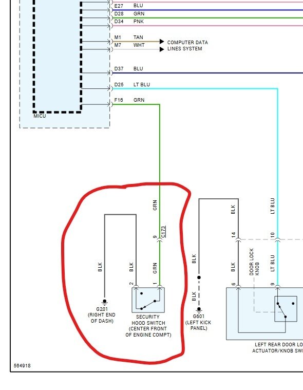

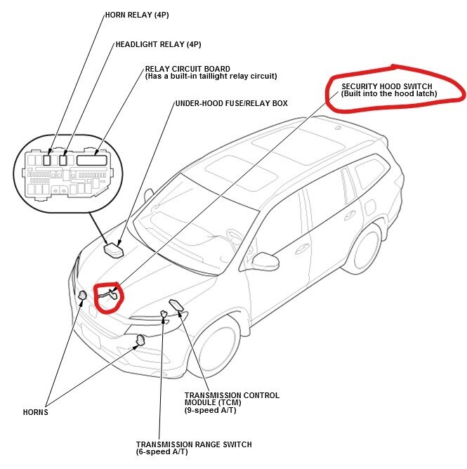

The description sounds like one of the door latches isn't locking fully and as the conditions around it change the switch in it triggers the system and wakes up the vehicle. A common one for this is the hood latch switch located with the hood latch in the front center. An easy way to find out the issue is to use a good scan tool and access the "Tripped Sensor Recall" and it will show you what latch is tripping the alarm. So, it would tell you something like Hood Latch or Right Front Door. Then you can easily repair the problem.

I would start with that as it sounds like the alarm trigger is at least part of the problem.
