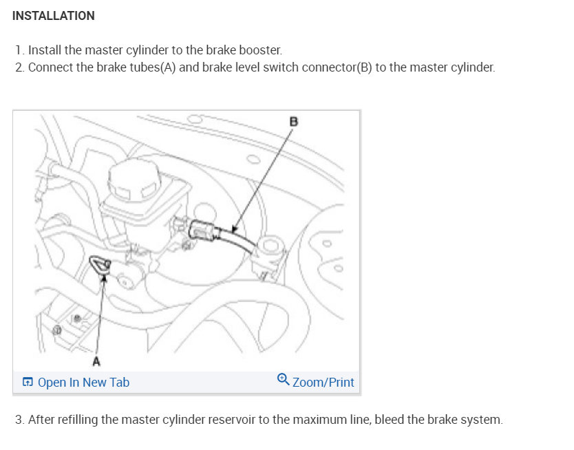

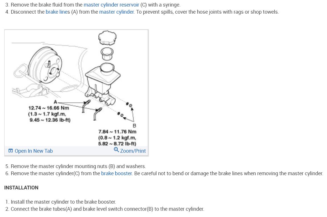

This happens when the brake booster push rod is adjusted out too far. Try this: when the brakes are locked up try to loosen the brake master cylinder mounting nuts two turns to see if the car rolls again. If so, remove the brake master and adjust the rod inwards, if the problem persists, replace the brake master, this guide can show you how.
https://www.2carpros.com/articles/how-to-replace-a-brake-master-cylinder
This video will show you how to bleed the brake master:
https://youtu.be/WDxvEQrMkBg
