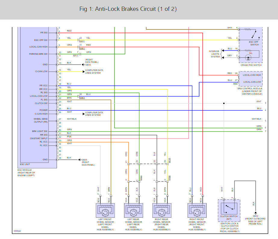

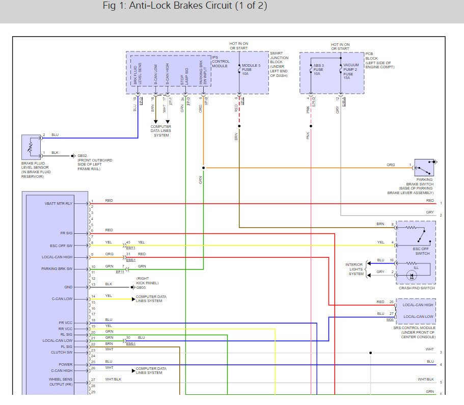

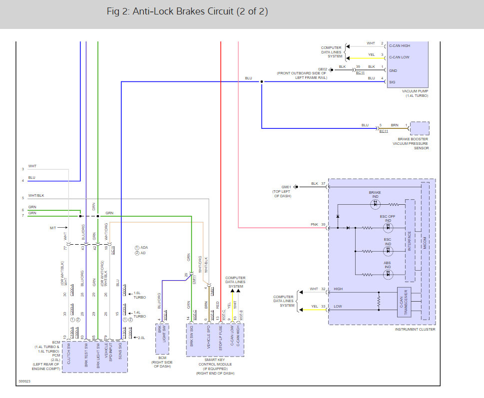

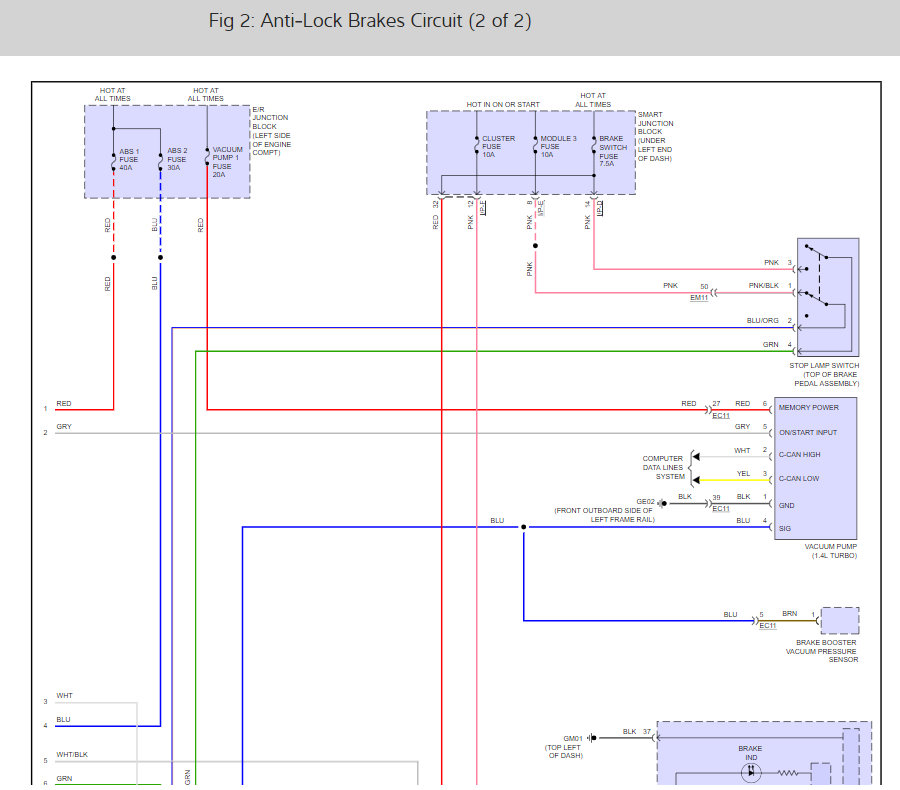

It sounds like you have an IPS module that is going out. To be sure lets run the codes to see what codes up. Here is a video that will walk you through the steps along with the ABS wiring diagrams so you can see how the system works:
https://youtu.be/rTtAnsOlZU4
