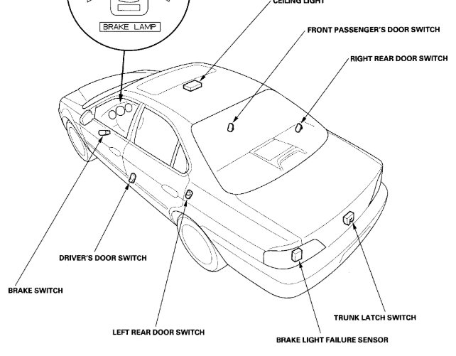

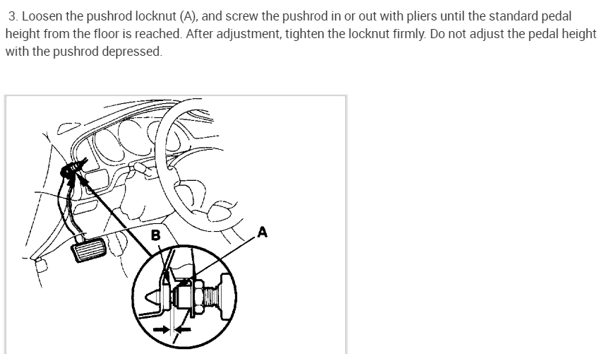

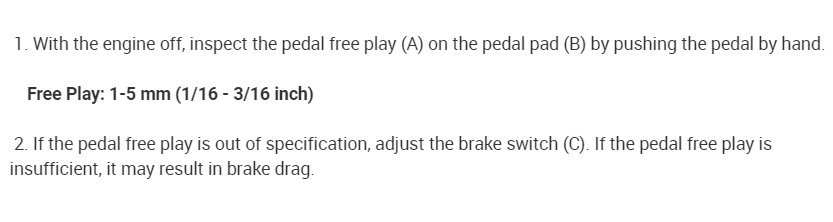

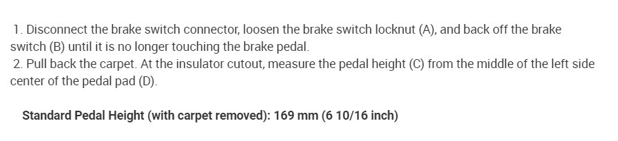

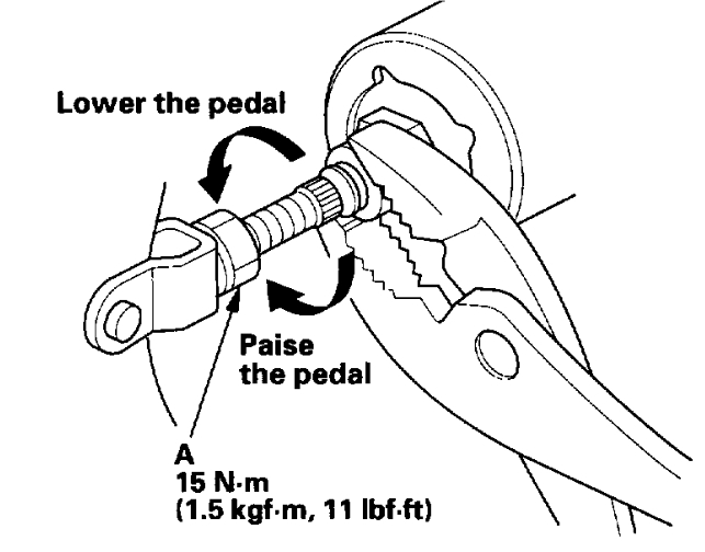

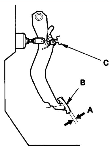

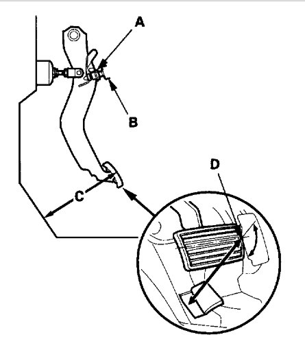

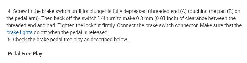

It sounds like you are having an issue with the brake light switch.It's mounted on the brake pedal.It might be shorted and not allowing brake lights to turn off. I've attached pictures below of its location and how to replace.Hope this helps and thanks for using 2CarPros.
