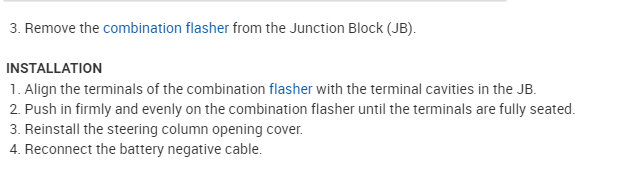

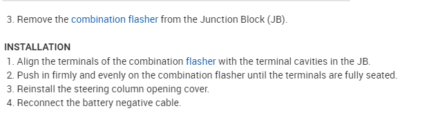

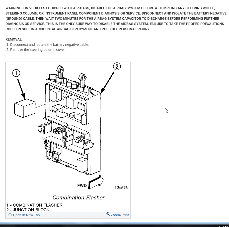

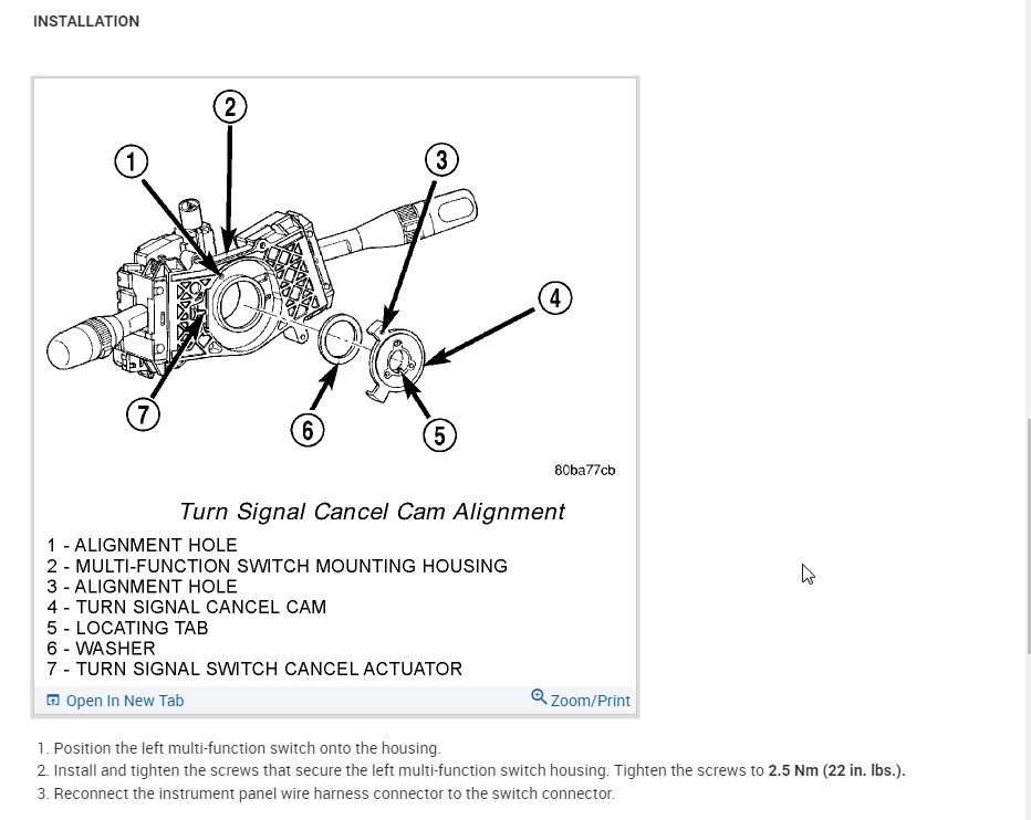

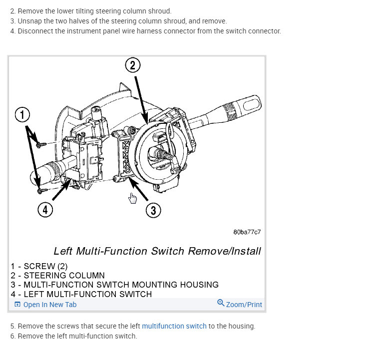

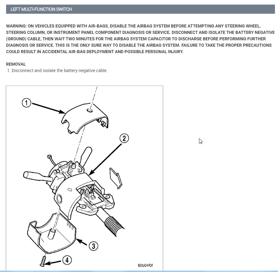

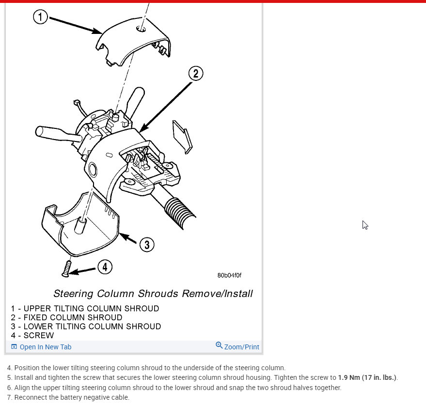

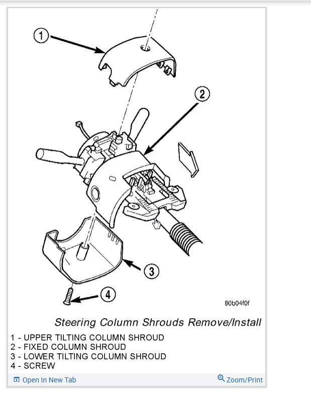

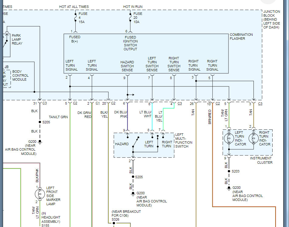

This sounds like it is the switch that is failing like you said. Here is the procedure for removing it. If it were me, I would replace this and then go from there but I highly anticipate this will fix it.
The other possible cause is the combination flasher has failed but this is not likely to cause just one thing to stop working.
Let me know if you have questions. Thanks
