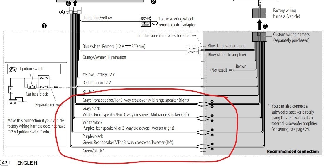

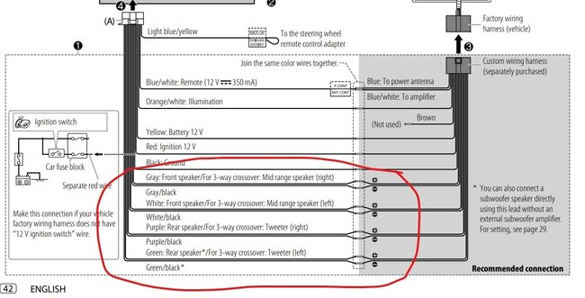

Okay, for that unit if you are using the amp inside the unit, you connect up the 4 other speakers to the circled wires in the harness. So gray and gray black for right front, white and white, black for left front, purple and purple, black for right rear and green and green, black for left rear. (the ones with the black stripe go to the negative terminal on the speakers) Then the subwoofer amp gets fed from the SW RCA jacks. Then you have to use the 2-way crossover setting.
If you are using a different amp for the 4 speakers, then you use the RCA output jacks to connect the LF RF RR LR outputs to the correct line inputs on that amp and still set the head unit for 2-way crossover.
If you are not using the internal amp in the head unit, be sure to isolate the speaker wires and tape them up so they cannot short out on anything.
