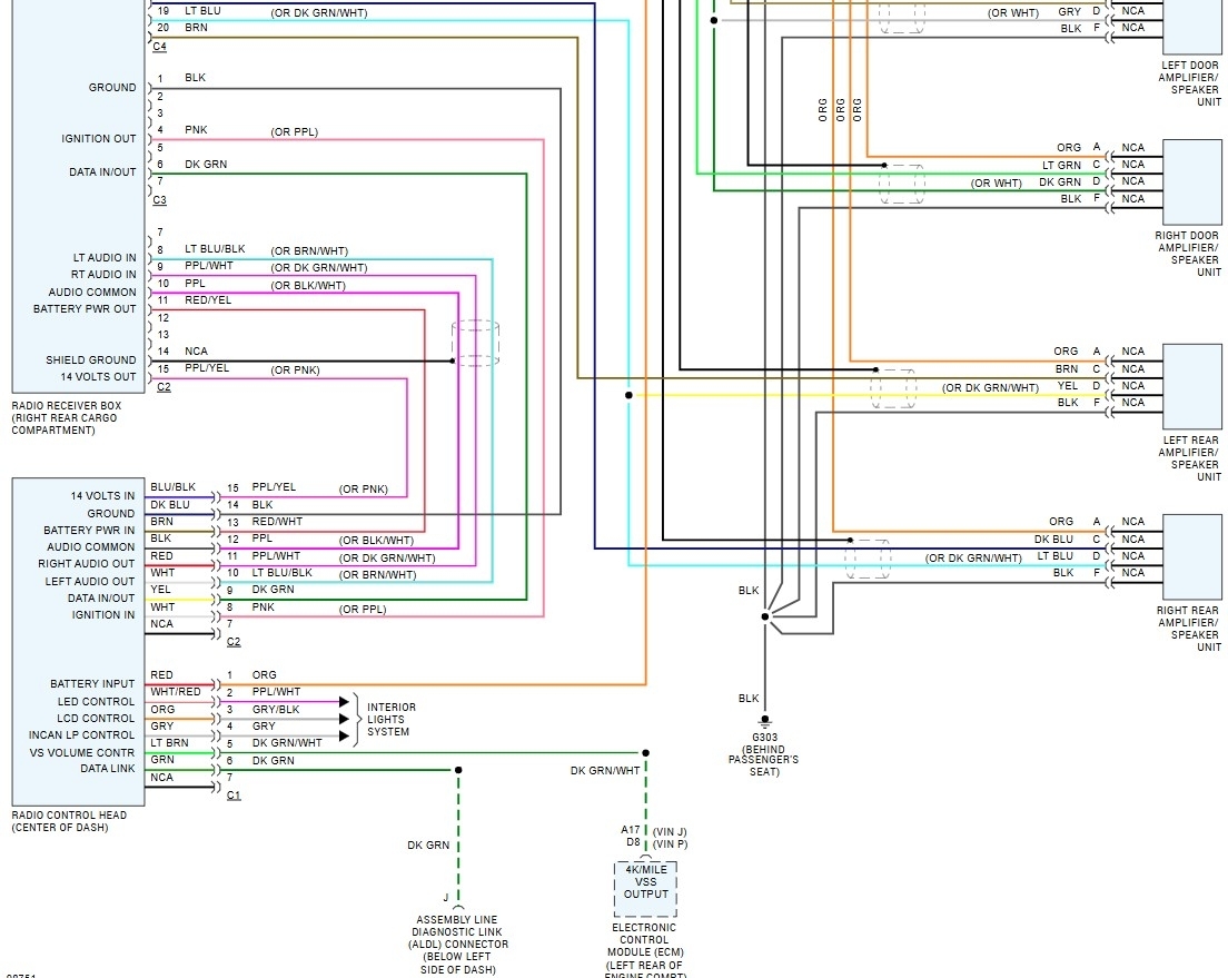

Can I get a wiring diagram and amplifier location for the BOSE audio system for this car? Thanks

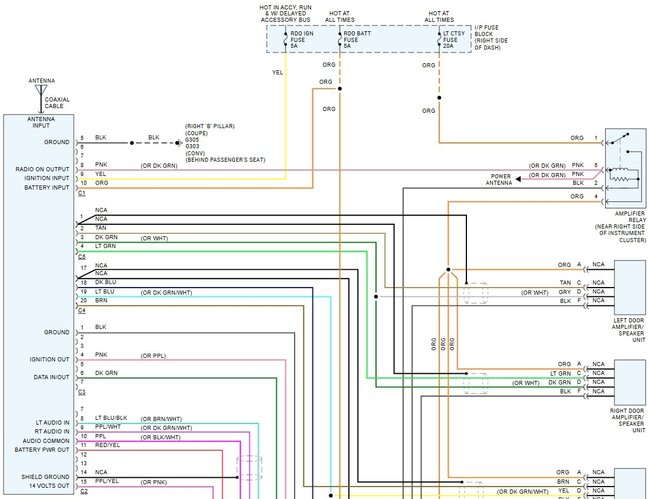

There is no single amplifier in that system. Each speaker has it built into the speaker "module". Also, there is no radio in the dash. The display is just that a display. The actual radio is in the right rear of the trunk. To get anything to fit up front is a pain because you need to cut out part of the dash support to get room behind it.

Yeah, thanks. I got ahold of a BOSE expert with Corvettes. I got the METRA harness so I should be good. Thanks for the diagram, that's good for reference. Any problems I'll hit you up. Thanks Steve!
