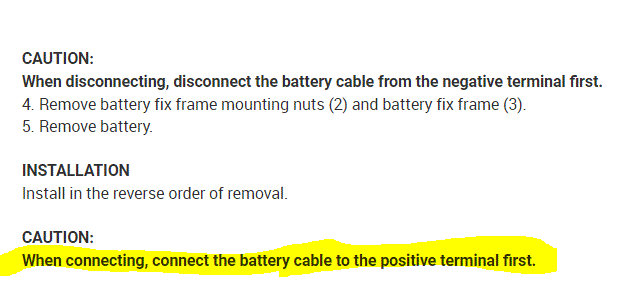

I need you to try something. Disconnect the battery and then connect the positive terminal first and then the ground. The manual indicates that is the procedure. See if that makes a difference. Also, see pic below.
Let me know if that takes care of it.
See pic.

That's how I always disconnect then reconnect switches is why i'm puzzled by the alarm issue. Because I changed my fob battery tested and fully charged the car battery all after it was not doing it when I last disconnected it to try and fix another issue. i'm trying to fix with the assistance of you guys. then when I went out the next day to work on my truck and plugged it up to open my trunk that only opens by a push button and it started blasting off. so I have been trying anything I'm told since there's no fuse for the alarm ether.
