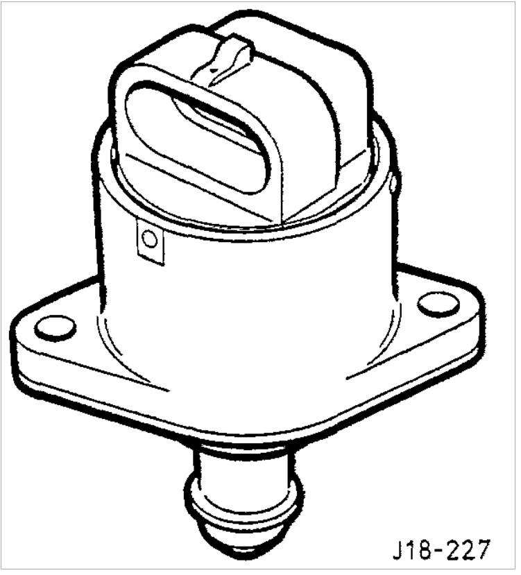

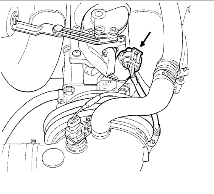

I don't know why He would say that becasue there is an IAC valve in your car. Here is its location (below). Also I noticed a cruise control servo connected to the throttle linkage. I would temporarily disconnect that as well
Please let us know what you find. I'm interested to see what it is.

Just as a quick update, Ken, I went over to the dealership and spoke with my "regular" service adviser. We took a look at the car, and you are absolutely right . . . it does have an IAC valve. So now their mechanic has to check it to see if that is the problem and if that resolves it. Thank you, and I'll write once I hear anything.
