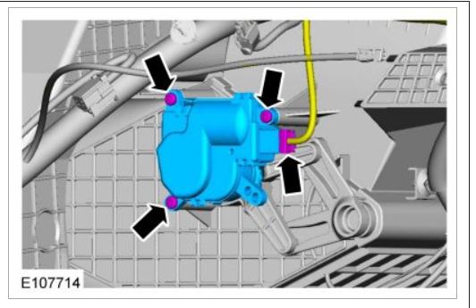

I have a question, do you hear the radiator cooling fans working? If so I would think you have a weak temperature blend door actuator that needs replacement. Here is a guide to show you what you are in for when doing the job:
Here is the location in your car.
Check out the diagrams (below).

The blend door actuator seems like a good start, I would try replacing it. at the same time check the blend door in the plenum to make sure it seals.

Thank you sir. This time i will show your reply to the technician. May be he will get some clue. Thanks for help. I think you are talking about fresh and recirculated air opening. I feel when car moves it remains slight open which makes vent air warmer
