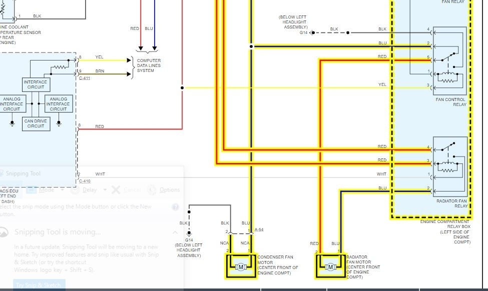

Are the cooling fans running with the A/C on?
If they are not working, the air will not be cold especially at idle. When you drive, you are forcing air through the radiator.
May 1, 2020 at 11:59 AM
PETROYADA
  • 66 POSTS
Yes, the cooling fans are running with the A/C on.
