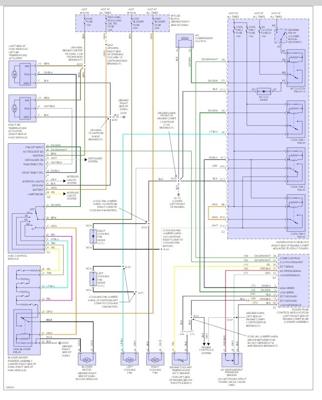

The problem is the speed control itself, when they short out the blower motor stays on high. here is a diagram.
Here is a diagram with the locations of each

He said he does not have auto temp control. There shouldn't be a speed controller, just a resister.

The resister is likely the problem with the blower as the relay is incorporated into it. As for the battery, yes, running it that low can ruin it. Try giving it a long slow charge. Do not use jumper cables as that can ruin your alternator.
