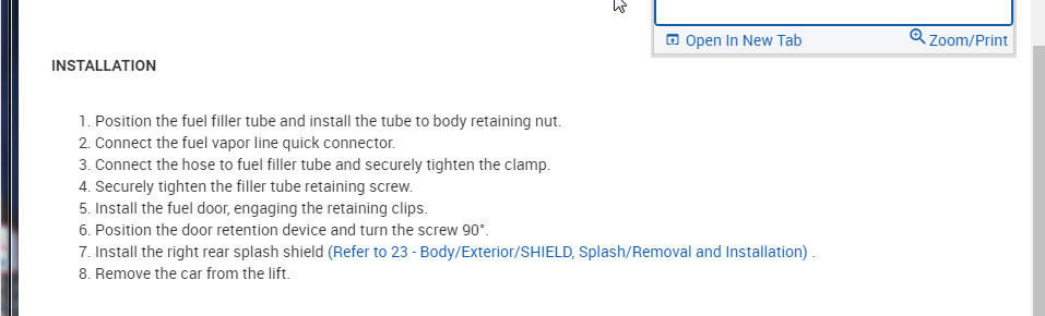

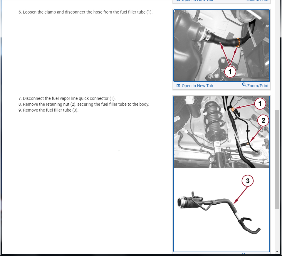

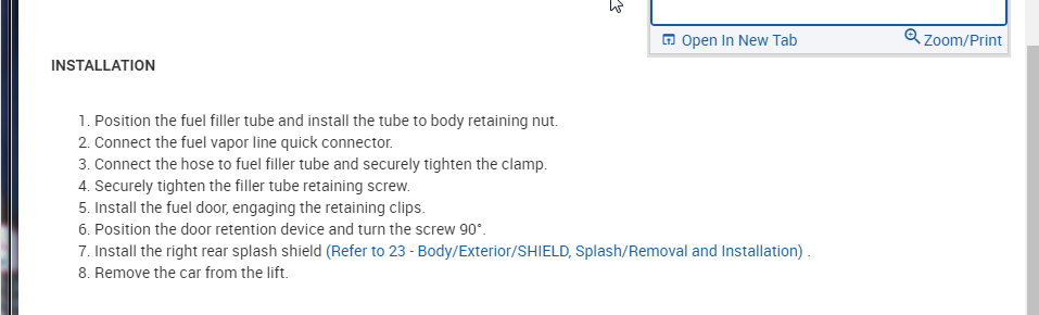

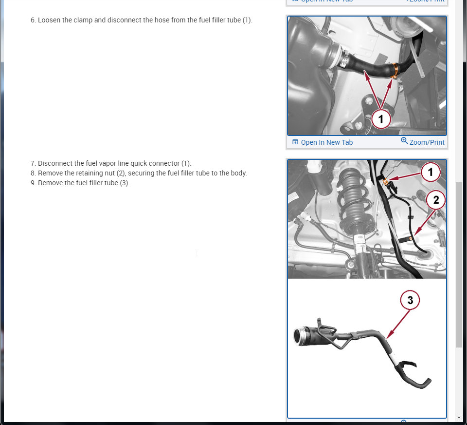

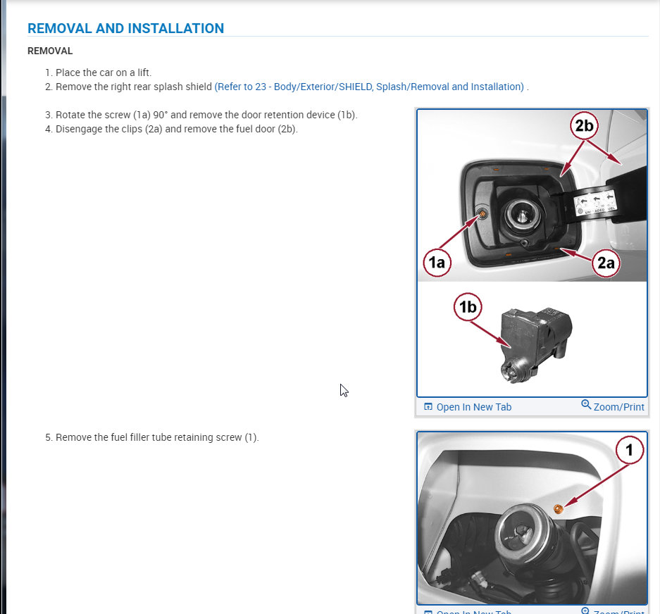

This is fixable but the whole assembly needs to be replaced. I attached the process for your review. Let me know if you have questions. Check out the diagrams (Below). Please let us know if you need anything else to get the problem fixed. Thanks
