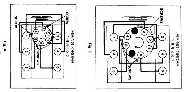

Wires missing and need to know what goes where on the cap.
Nov 28, 2024 at 3:26 PM
These are the two possible wire layouts depending on which version of the HEI system you have. The firing order is the same on both 1-6-5-4-3-2. Normally the wire tower at the rear is 6. In most wire sets 2 is the shortest wire then 6 then 5 with 3,1,4 being the rest in wire length.
