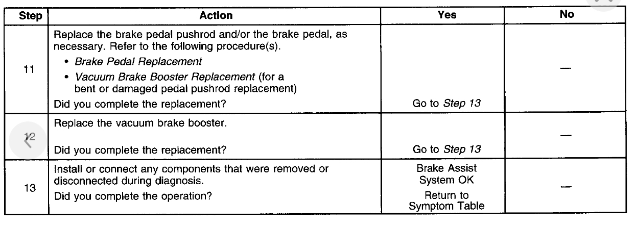

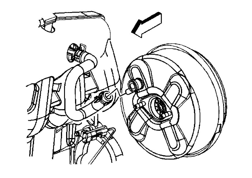

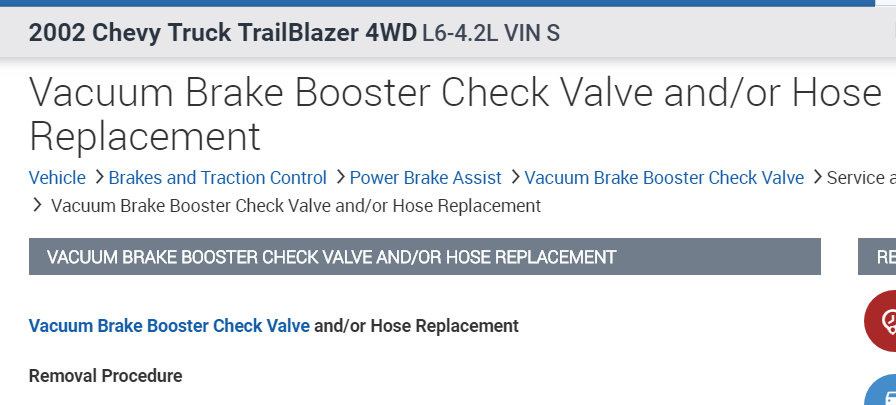

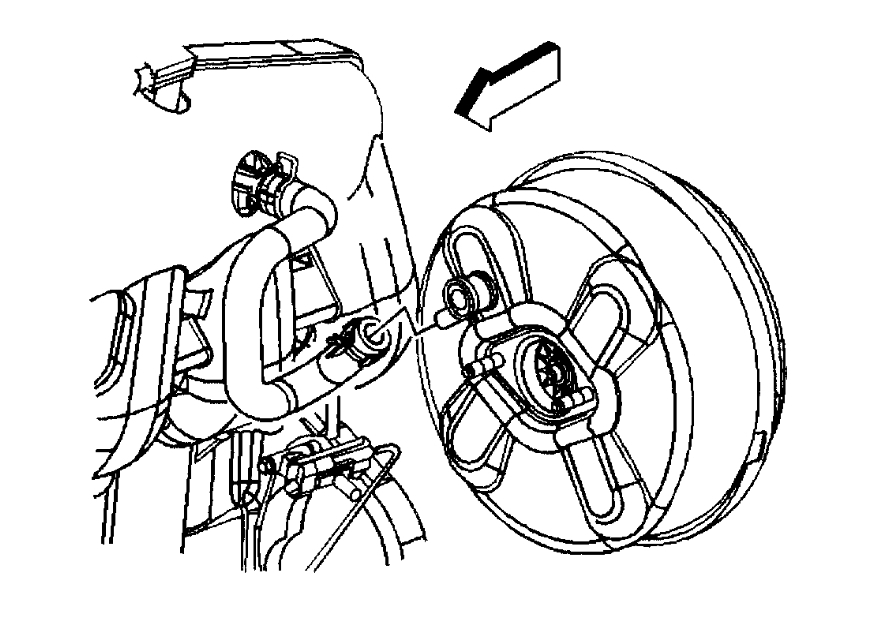

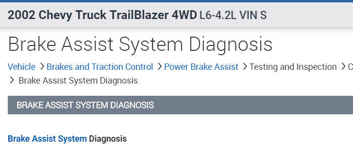

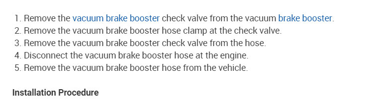

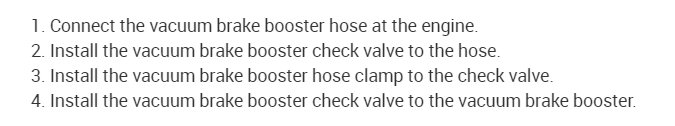

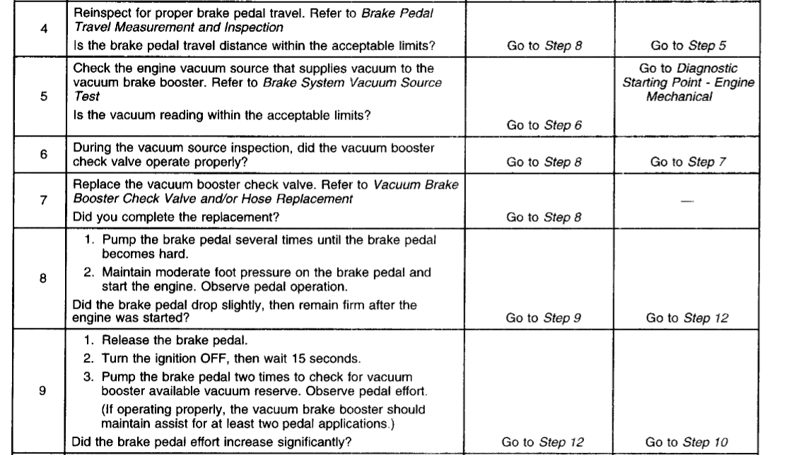

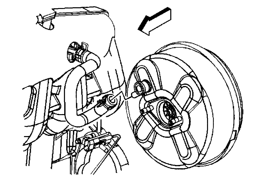

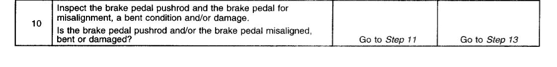

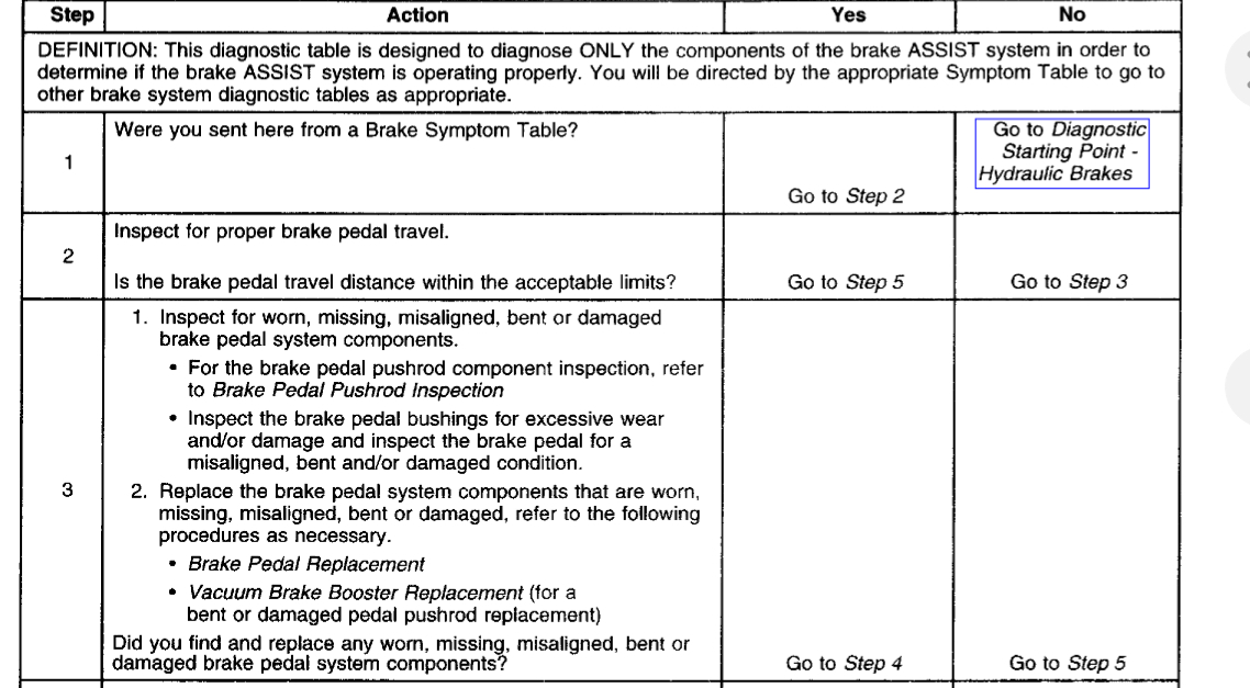

This could be a problem with the vacuum hose going to your brake booster or the brake booster check valve. In the diagrams down below I have included a factory diagnostic troubleshooting flowchart for your vehicle's brake assist system as well as instructions for the removal and installation of the vacuum brake boost check valve and hose. Please go through these guides and get back to us with what you are able to find out.
Thanks,
Alex
