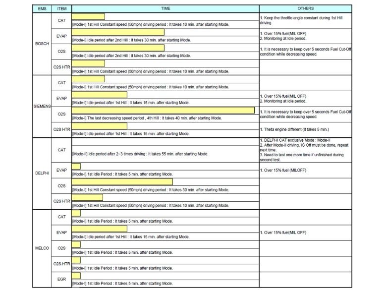

I disconnected my battery when I was working on my car. When I went to get my car smogged, the smog man said my computer has not reset. He said drive it for about 250 miles and come back. I did and still not ready. He said look up drive cycles. Are their any tricks, or how many miles do I really have to drive?

The computer is reset. It is the monitors that are incomplete. The ECM will run the tests for the monitors and when they pass the test it will go to complete.
Drive cycle attached.
