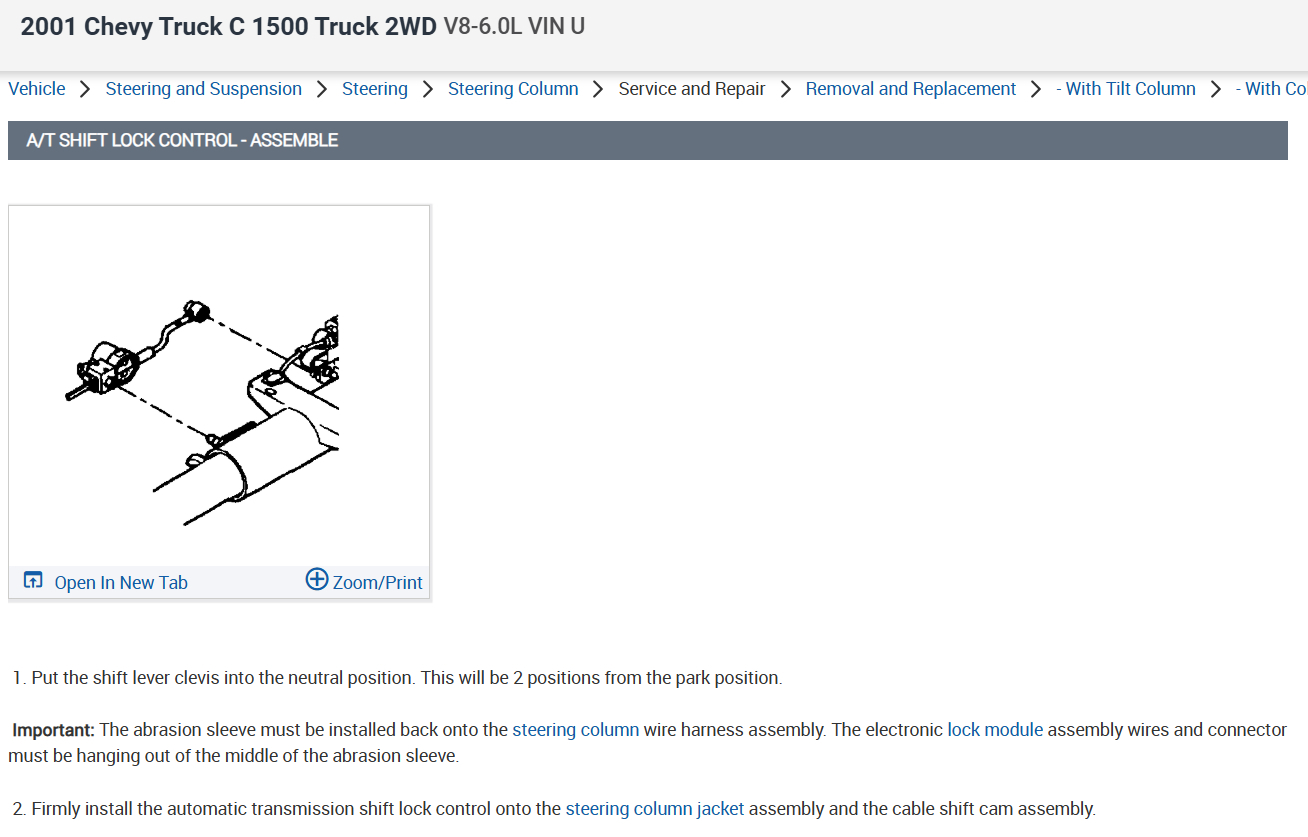

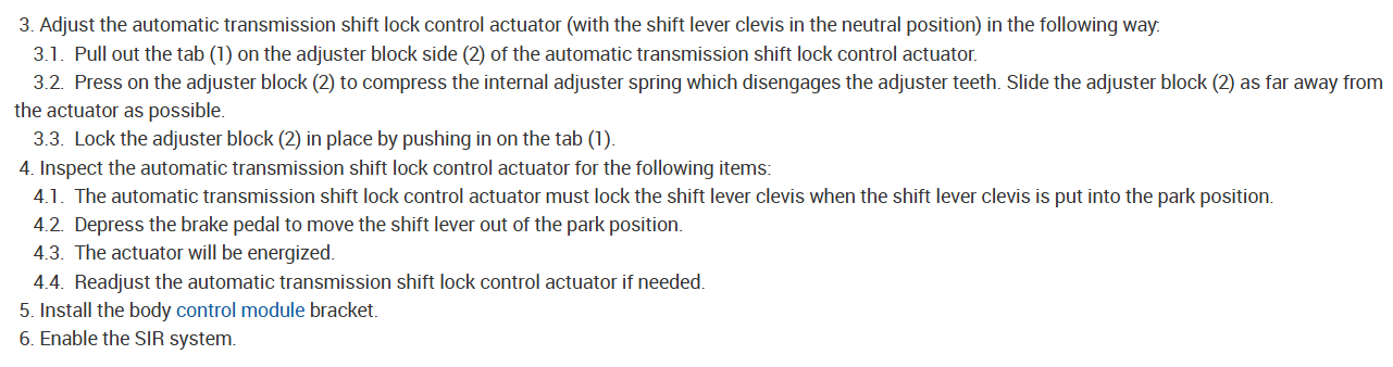

I have been working on my truck today. When I had my old shift lock solenoid and took the plug out, I couldn't shift my truck. I replaced it and it won't shift out of park. So, I took the plug out and now it still does not shift. Looking at the shift mechanism everything looks okay and I can start the engine. What can I check next?
Nov 23, 2024 at 2:16 PM

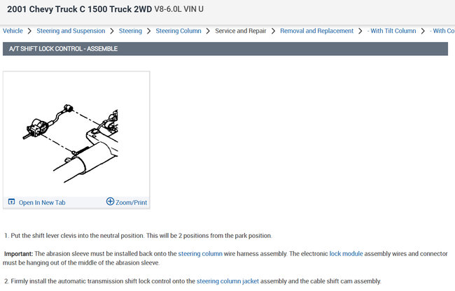

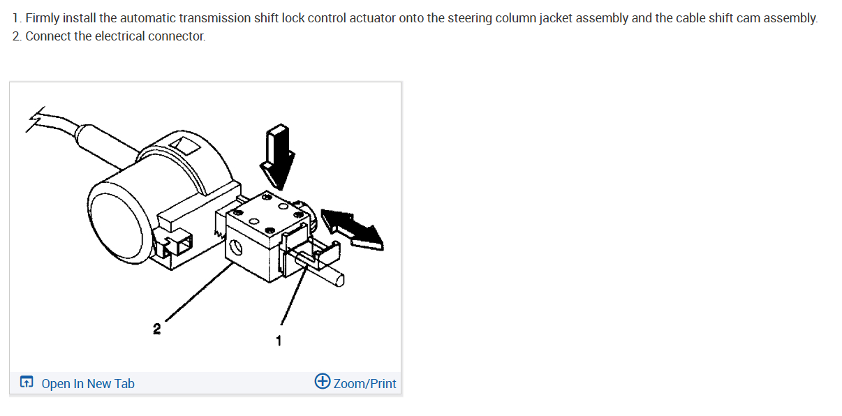

When replacing the shift lock solenoid it must be adjusted. Here is how the job is done. Check out the images (below). Please upload pictures or videos in your response of any problems so we can see what to help you with.

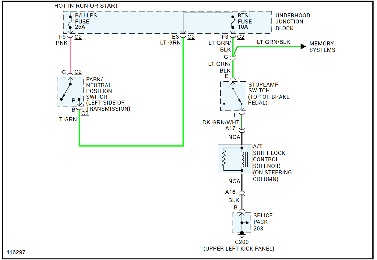

I have installed and adjusted the shift lock solenoid as described and I still cannot get the shifter out of park. As I searched for the possibility cause I realized the pin in Steering Column Shift Control Mechanism isn't being retracted when I press the brakes. So I think that there is an electrical problem sending a signal to retracted the pin. Can you please send me a wire diagram surrounding the pin retaction in the shift control mechanism?

Thank you for the kind words, I hope you have a nice thanksgiving as well ;) Here is the shift lock wiring diagrams and guide to help check for power.

I tested the circuit everywhere I could test it with a test light. So I have confirmed that there is power to the shift lock solenoid. Starting the truck, putting my foot on the brake didn't allow me to get the shifter out of park.

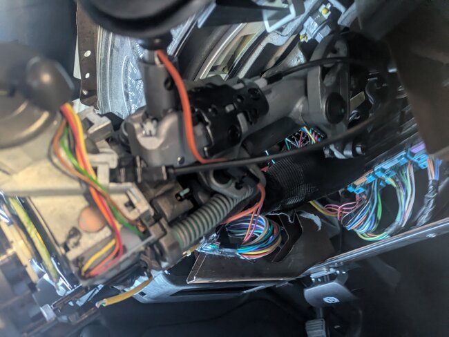

Looking closely at what the problem is, it is a pin in the shift control mechanism. In the photo attached you can see a black wire that loops around from under the shifter and ending at the top of the shifting mechanism. At the end of the wire there is a pin the need to be extracted in order to shift. I can see that the pin isn't getting extracted and that is why I can shift. Do you have any information what power is needed to cause the pin to retracted? Is there a part that I need to replace?

The light-grn/blk wire should get 12 volts when your foot is on the brakes and the blk wire sound be ground, test the wiring with the shift lock solenoid disconnected. Please go over this guide for clarification.

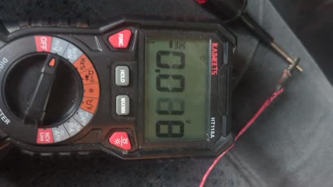

When I tested the battery I got 12.57 volts. Testing the green wire on the plug I got 11.58 without the brake being pushed and break it went down to about 20 to 5 millivolts. What do I need to check now that the solenoid isn't getting the correct power?

All right! now we are getting closer. Lets test the drgrn/wht wire coming out of the brake light switch. When the brake is depressed you should get close to 12 volts. Let me know, you might have a bad brake light switch.

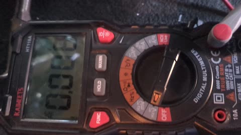

I put the lead into the green/white line and tested it for power. No matter when I pushed the brake did I get anywhere close to 12 volts. See video. With this result do I need a new brake light switch?

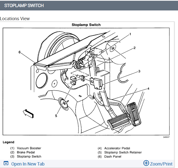

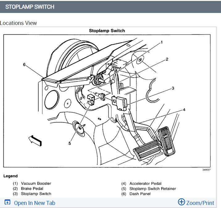

Do the brake lights work? If so, the brake light switch is bad and needs replacement. Here is how to swap it out. Check out the images (below). Let us know how it goes.
Dec 5, 2024 at 1:33 PM
RLPETERSON78
  • 129 POSTS
Yes the brake light works when I press the brake pedal. The only thing that doesn't work is the green wire to the shift lock solenoid. I tested it at both ends and didn't get 12 volts from either end. If the rest of the Brake light switch works but the wire to the shift lock solenoid doesn't, what does that indicate?
Dec 5, 2024 at 2:46 PM
The brake light switch is bad if you are not getting 12 volts from the grn/wht wire. Let me know what happens.
