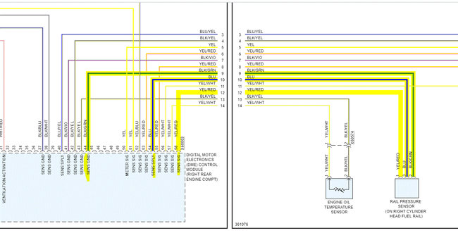

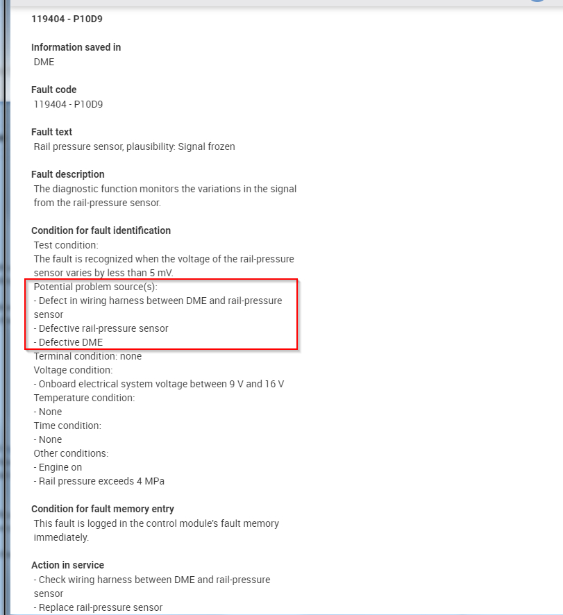

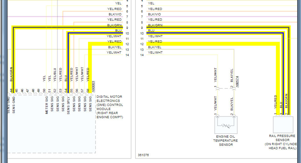

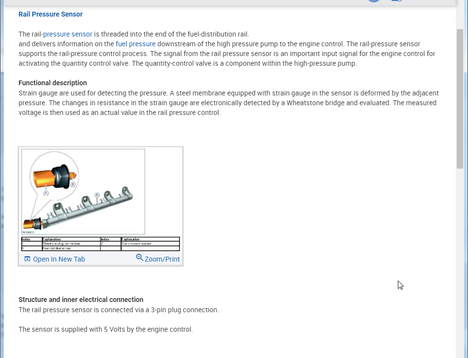

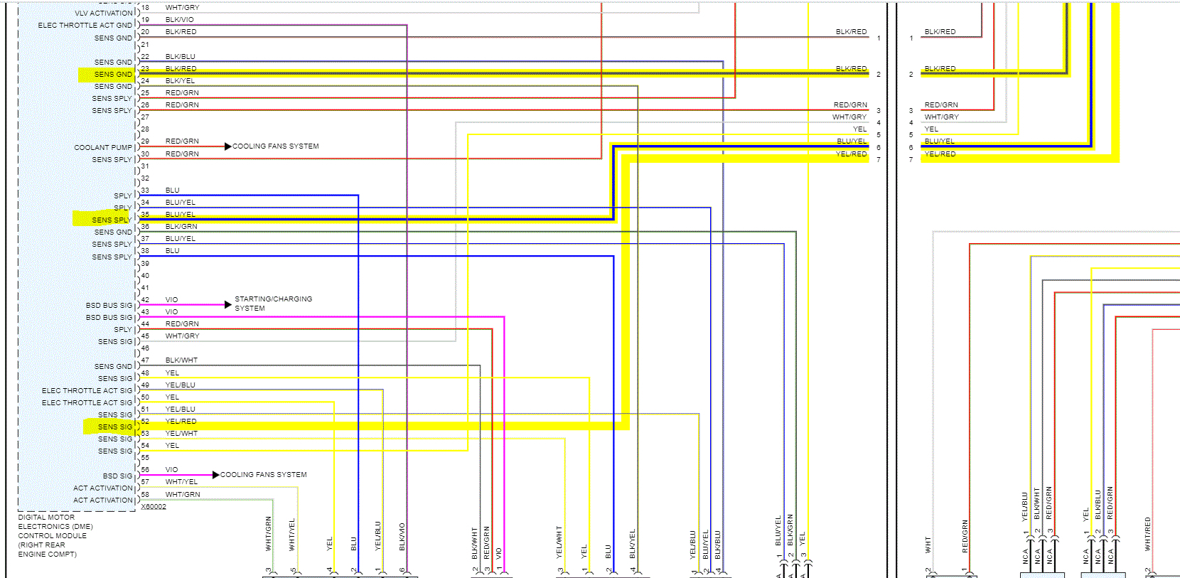

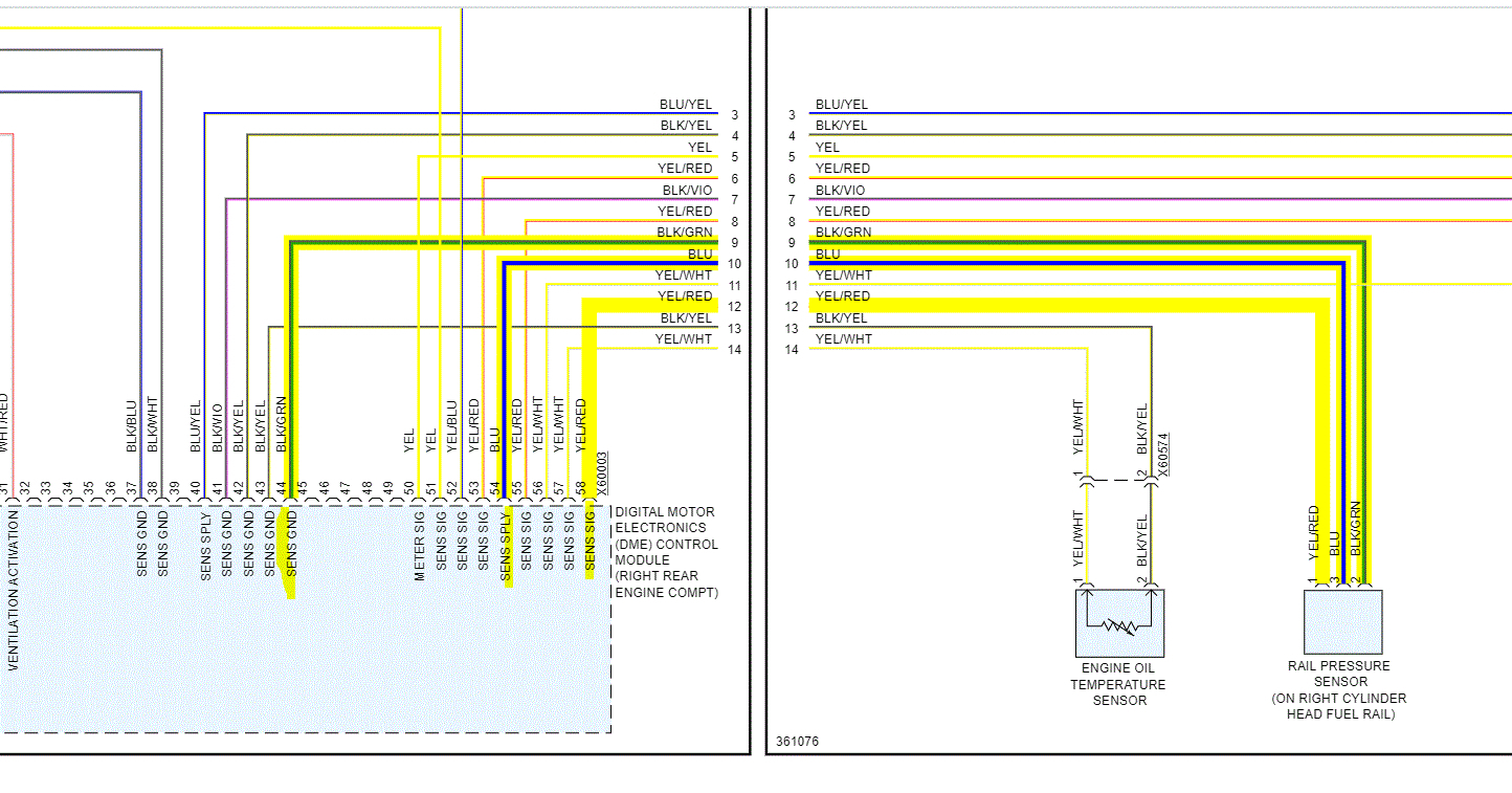

A few days back I got an engine warning. Every code was in regards to low fuel rail pressure. Everything pointed to a clogged fuel filter. I replaced the fuel pump and filter located inside the fuel tank. Yet the engine still had problems. I replaced both the high and low fuel pressure sensors. Still issues. Also now I have a airflow to high in addition to the low fuel rail pressure. Here are the current codes:
P10D9
POOBD
P10D9
POOBD
