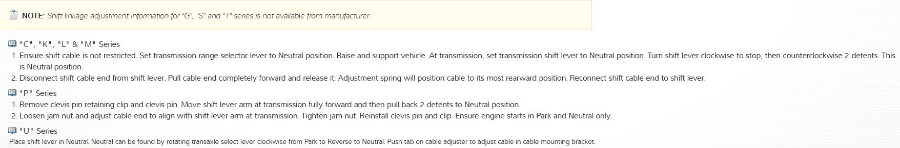

I am unable to shift into park. Is there a way to adjust the linkage to the shifter cable?

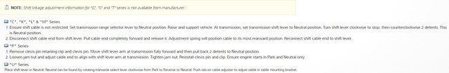

Although this is a T series and the manual says "Shift linkage adjustment information for "G", "S" and "T" series is not available from manufacturer." You can try one of these procedures.
