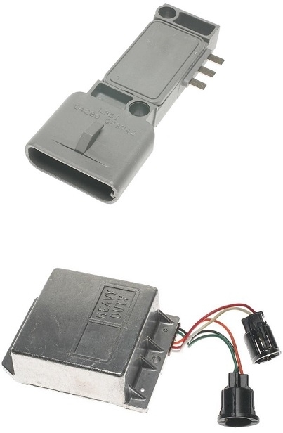

I've got a new rebuilt Holley carburetor on it,.. And as I've said it's a 20'class c motor home and when I punch it from 0-30, everything works normal,... It shifts thru the gears, and I can hear the carburetor sucking down the fuel, even the kick down works normal. And I'm not sure why you brought up the brake thing. The brakes work fine and don't need any advice on those. But thanks ? I've heard others say something about a part inside the distributor,.. Maybe a "pickup".Then also.Have you ever heard of the ECM (engine control modular) going out in sports ? Or do they either work or not work ? Different folks call it different things. But I'm talking about the little computer that's on the fire wall. Thanks for your time. Hippie

You don't think this is fuel-related, so I'm looking for other possibilities. Dragging disc brakes is fairly common so I wanted to mention it and not overlook anything that might give you an idea of what's causing this.
There were two ignition systems used by Ford in '84. One used a TFI module, (thick film integrated), bolted to the side of the distributor. That's shown at the top of the photo. More common for '84 was the ignition module shown at the bottom of the photo. That is not a computer as we think of an electronic control module, (ECM) or power train control module, (PCM). Those have memories and can set diagnostic fault codes to indicate a circuit that needs further diagnosis. The modules in this photo simply take the place of the breaker points in older systems. They drive the ignition coil, to create a spark when they're triggered by a pulse from the pick-up coil inside the distributor. That pick-up coil sits where the breaker points used to be.
When you have a true Engine Computer, (ECM or PCM), those calculate ignition timing which you can't change or adjust. The pulses from the pick-up assembly start out seriously advanced, often as much as 30 - 40 degrees, then the computer calculates how much delay is needed to fire the ignition coil at just the right time. It looks at coolant temperature, intake air temperature, engine load, (vacuum), engine speed, and on all except Chrysler engines, the weight of the incoming air, (mass air flow sensor), to calculate fuel needs and ignition timing. Newer systems no longer use a distributor, but the clue when you do not have an Engine Computer is the vacuum advance unit on the side of the distributor. That, and the internal advance weights won't be there when there's a computer to adjust the amount of timing advance. The first true computer was used on '77 Chryslers but it only adjusted ignition timing and it couldn't set diagnostic fault codes. Those systems were primitive by today's standards so the entire system could be diagnosed in a few minutes. Today we wouldn't have any idea where to start without fault codes, and we could waste weeks trying to solve some problems without them. Starting in '78, the Engine Computers on some Chrysler models also adjusted fuel / air mixture, but they still used carburetors.
As far as ignition module failures, they can be intermittent, but intermittent stalling is much more likely to be caused by the pick-up coil inside the distributor. That can be caused by the constant flexing of the wires as the vacuum advance unit moves it back and forth, or it can be caused by one of the ends of the coil of wire breaking off its terminal. The real common symptom when the wire breaks at the terminal is the engine starts fine cold and runs okay as long as you keep moving. Natural air flow keeps the distributor cool. It's when you stop for a few minutes with a hot engine, such as when stopping for gas, that you'll have a crank / no-start. It's caused by "hot soak" when engine heat migrates up to the distributor and causes the pick-up coil to expand. That lets the break in the wire open up. The common observation is the engine will start and run fine after cooling down for about an hour or two.
Each manufacturer had their common failures with these early systems, but none of them caused the symptom you described. Since you mentioned the engine sputters at 35 mph, perhaps this is when the vacuum advance is just kicking in, and the wires to the pick-up coil are flexing and breaking. A test for this would be to disconnect the vacuum hose at the distributor, and plug it, then go for a drive and see what happens. You'll still have mechanical advance that's needed at higher engine speeds, but that doesn't move the pick-up coil or flex its wires. If there's no sputtering and you can reach highway speed, we'll discuss how to test the pick-up coil, if you want to, to verify its failure.
