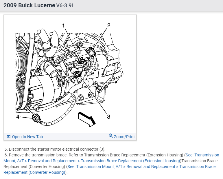

Located starter removed two bolts are too small to remove. Also took nut off Front Motor mount near starter jacked up engine, still can't remove.
Aug 18, 2022 at 5:17 AM
SQM
  • 6,383 POSTS

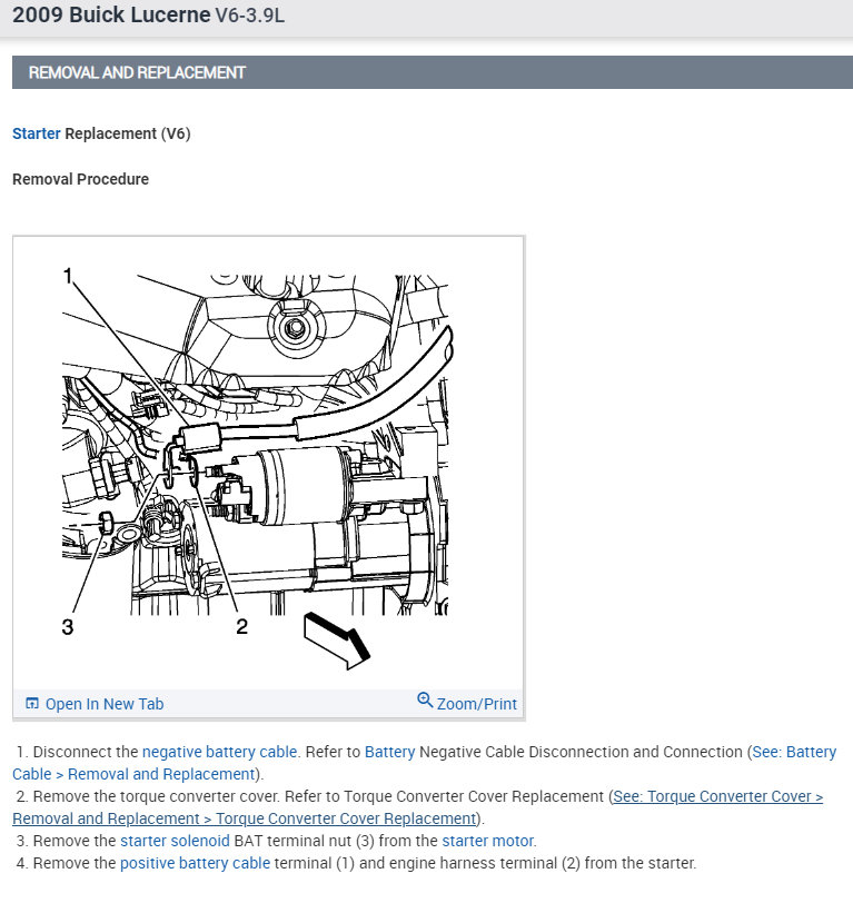

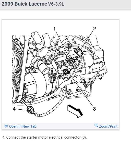

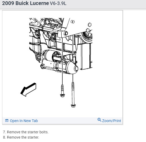

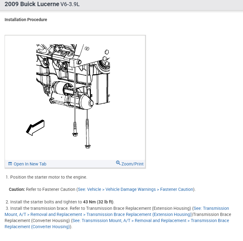

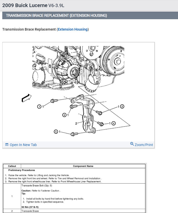

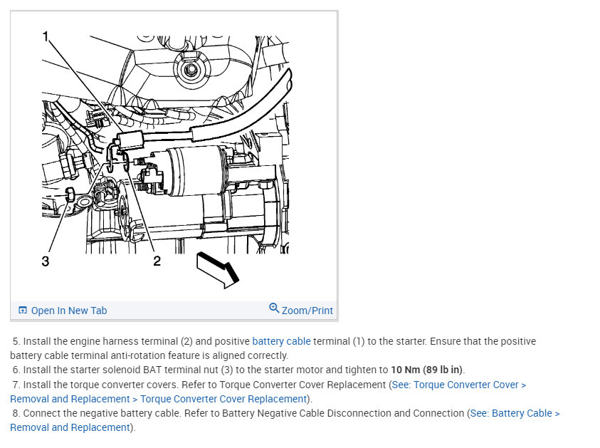

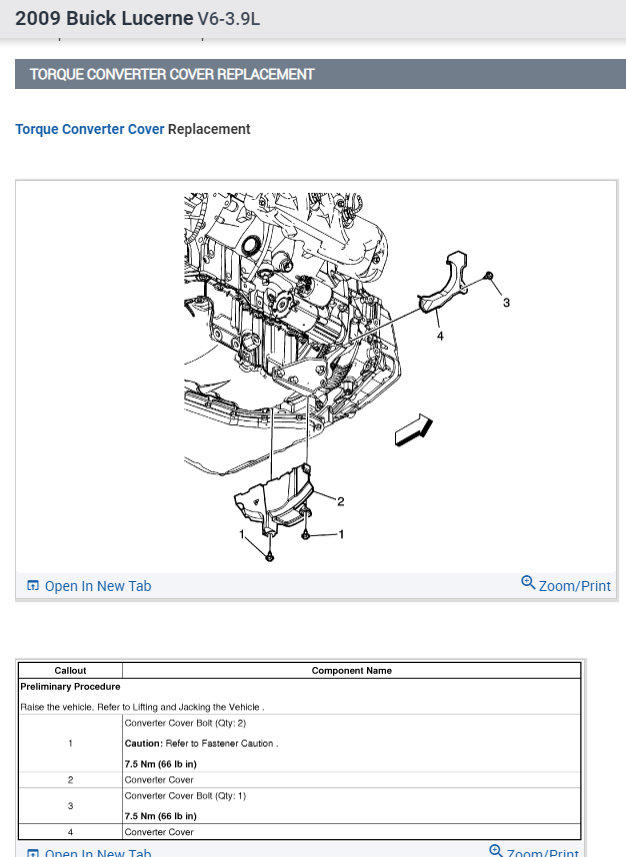

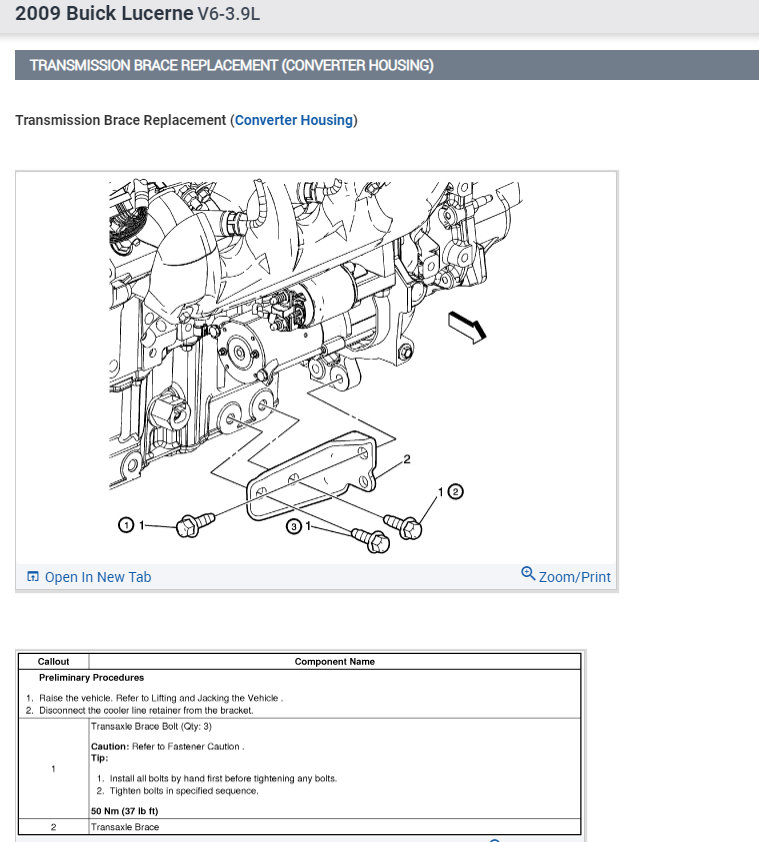

In order to replace the starter, you will have to remove the torque converter cover as well as the transmission brace.
This will allow enough room to remove the starter:
I have attached the replacement procedure below.
Let me know of any questions.
