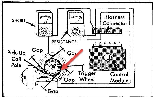

you need to clarify on stuff like that in future. check items in pic to specs. air gap shold be .010 you might need a brass feeler gauge for dist air gap. then check #15 at control module for power and ground wire to control module. if car still not starting get back to me as I have to go to a different manual for this. also check all your fuses to make sure they are making contact.
