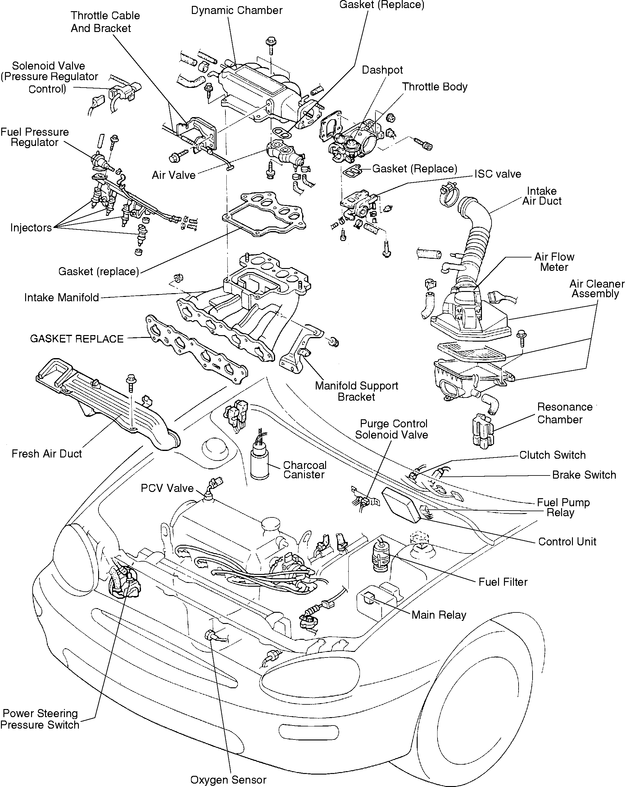

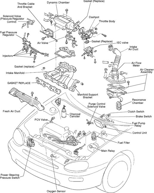

For the idle issues, here is a general overview of the IAC and directions on replacement.
https://www.2carpros.com/articles/how-to-replace-an-idle-speed-control-motor-iac

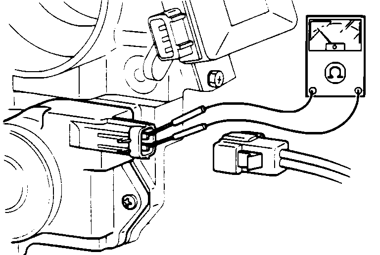

The IAC or idle speed control is located under the throttle body. Take a look at pic 1. Make sure it's connected and no damage was done to the wiring. Here are the directions to test the IAC / ISC. The remaining pic correlate with these directions.

1. Unplug ISC valve connector.
2. Measure resistance across terminals. It should be 10.7 - 12.3 ohms @ 68°F (20°C).
3. If not as specified, replace valve.
