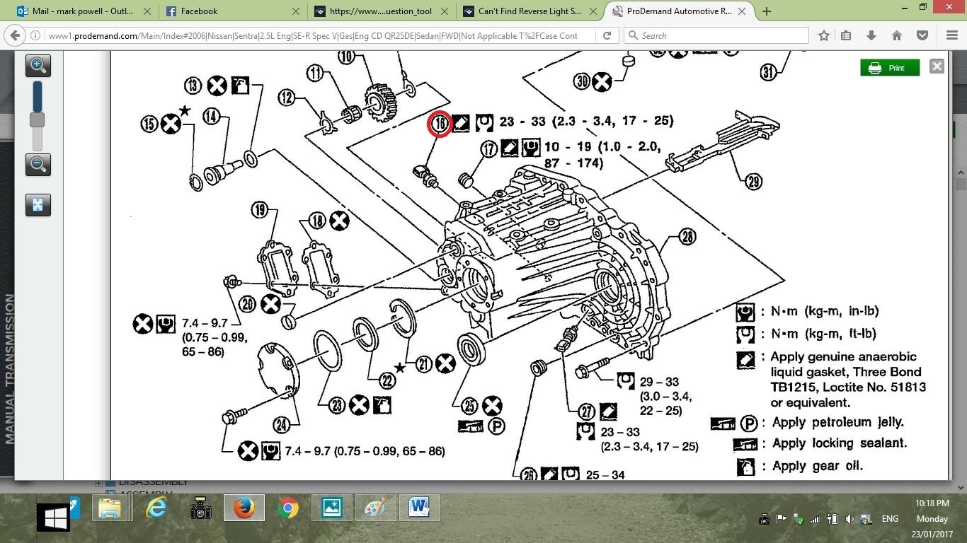

The reverse lights are not coming on. I want to try cleaning/troubleshooting the switch before replacing. I just cannot find it.

The revers light switch is on the transmission switch item #16 in red circle. Check out the diagrams (Below). Please let us know if you need anything else to get the problem fixed.
