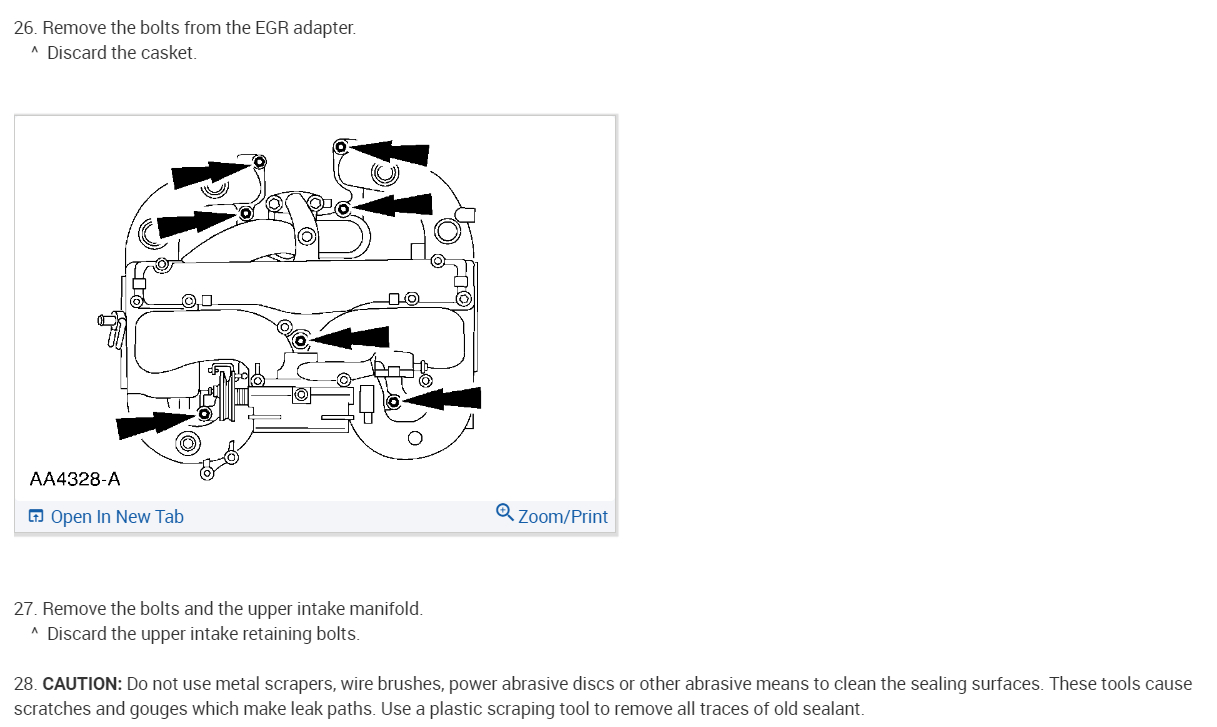

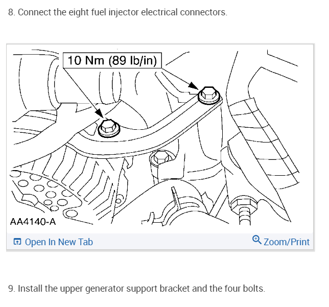

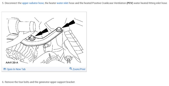

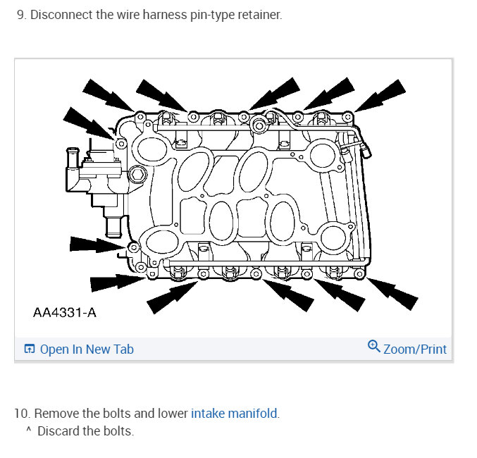

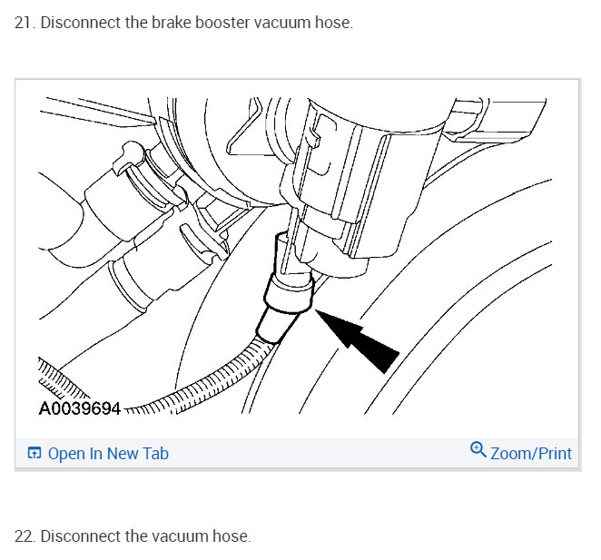

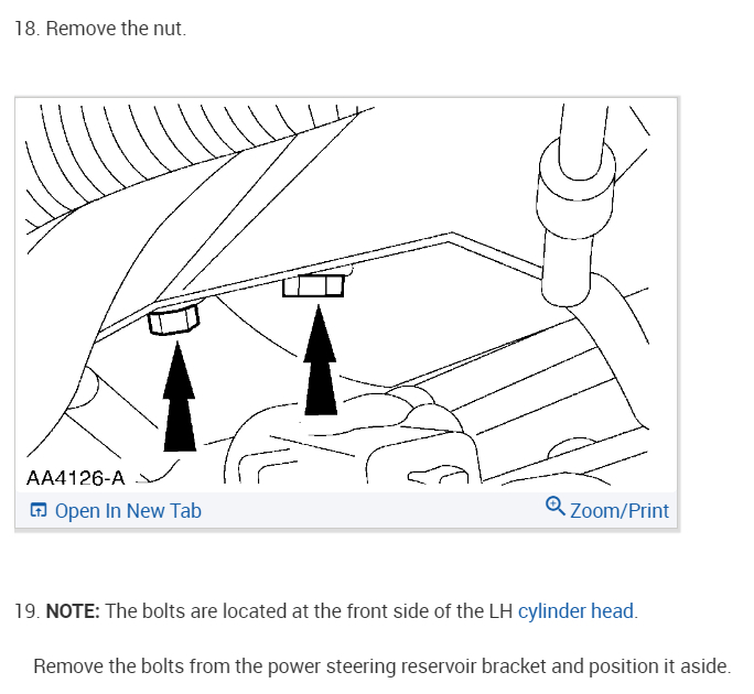

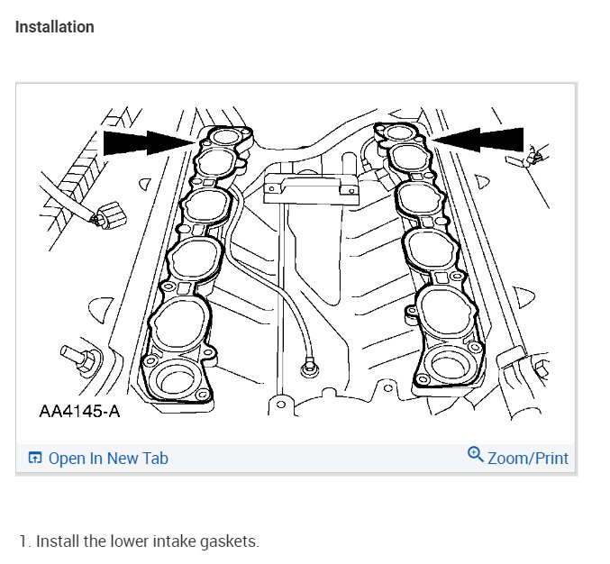

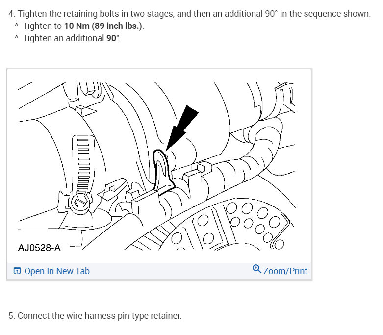

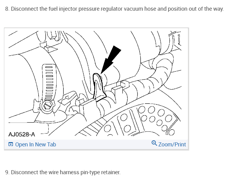

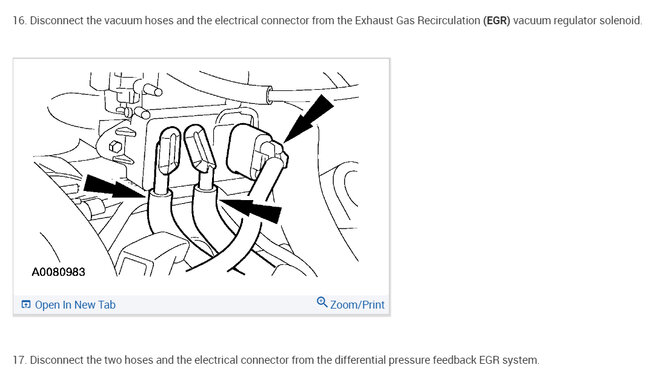

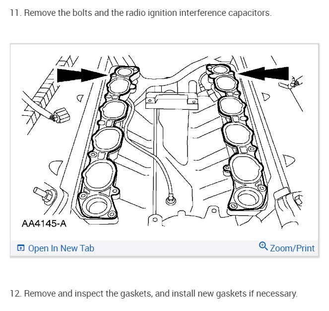

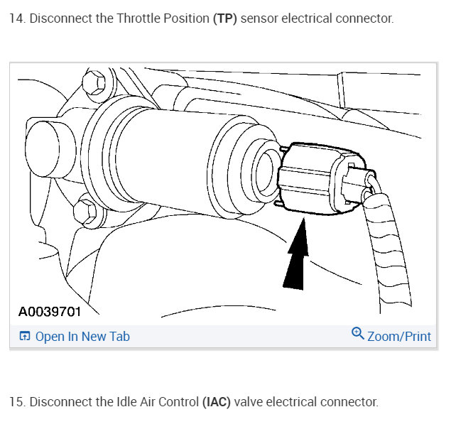

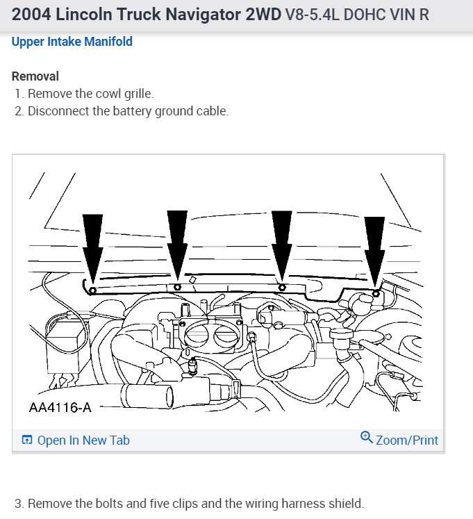

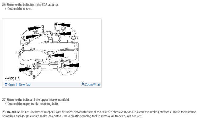

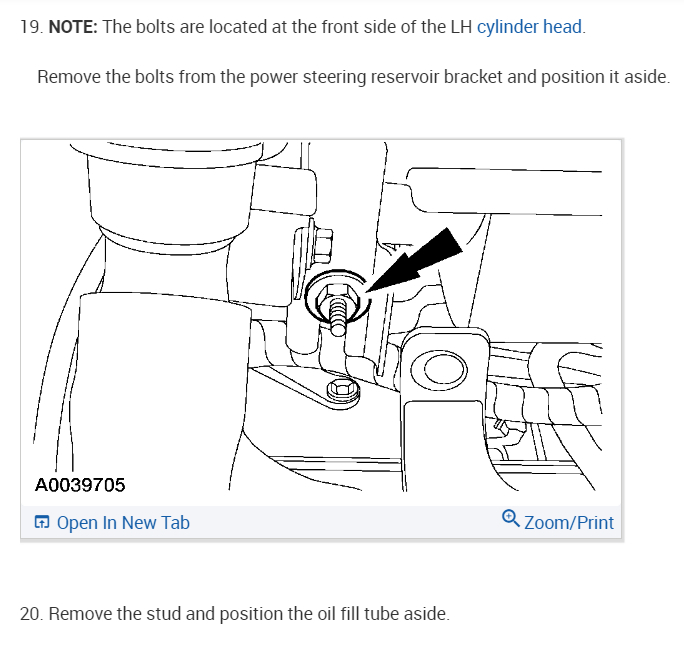

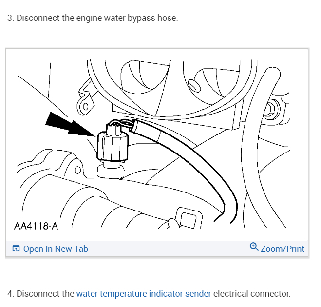

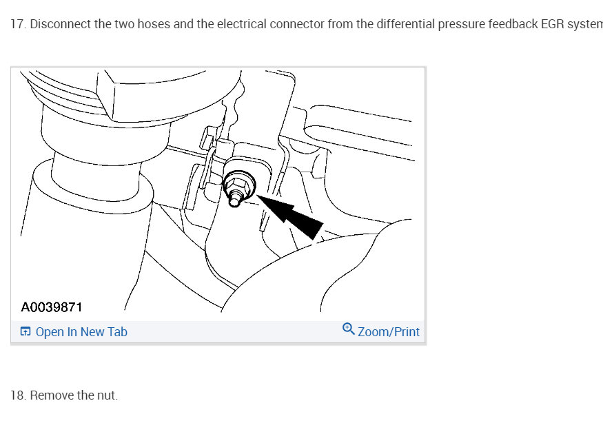

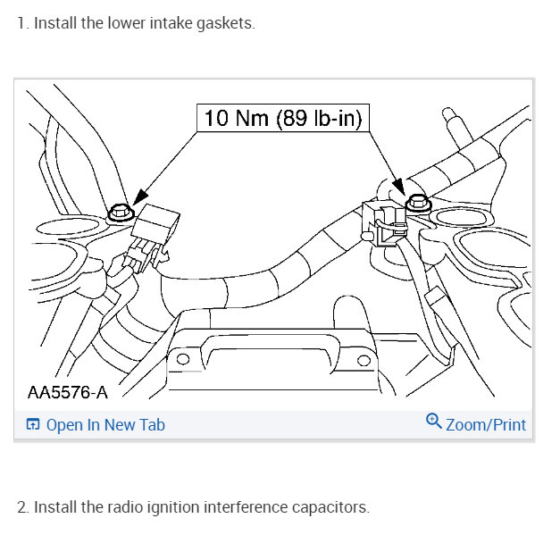

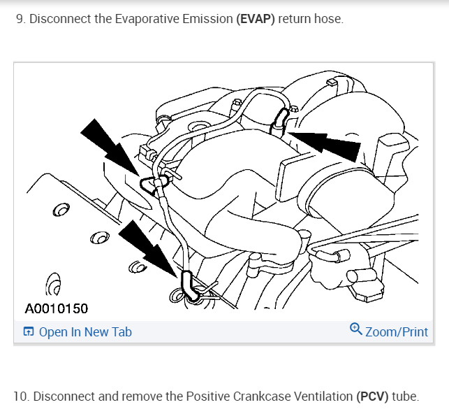

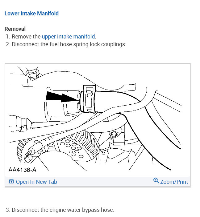

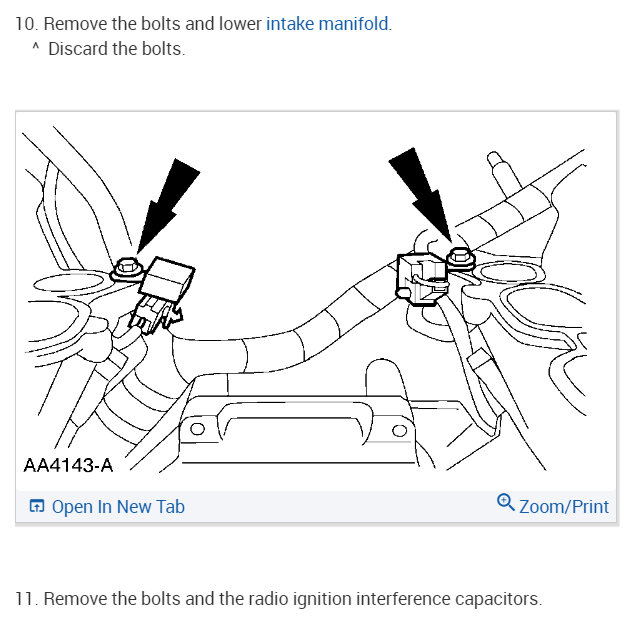

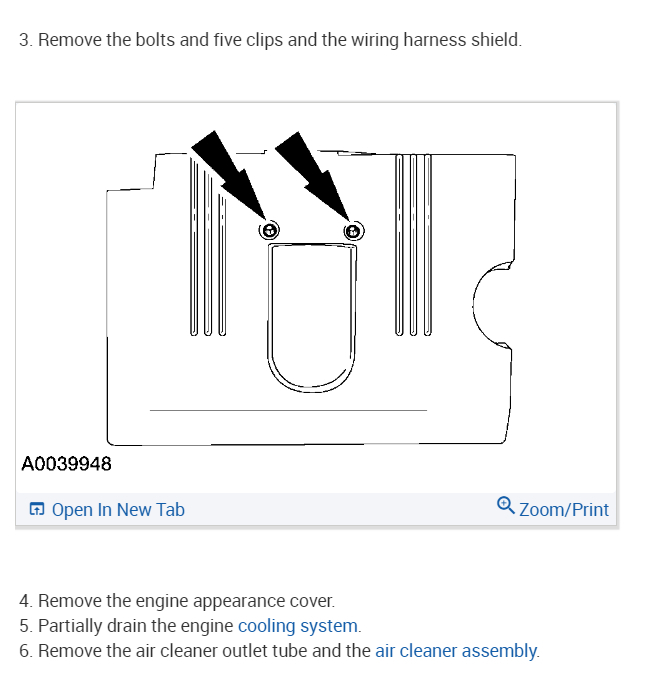

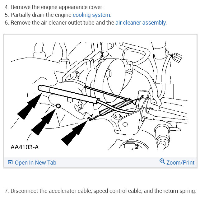

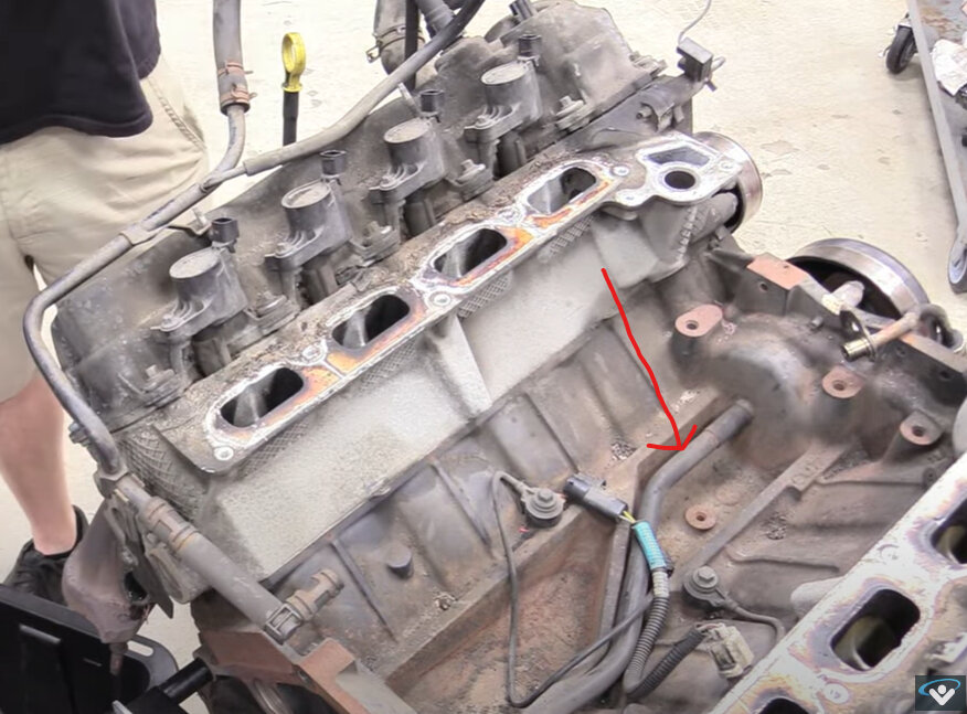

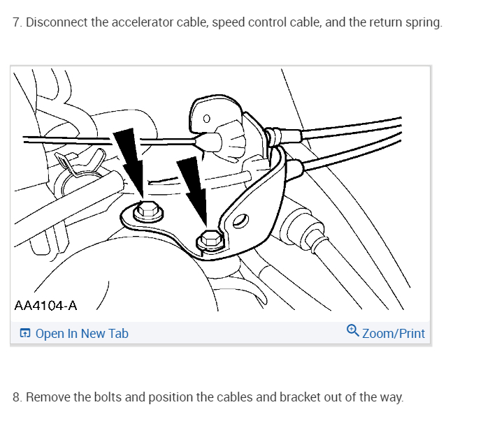

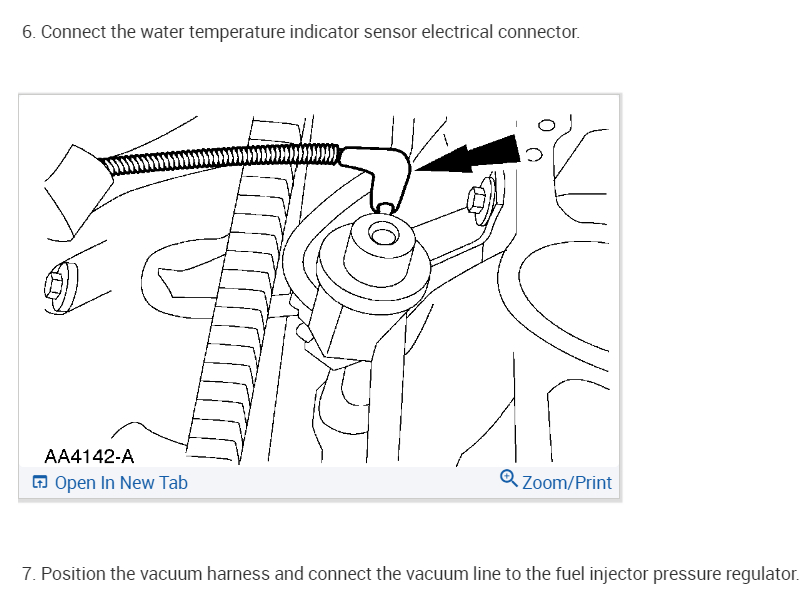

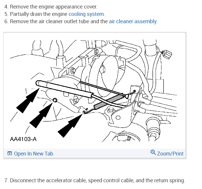

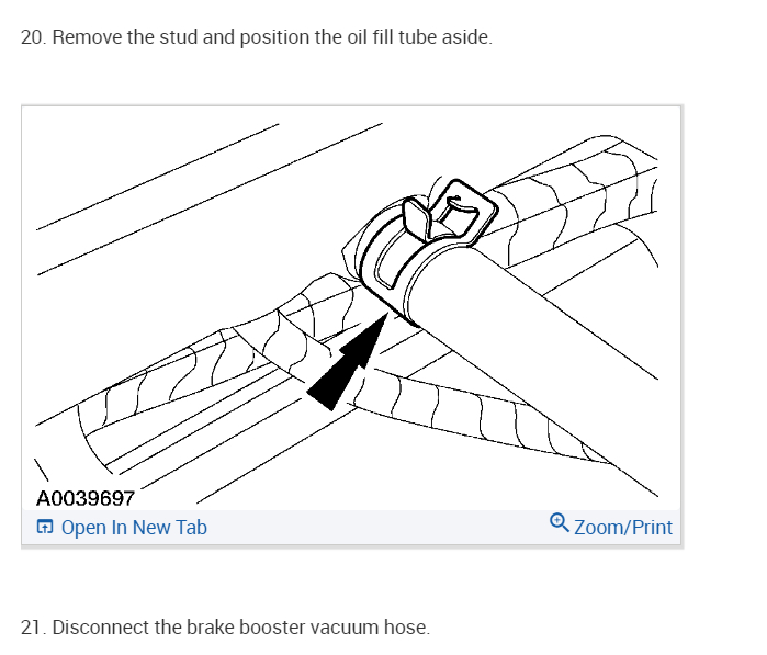

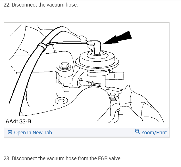

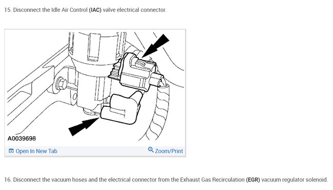

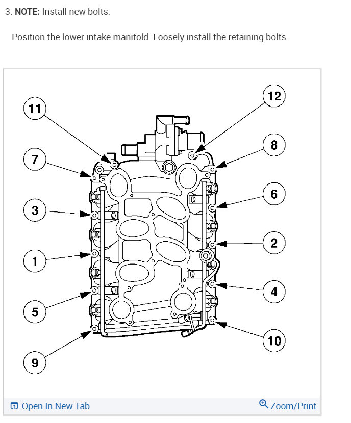

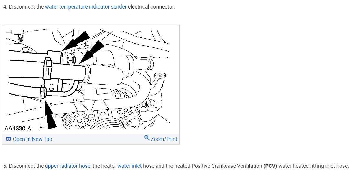

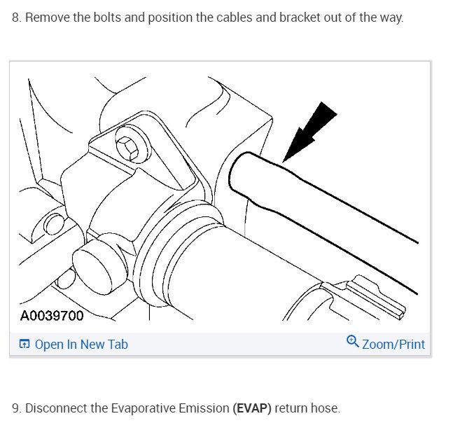

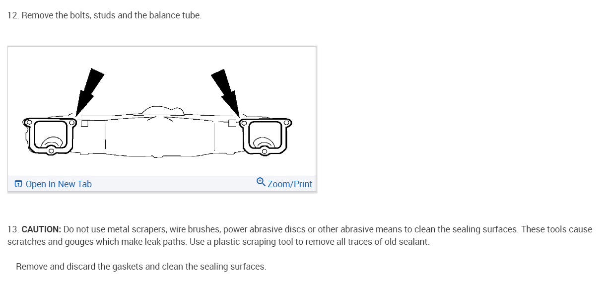

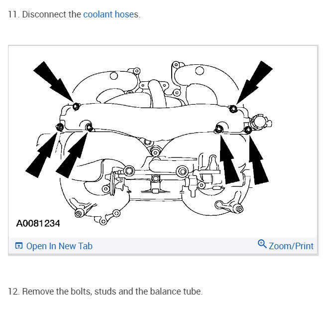

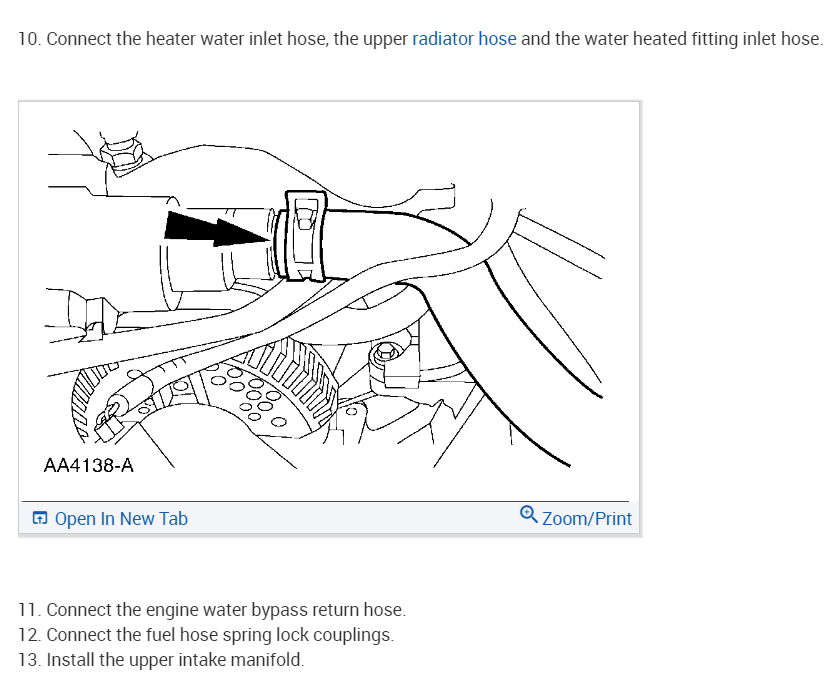

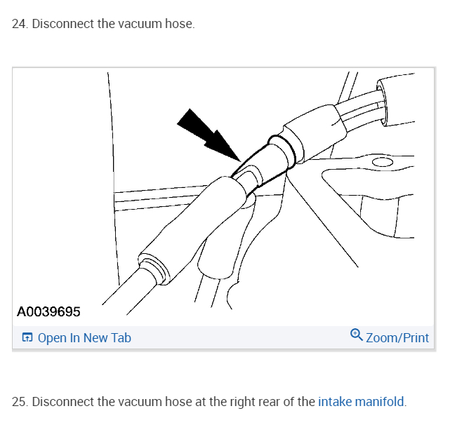

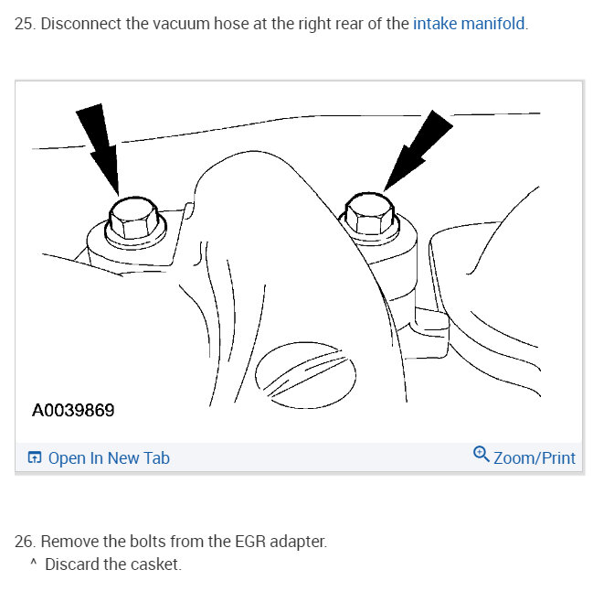

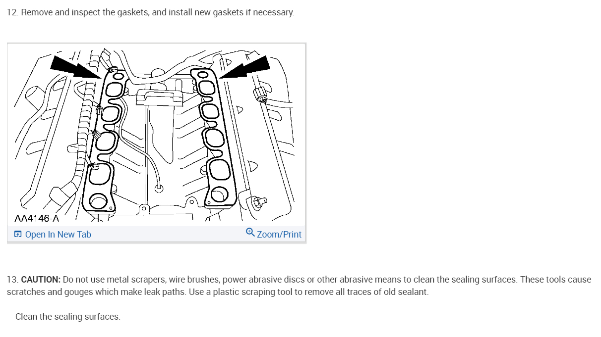

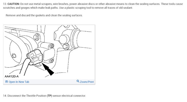

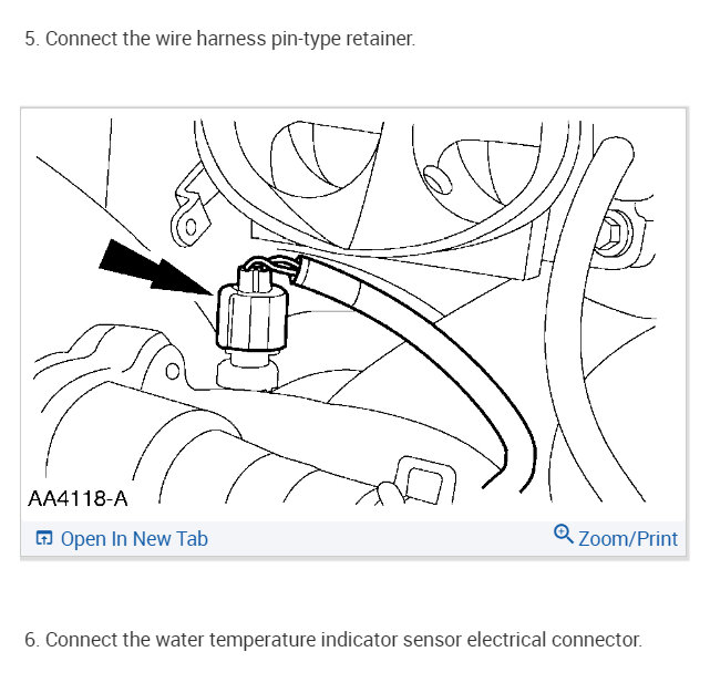

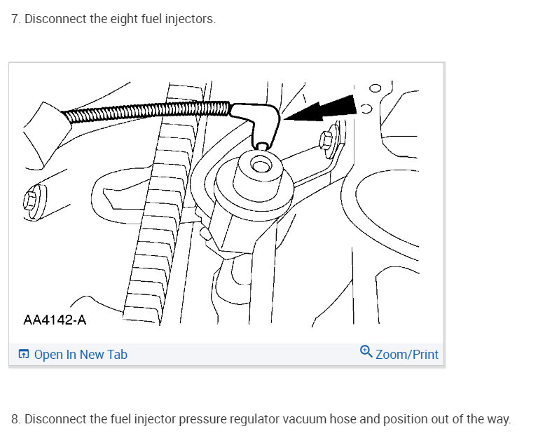

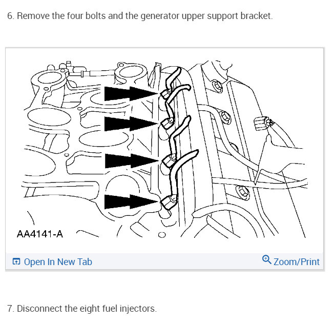

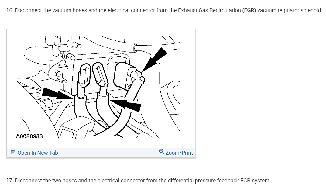

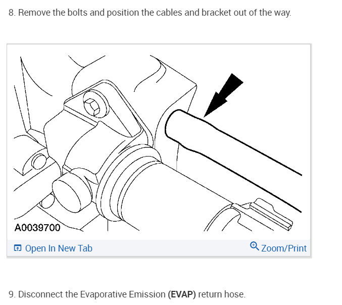

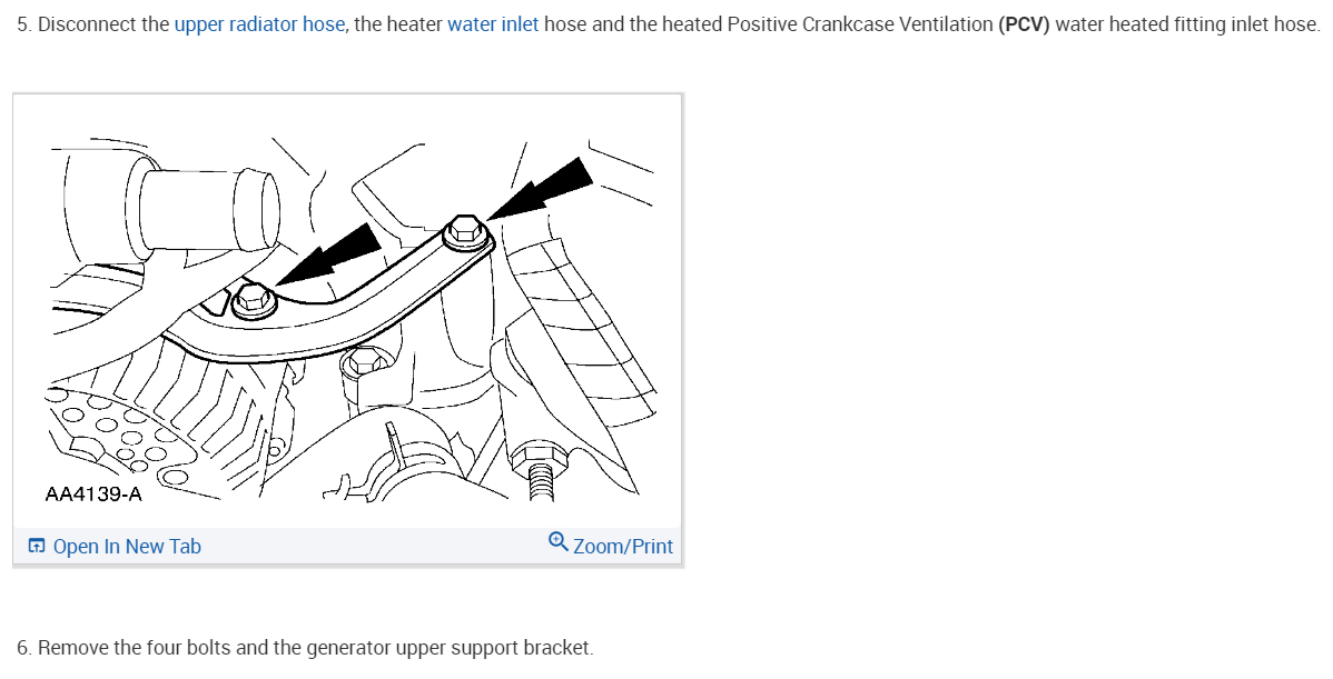

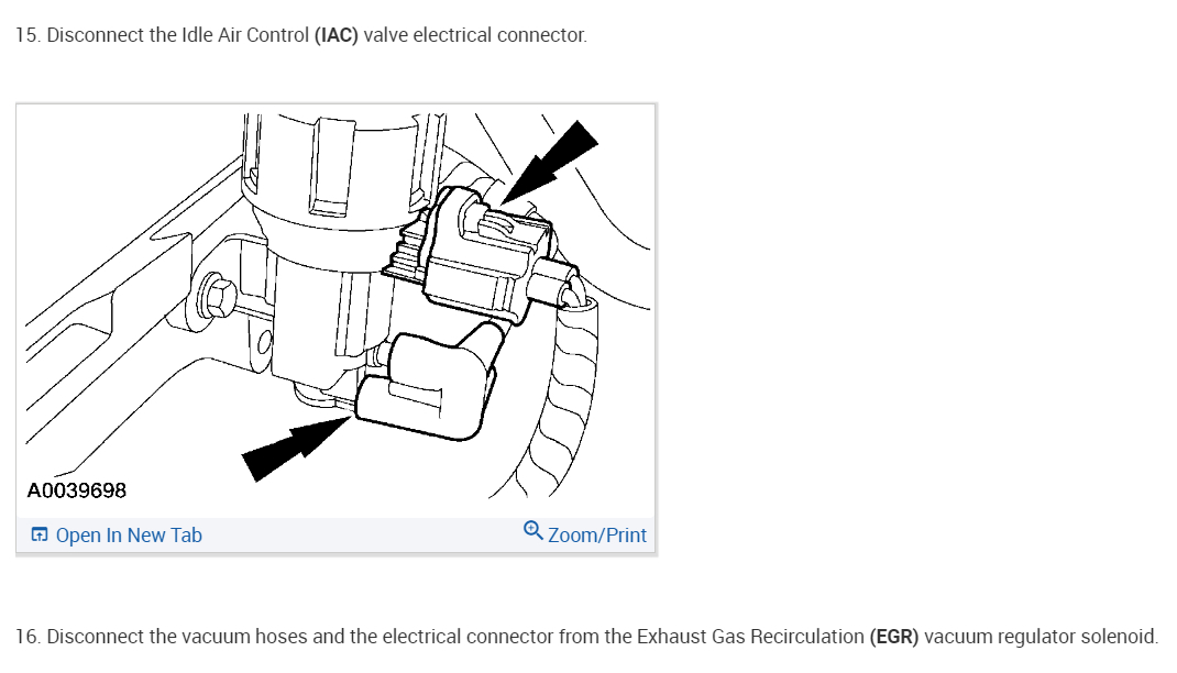

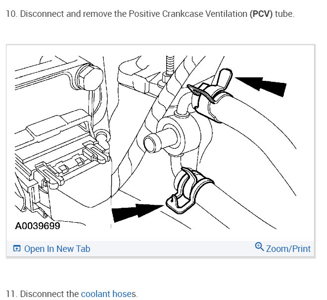

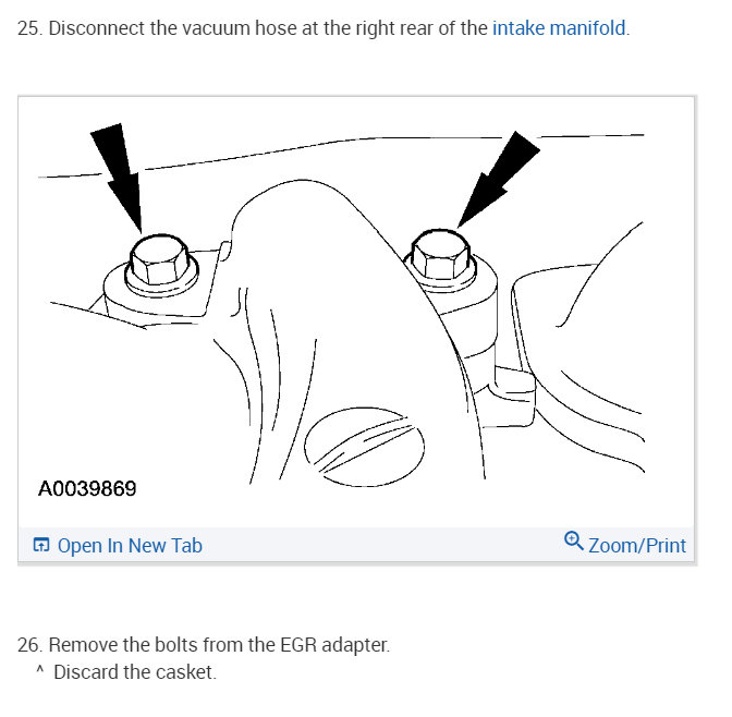

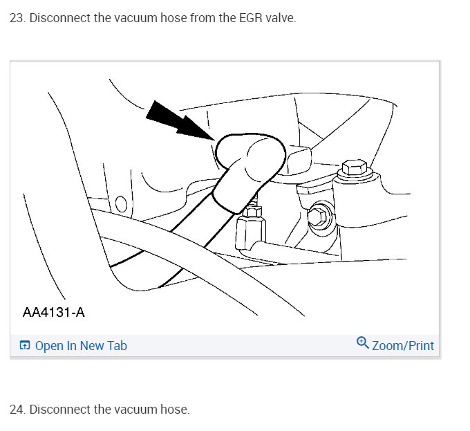

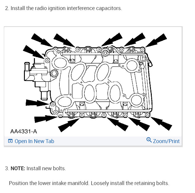

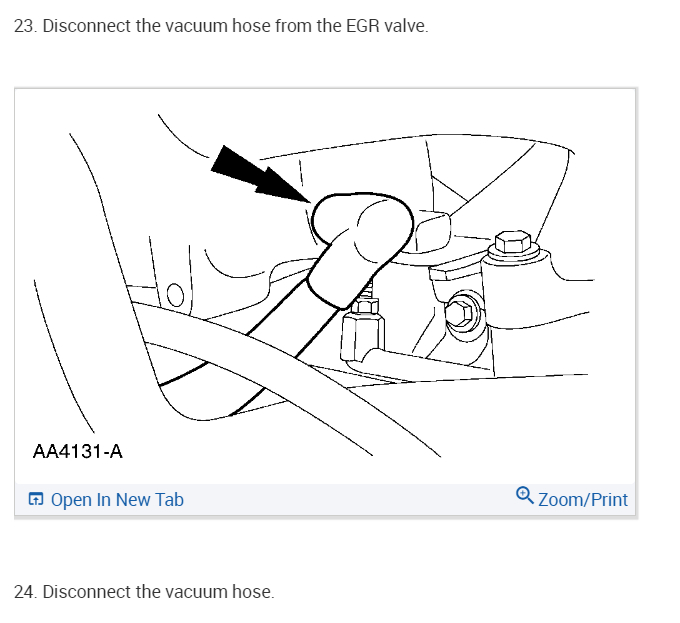

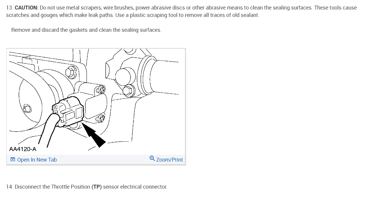

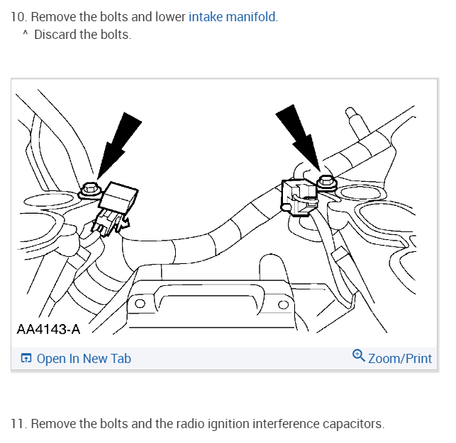

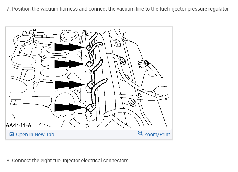

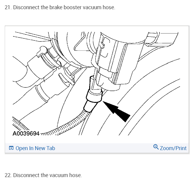

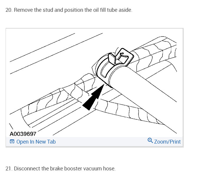

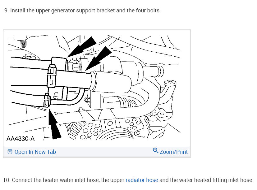

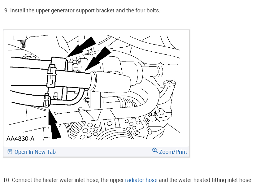

There is a heater hose tube that runs under the intake manifold that can rot out due to rust and cause a leak like you have described which is common. The intake must be removed to fix the leak. Here are the instructions on how to do so. Here is the heater hose tube I am talking about. Also check out this video which can help walk you through the repair:
https://youtu.be/QuNLrE3rrb8?si=q--9FngbrueWJ4Mi
Check out the images (below). Let us know what happens and please upload pictures or videos of the problem so we can see what's going on.
