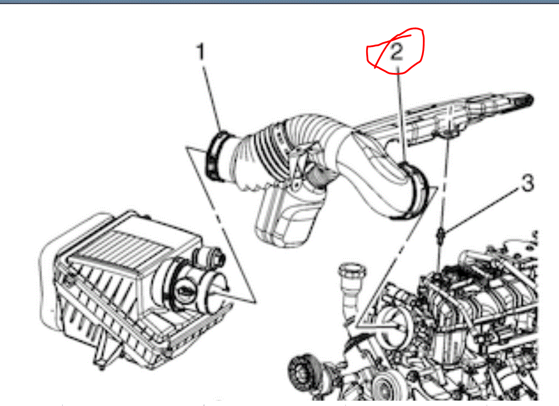

As far as the MAF, have you replaced it? The MAF incorporates the IAT (intake air temperature sensor). Also, have you checked the air intake tube where it mounts to the throttle body? There were issues with them cracking and allowing unmetered air to enter the engine. See pic 1 below.

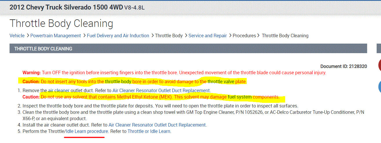

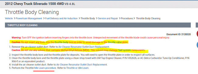

Next, if you sprayed a lot of throttle body cleaner into it, that could have caused issues for the spark plugs. Also, when you open the throttle plate by hand, you have to perform an idle relearn procedure.
Do me a favor, take a look through the manuals directions for cleaning the throttle body. (see pic 2 below). Pay attention to what I highlighted and check the product you used.

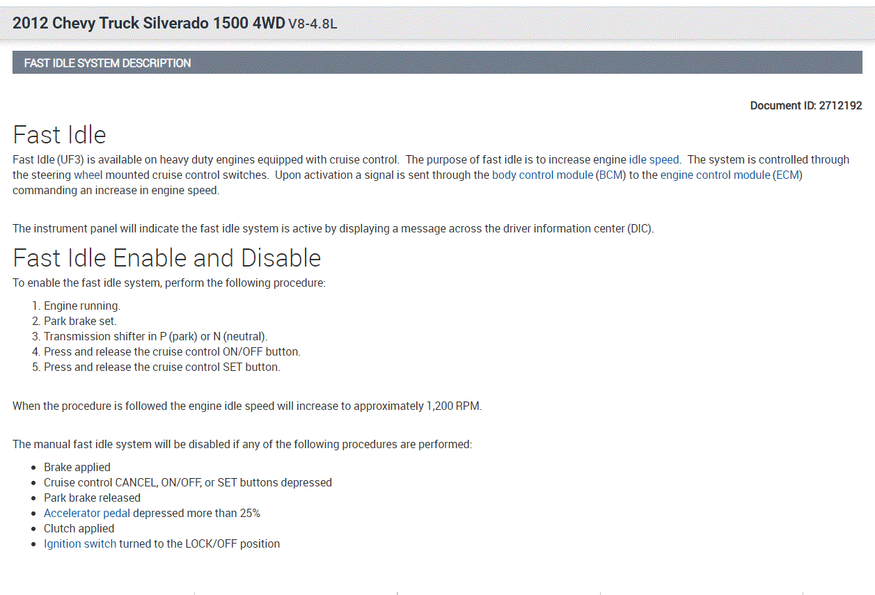

If you look at pic 3, it explains the idle relearn procedure.

So I went out this morning and started it and it’s not sputtering now. Kind of wondering if because the engine is cold now. But I tried to do the high idle and it didn’t change the idle but the idle isn’t high. Also the check engine light isn’t on anymore and the truck seems to be idling fine While it’s cold. As writing this I let it warm up and sit for awhile and after about ten minutes the idle drops slightly and you can feel it shake and smell gas but no check engine light. What might this be seeing how it’s not backfiring anymore and there is no light?

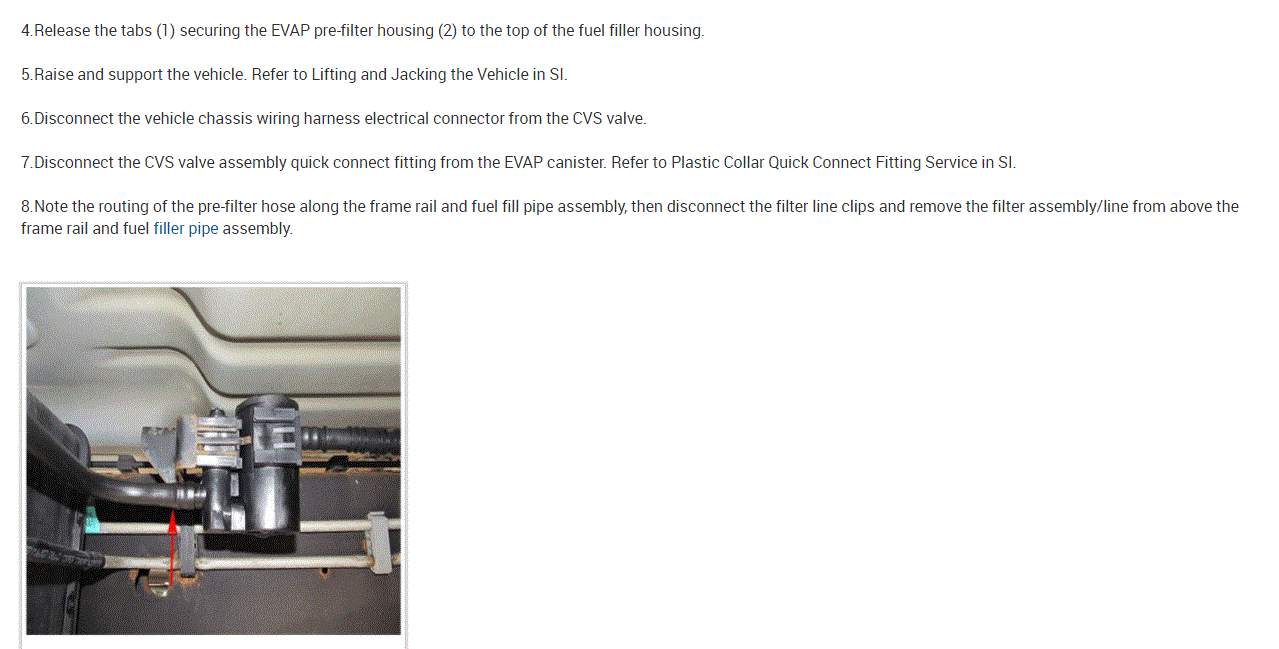

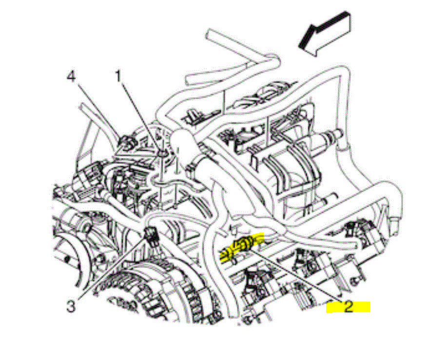

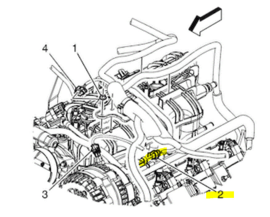

Where are you smelling gas? Does it seem like it's running rich or do you smell it from a different place? It could be an issue with the EVAP system causing a vacuum leak.

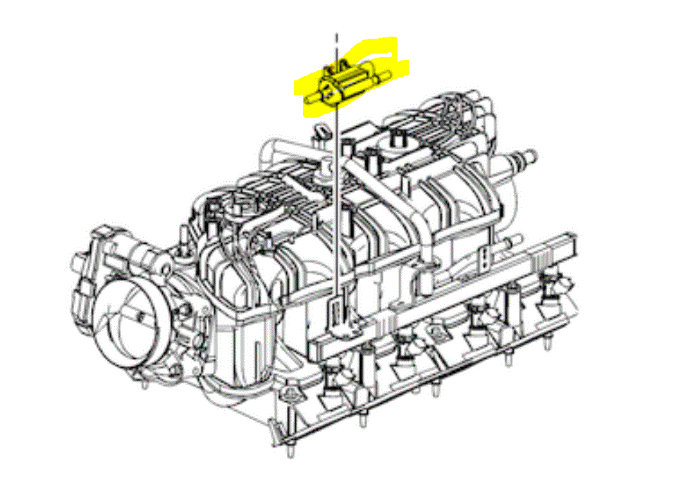

Do me a favor. Check the EVAP purge solenoid. I attached two pics below to help you locate it. Check the line to and from it. Make sure nothing is disconnected or damaged. When that solenoid opens, it allows fuel vapor to enter through the intake. It comes from the charcoal canister. The solenoid itself may be damaged causing a vacuum leak (lowering RPMs) and the fuel smell.

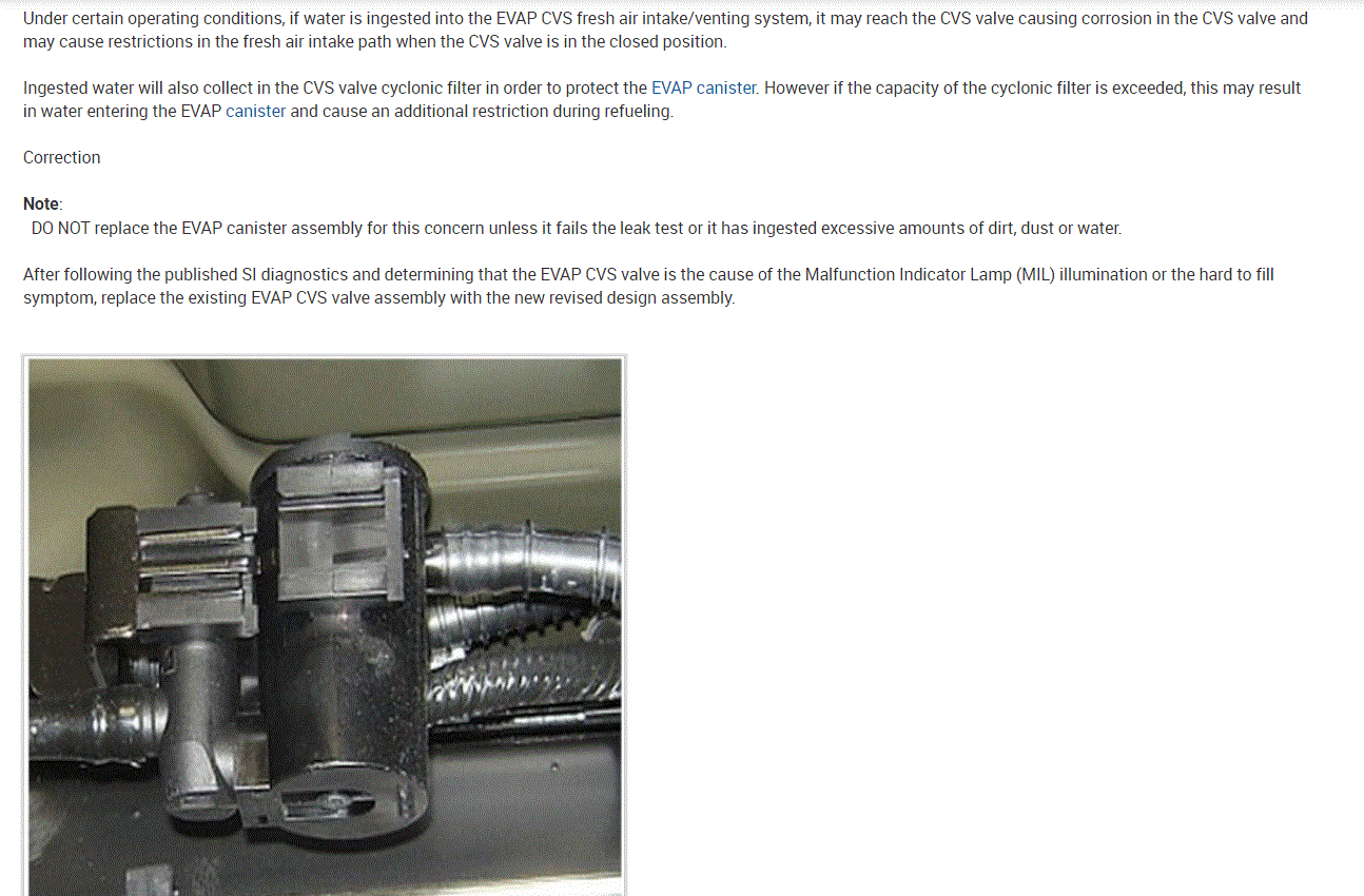

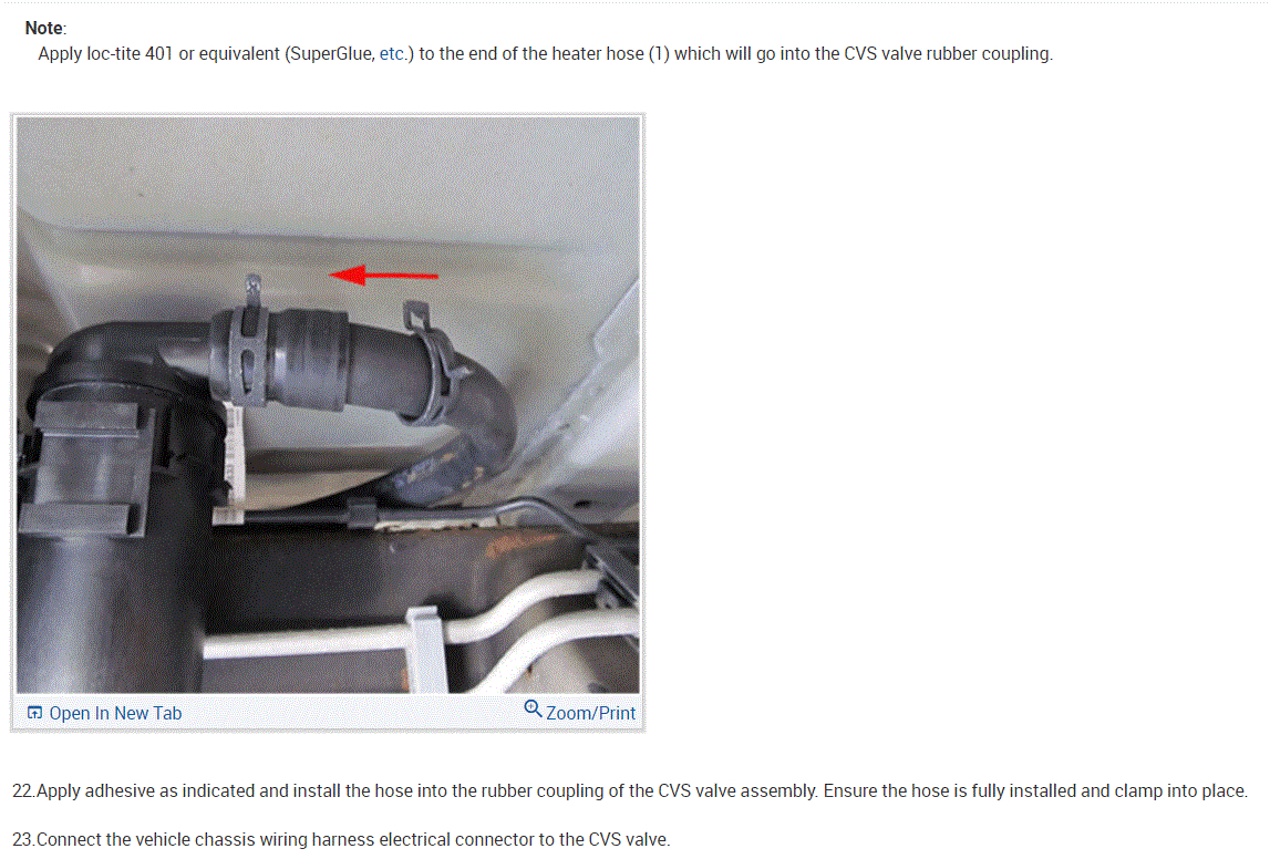

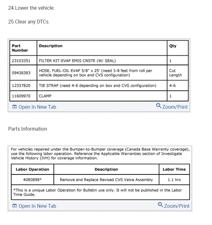

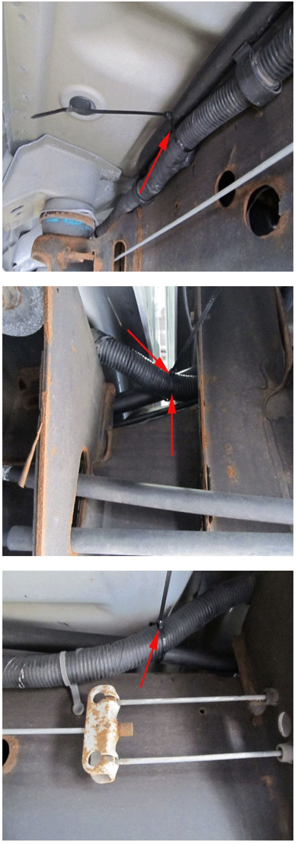

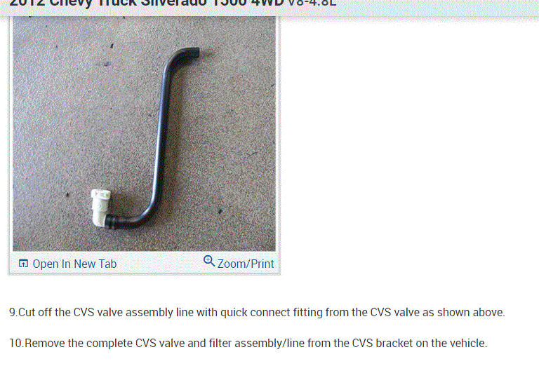

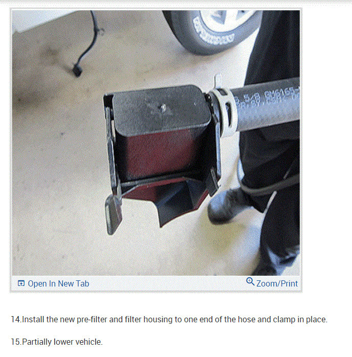

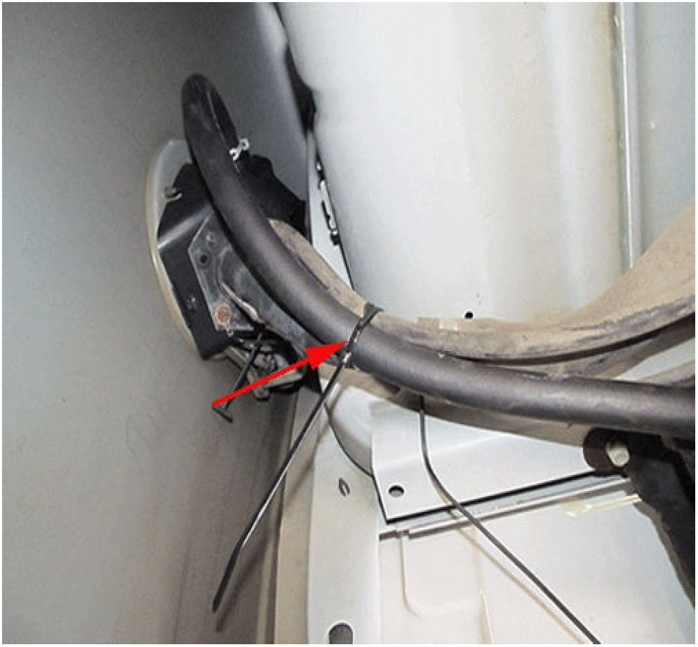

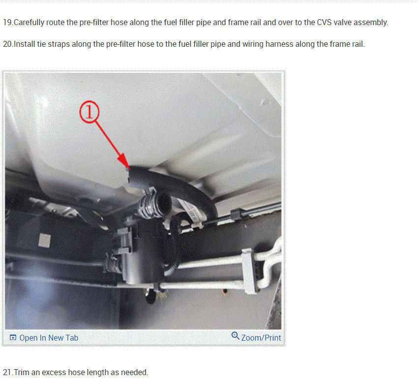

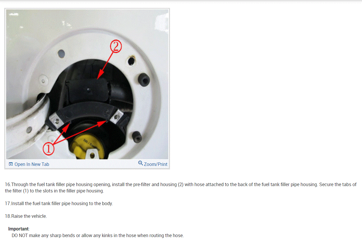

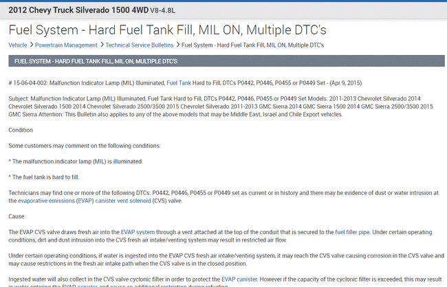

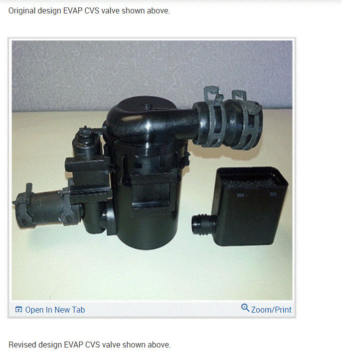

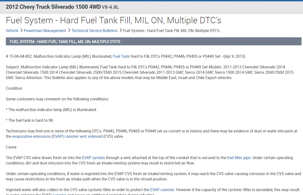

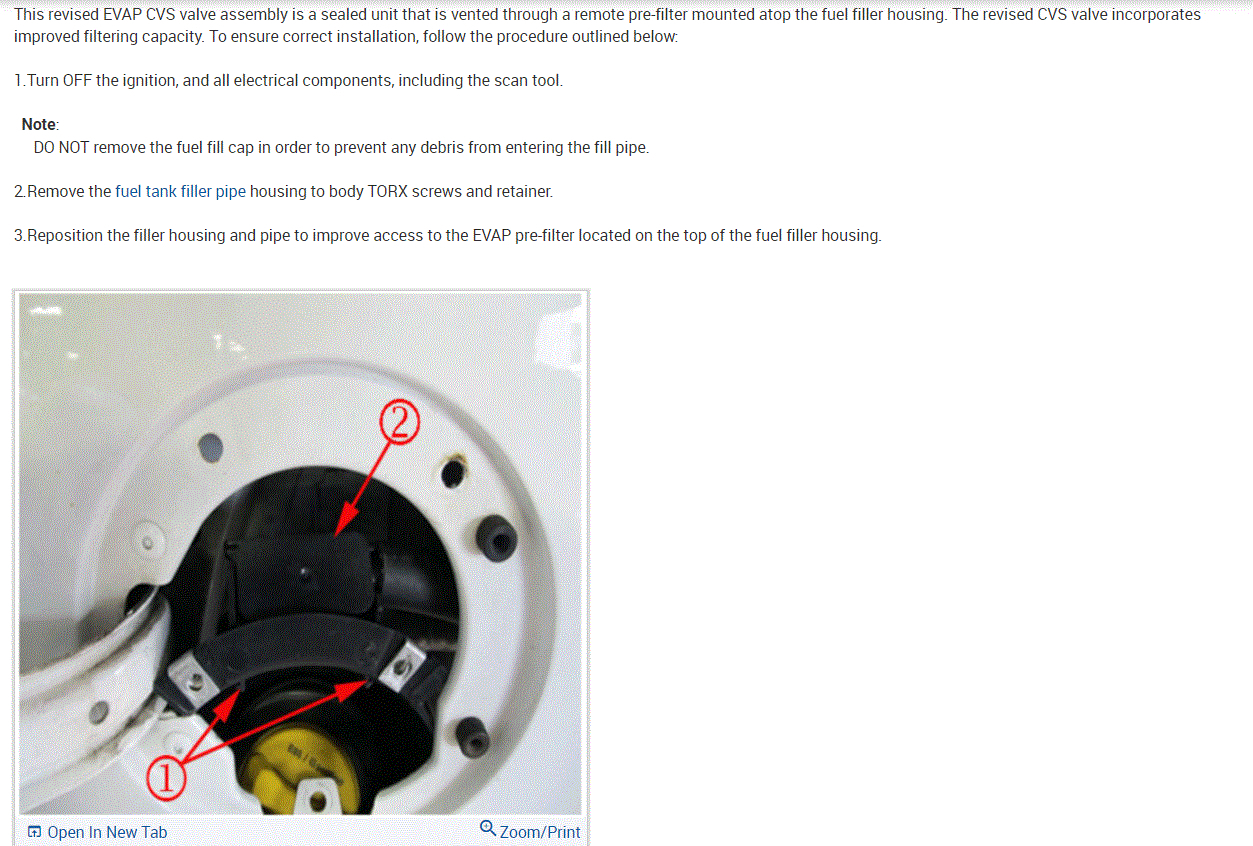

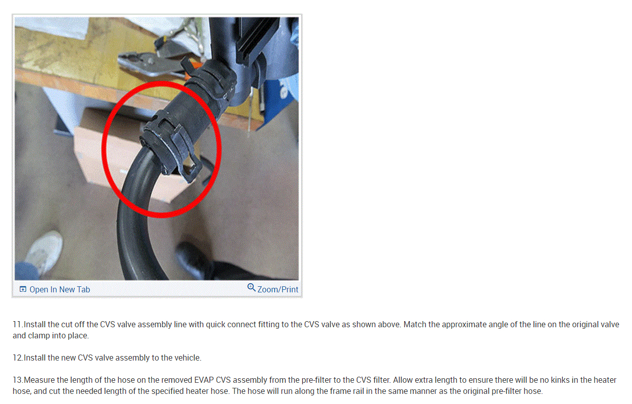

I found an interesting technical service bulletin you may find of interest. It deals with the fuel tank slow filling.
See the pics below and let me know if you feel this could be relevant.
Mar 29, 2021 at 7:08 PM

I’ll check on that!!! I got a code reader and it said P0300 which would be random misfire. I got light to go off and I drove it down road. I made it like 3 miles then stopped at stop sign and I could feel it shake. So I took off and it was sputtering and sounding like it was backfiring but not out of the exhaust and then it just started running fine and worked fine the rest of way home.

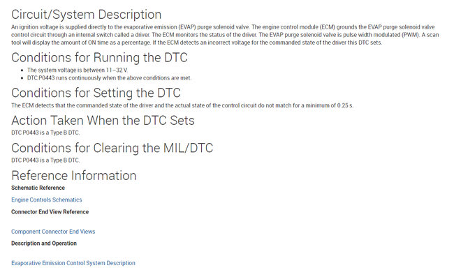

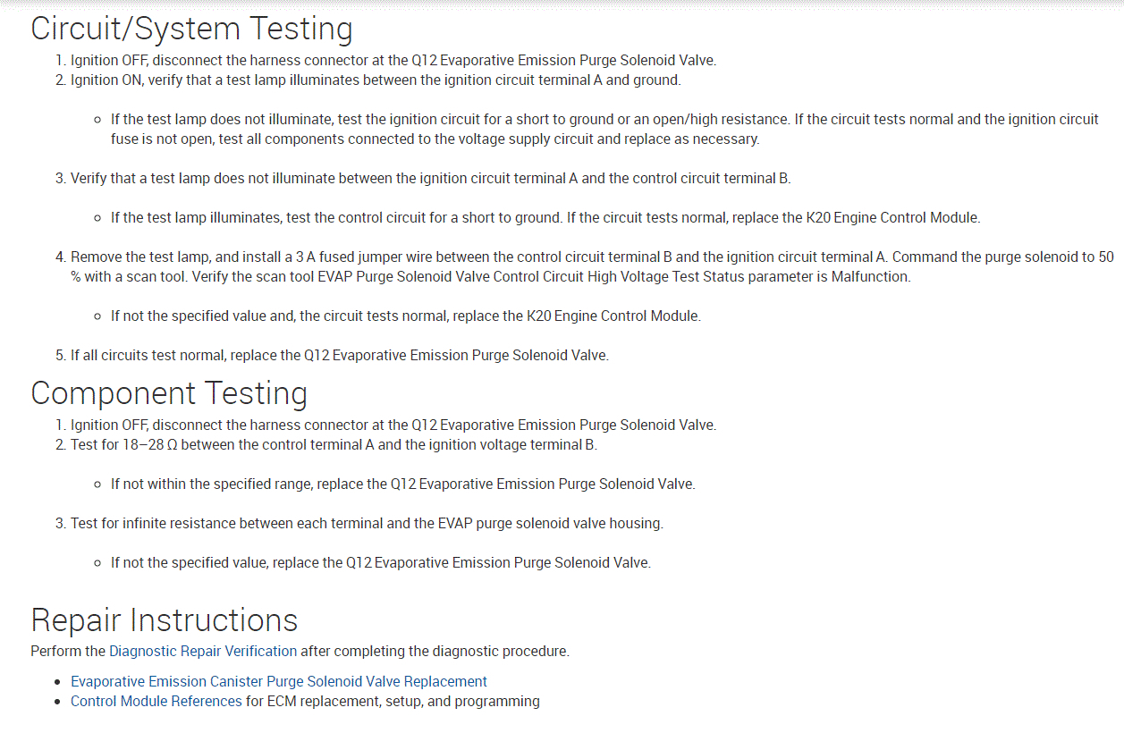

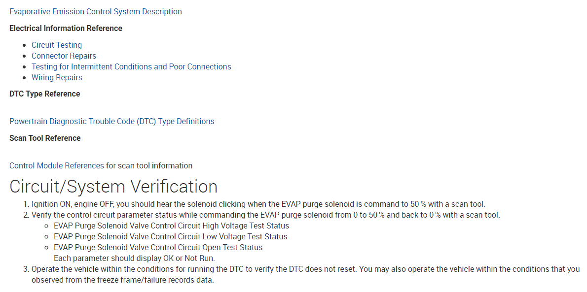

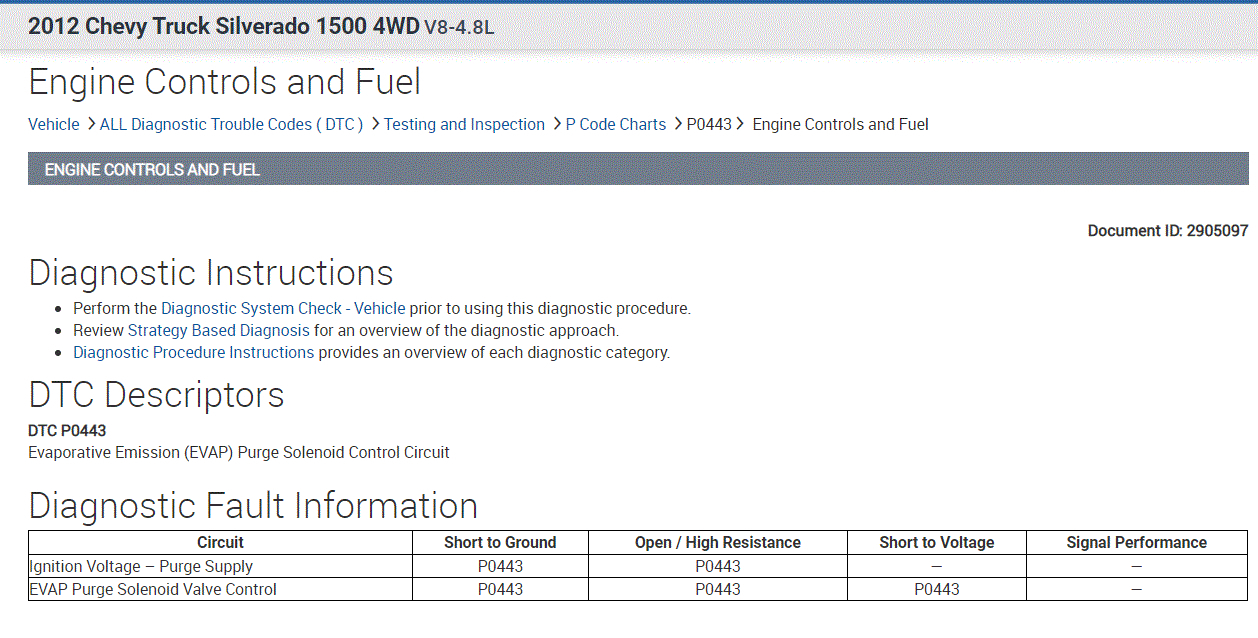

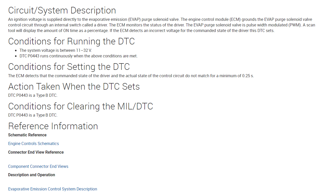

As far as the purge solenoid, you can't check it that way. You need to confirm power to it (using a scan tool that can actuate) and you check resistance in the actuator.
If you look at the attachments, I included the diagnostics and tests for the purge solenoid. Take a look through them and see if it is something you feel comfortable doing. If you need additional information, let me know.
Let me know what you find.

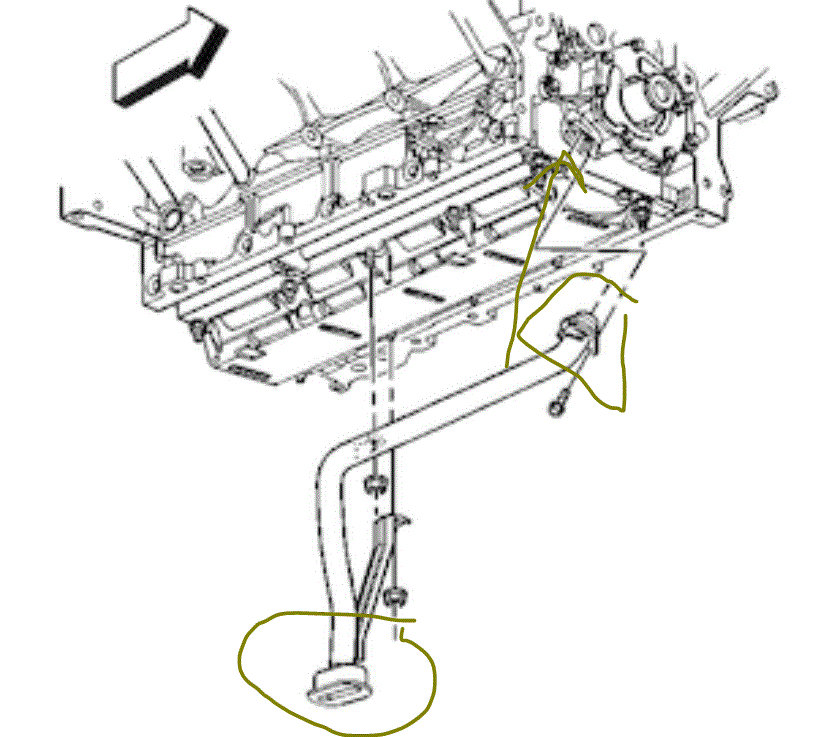

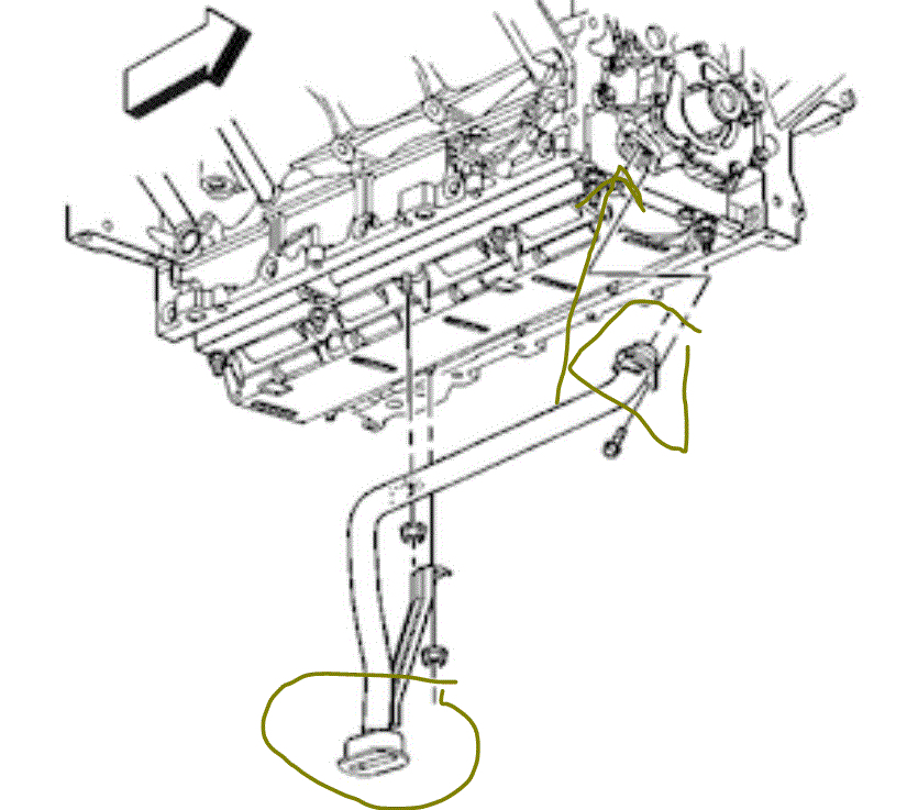

That is odd. You mentioned earlier that there was white smoke. If you check the engine oil, is it clean, full, and no evidence that coolant is mixing with it? Also, does it smell like gas could be mixing with it?
As far as dirt in the engine, if you replaced the oil pump, I have to assume the pick-up tube in the oil pan was checked to make sure it was clean, correct? And where the pick-up tube attaches to the pump was properly secured, correct?
See pic below for the two areas I'm questioning.
May 2, 2021 at 5:53 PM

Yes, I checked oil and it didn’t seem to be mixed with coolant and also the white smoke is gone. I didn’t check for the gas smell in oil yet but I will. And yes the pickup tube was flushed also when I put new pump crank and bearings in.
May 3, 2021 at 3:13 AM
If you are losing oil pressure intermittently, that is a big concern. The only thing I can think of is the pump wasn't installed correctly, the pick-up tube isn't sealing, or something is blocking the pick-up tube.
