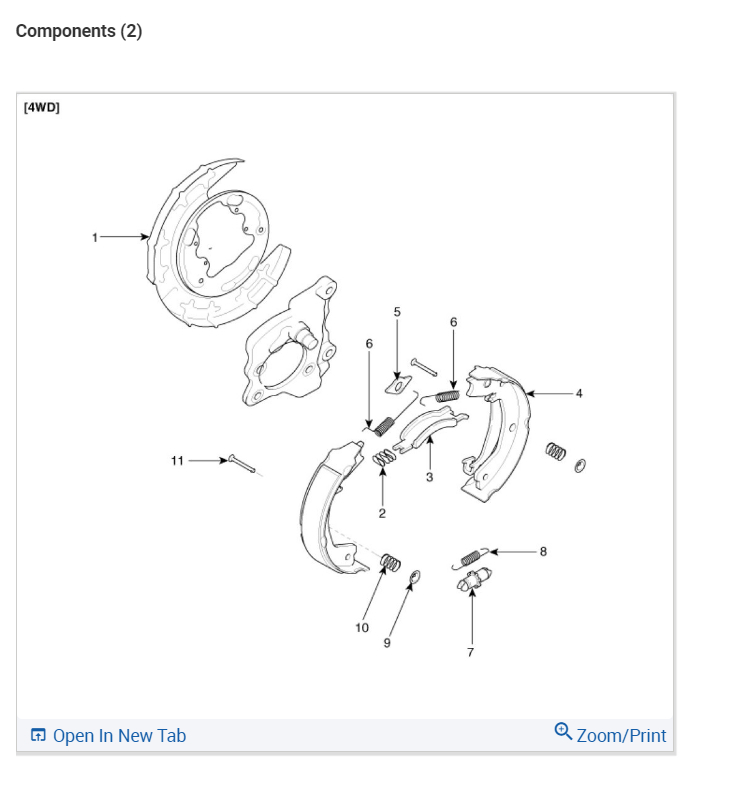

So, what happens is the parking brake cable gets locked and will not release. I would check the actuator arm on both sides to see if they are in the same position, also do you have the mounting screws out of the rotor? This video can show you how to remove a stuck drum/rotor. A rubber mallet won't work.
https://youtu.be/UV0kfP17Co0

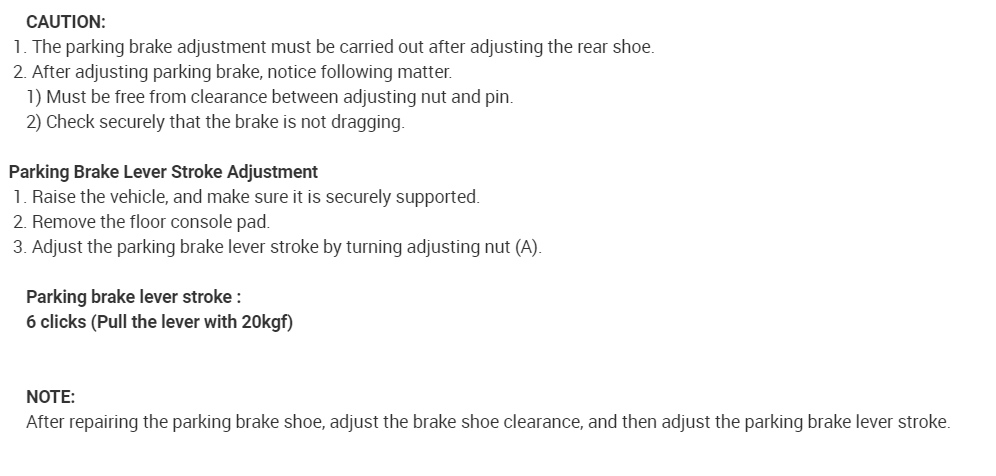

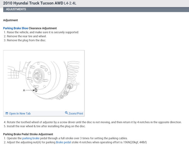

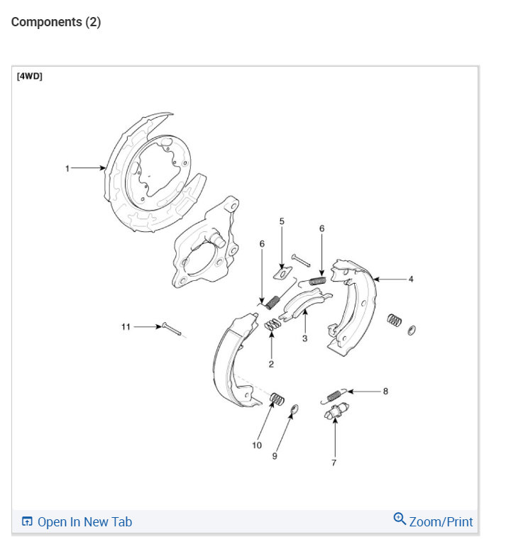

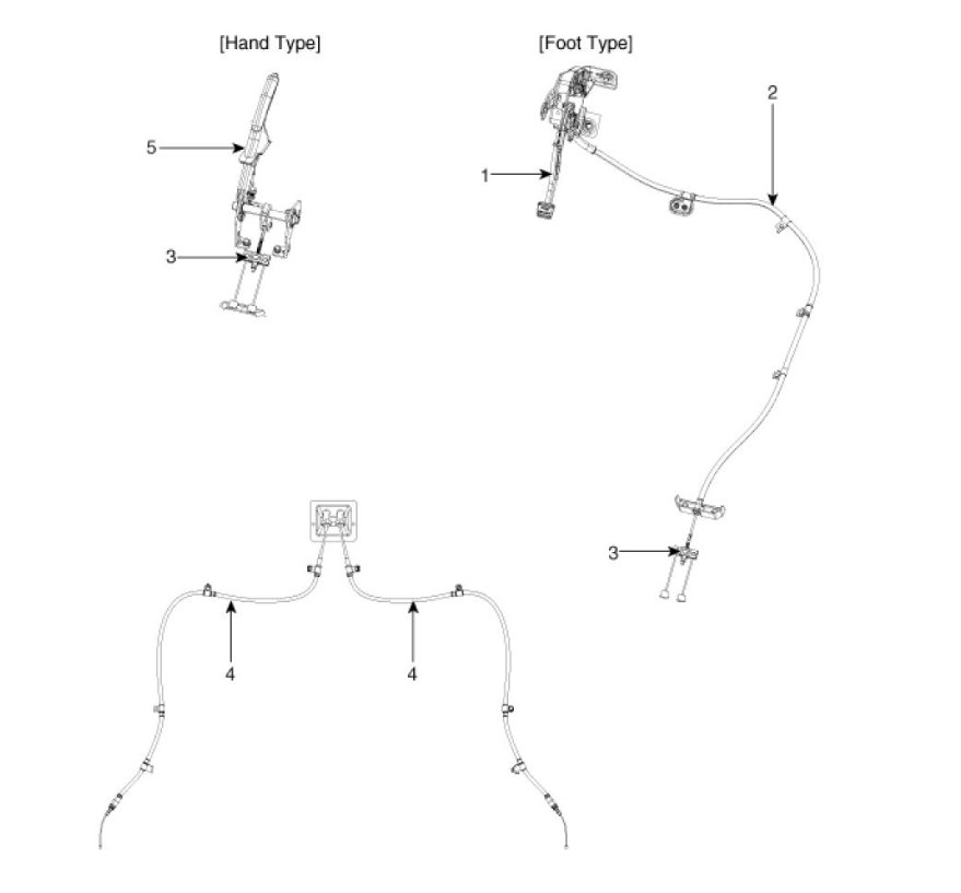

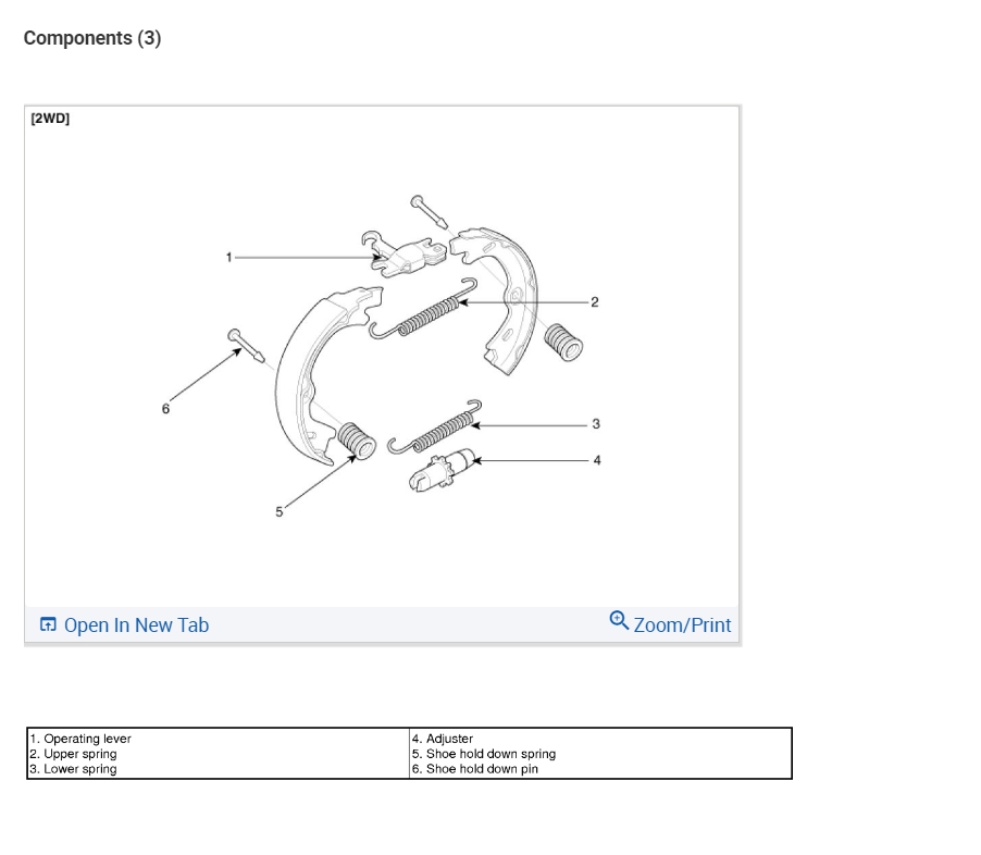

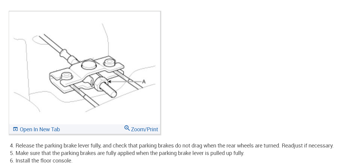

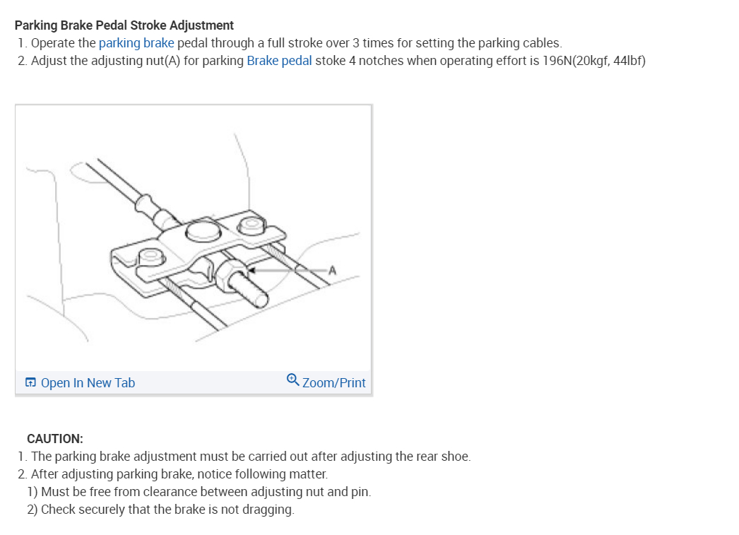

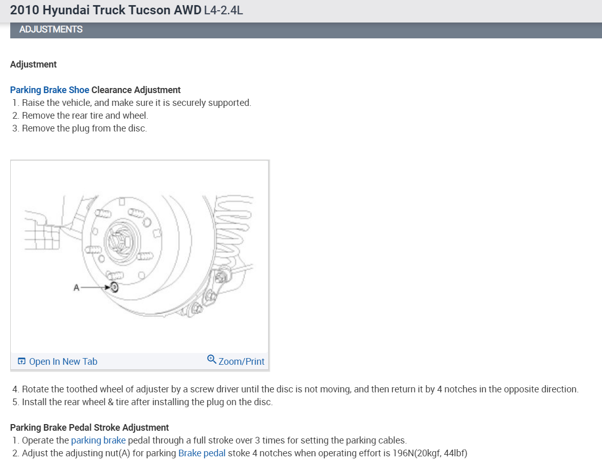

Here are the pictures of how the parking brake system works and how to adjust it. But it won't come off with a seized cable. Check out the diagrams (below). Please let us know what happens. Please upload pictures or videos of the problem.
