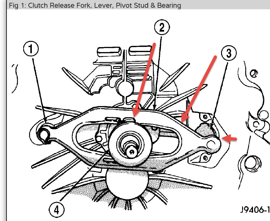

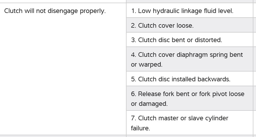

check for clutch disc installed backwards and for a worn or bent release arm and release bearing installed correctly . make sure fluid in master is full and slave works properly.do not disconnect hydraulic line if you take clutch out just move out of way.
