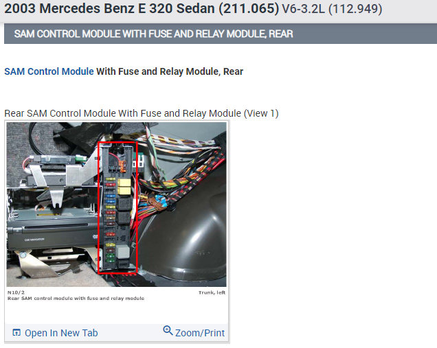

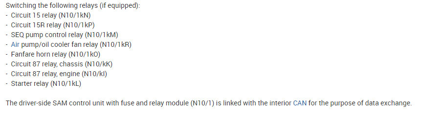

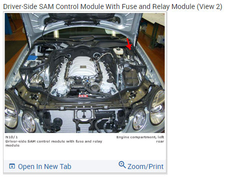

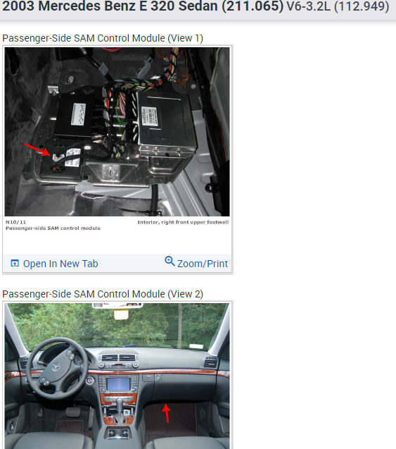

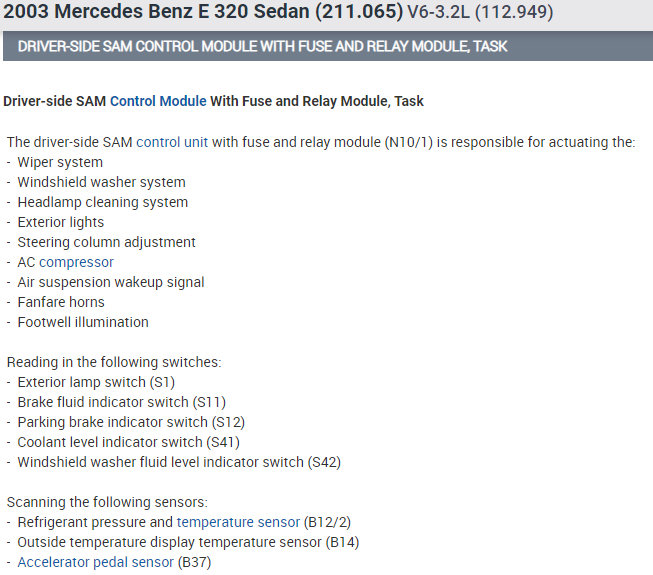

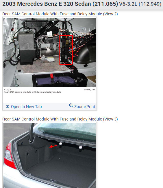

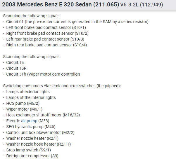

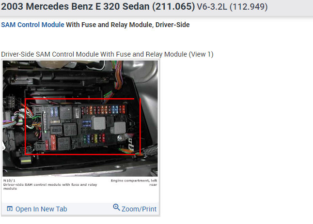

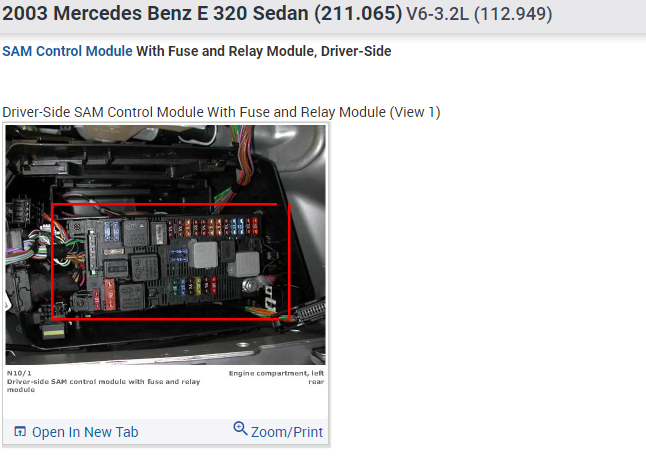

These vehicles have SAM control modules that could malfunction and create some strange issues.
First you need to figure out which SAM is bad then replace.
However the driver side SAM control module controls the A/C, wiper, lights and few other components that you are having issues with.
I have attached images showing the locations and functions of the SAM.
Please let me know any questions.
