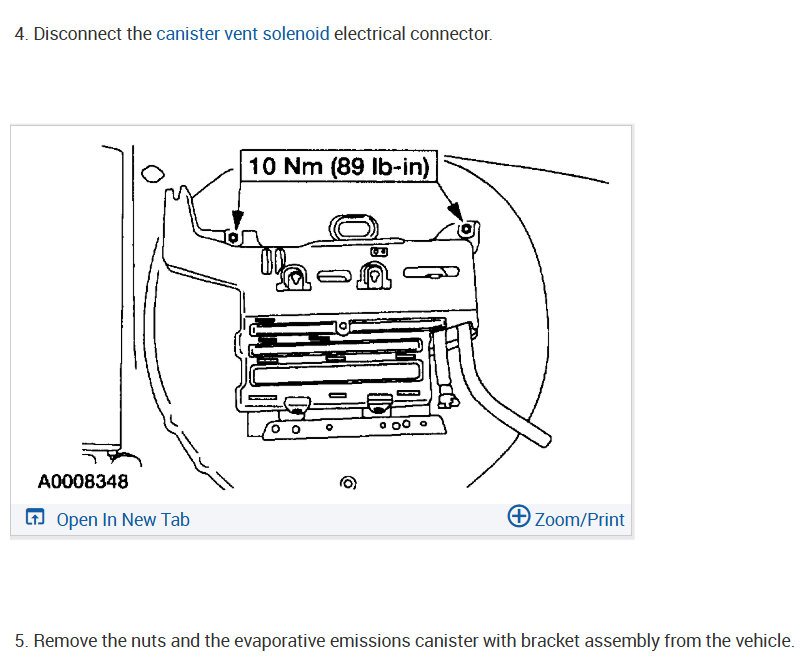

I need to know where it is located and how to access it on the vehicle listed above wagon.
Dec 13, 2024 at 11:25 PM

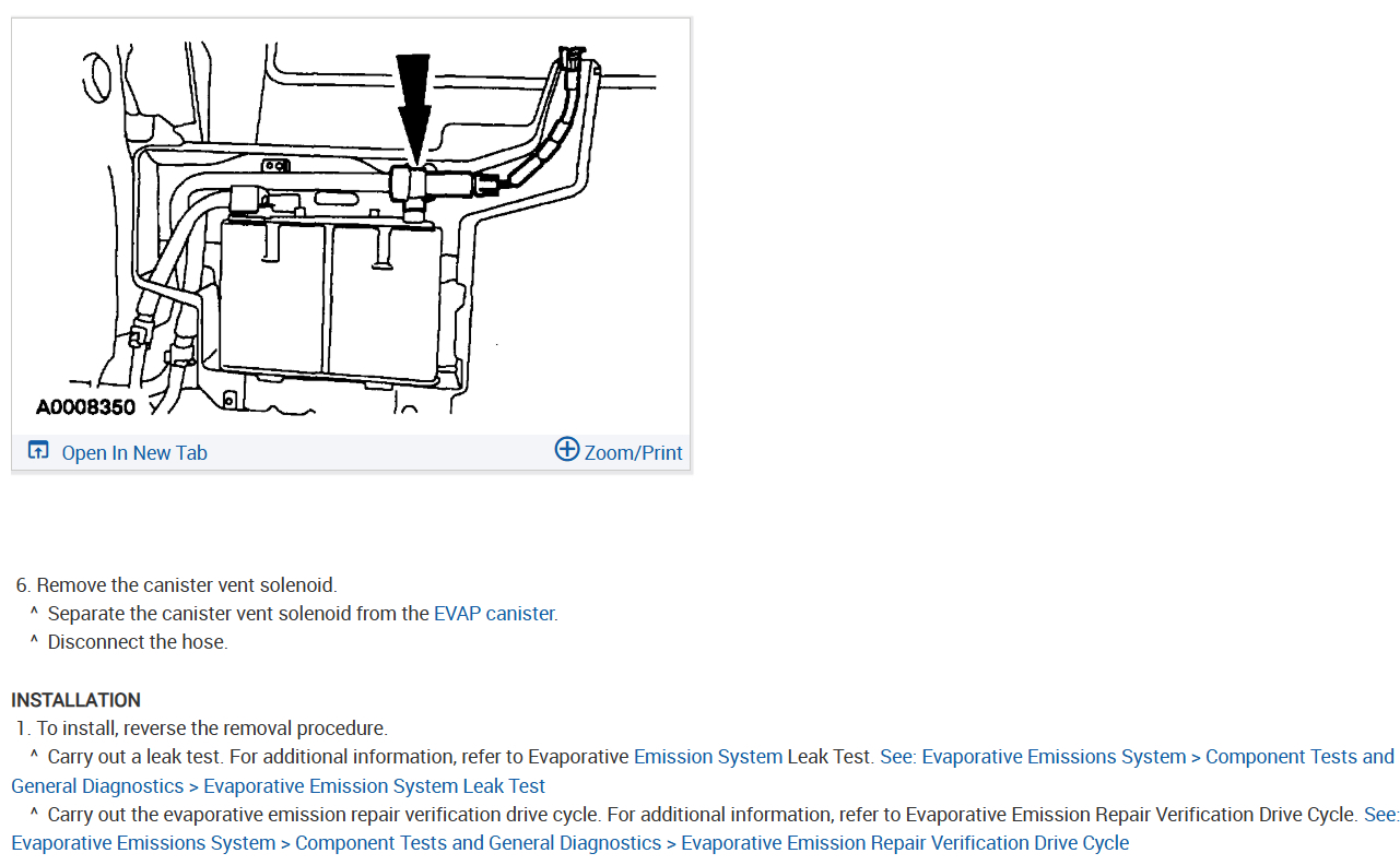

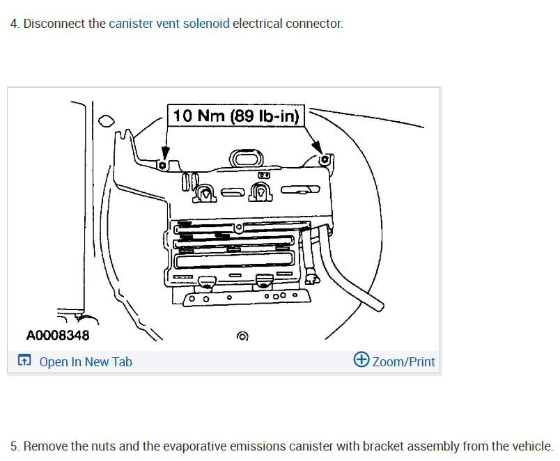

The EVAP canister vent valve is below the spare tire wheel well. Check out the images (below). Let us know if you need anything else.
