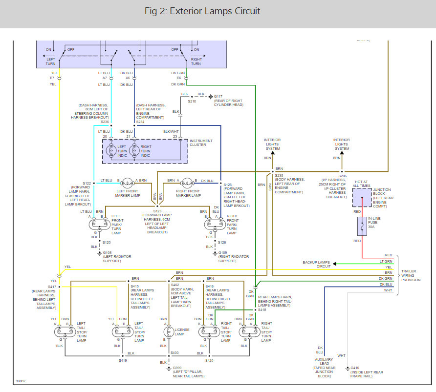

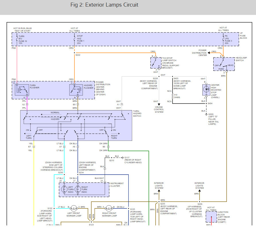

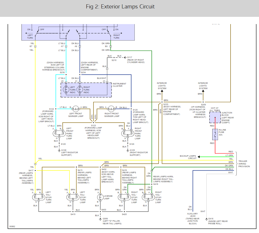

The only way it can stay going is if the turn signal/hazard switch is not cutting the circuit, but to be sure lets use this guide and the blinker wiring diagrams below to see whats doing on.
Check out the diagrams (below). Please let us know what you find.
