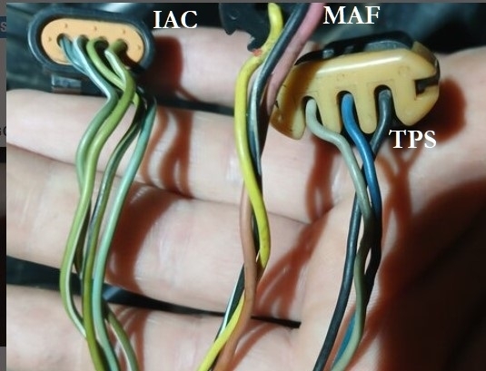

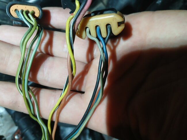

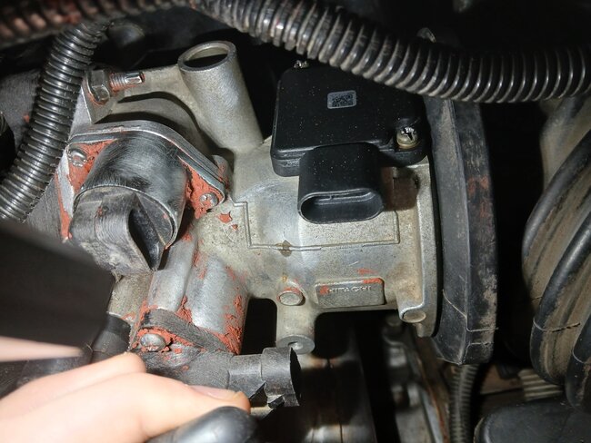

3 connectors got disconnected on accident. Trying to make sure I plug them in the proper one. Please and thank you for the help.

Picture below

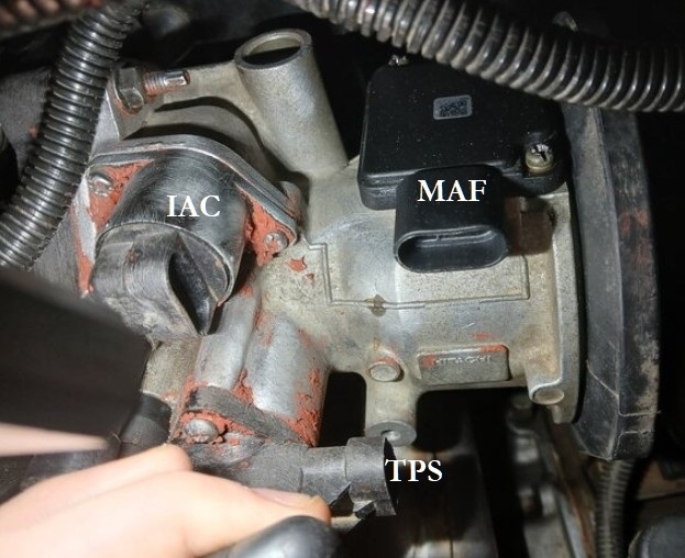

Hello, these plugs technically shouldnt be able to be plugged into the incorrect sensor in this case, since you're dealing with I can try to label them for you if that helps.

Hopefully these come out ok.

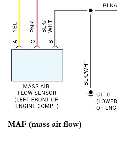

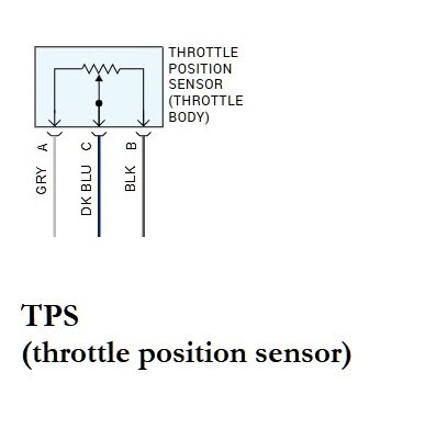

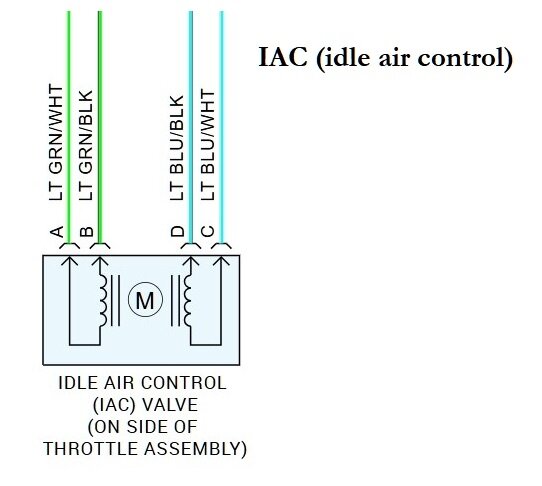

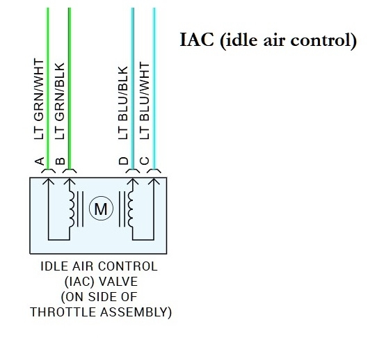

These are the wiring diagrams that show the wire colors for those 2 sensors and the IAC motor. But you shouldnt have any trouble getting these back in their correct places.
