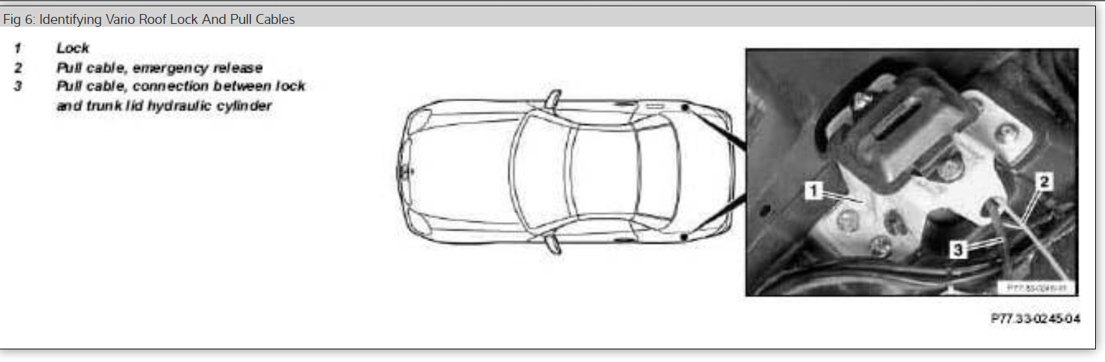

These car have a battery powered alarm module that goes out in these cars. Here is a video of the job being done.
https://youtu.be/3S0Ns3O3ULA
Here is a release guide for the trunk (below)
