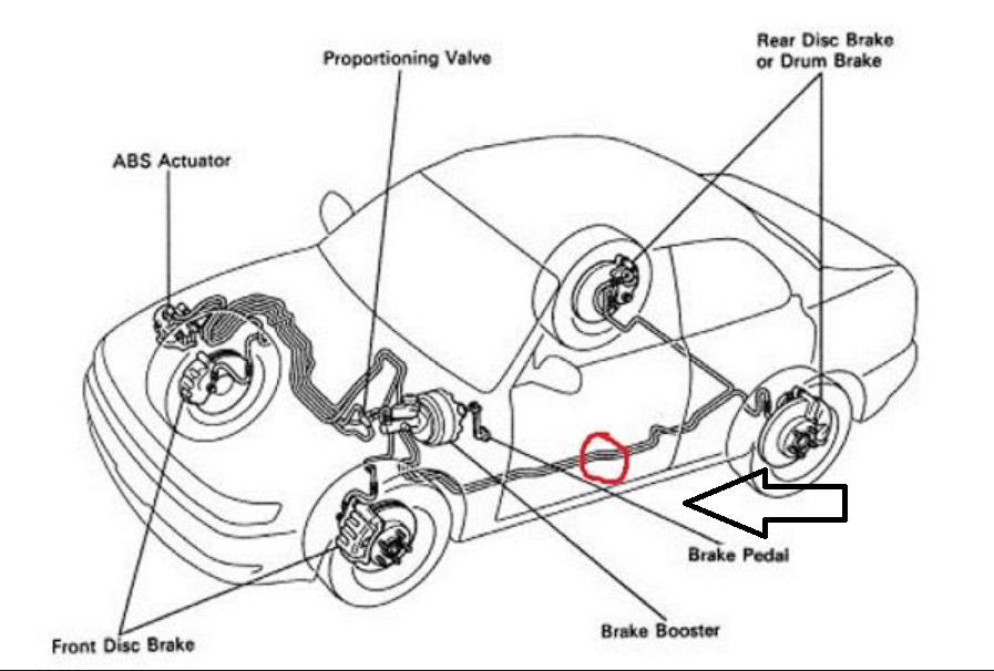

I'm also in snow. In fact, in my state, they throw a pound of salt on an ounce of snow, so I'm very familiar with rust. As such, I know there is no way you're going to solve this leak in any way other than to replace the steel line all the way from each end. That actually works in your favor, and it's likely you won't need the flaring tool. If your car has anti-lock brakes, follow the leaking line up to the hydraulic controller and remove it there. If you don't have anti-lock brakes, follow the line to one of the two lower ports on the master cylinder. Take that section of old line to the parts store to match it up. The soft brass fitting should be a standard, metric size, but if it's larger in diameter than the fitting on the new line, they have all kinds of adapter fittings to set you up. Measure the length you need to reach all the way to the fitting at the rear. That will not be all the way to the wheel because there has to be a flexible rubber hose first.
Replacement line comes in a number of standard lengths up to three or more feet. They'll have brass unions to connect two lines. Be sure to test-fit them so you don't end up with a metric fitting and a standard union.
I'd avoid, at all cost, removing the old steel line in the area of the leak. The line for the other side is going to be just as rusty, and any movement can be enough to crack it and cause that one to leak. Instead, use nylon tie straps to hold the new line to the group of old ones. GM likes to feed their lines through places that can only be accessed while the car is going together on the assembly line. It is not necessary to follow the same path. It's okay to go around sheet metal brackets, but avoid running it too close to hot exhaust parts, bend it to prevent it from rubbing or vibrating against sharp metal brackets. You can also cut a slit in a short piece of rubber hose to isolate the steel line from something it might rub on.
