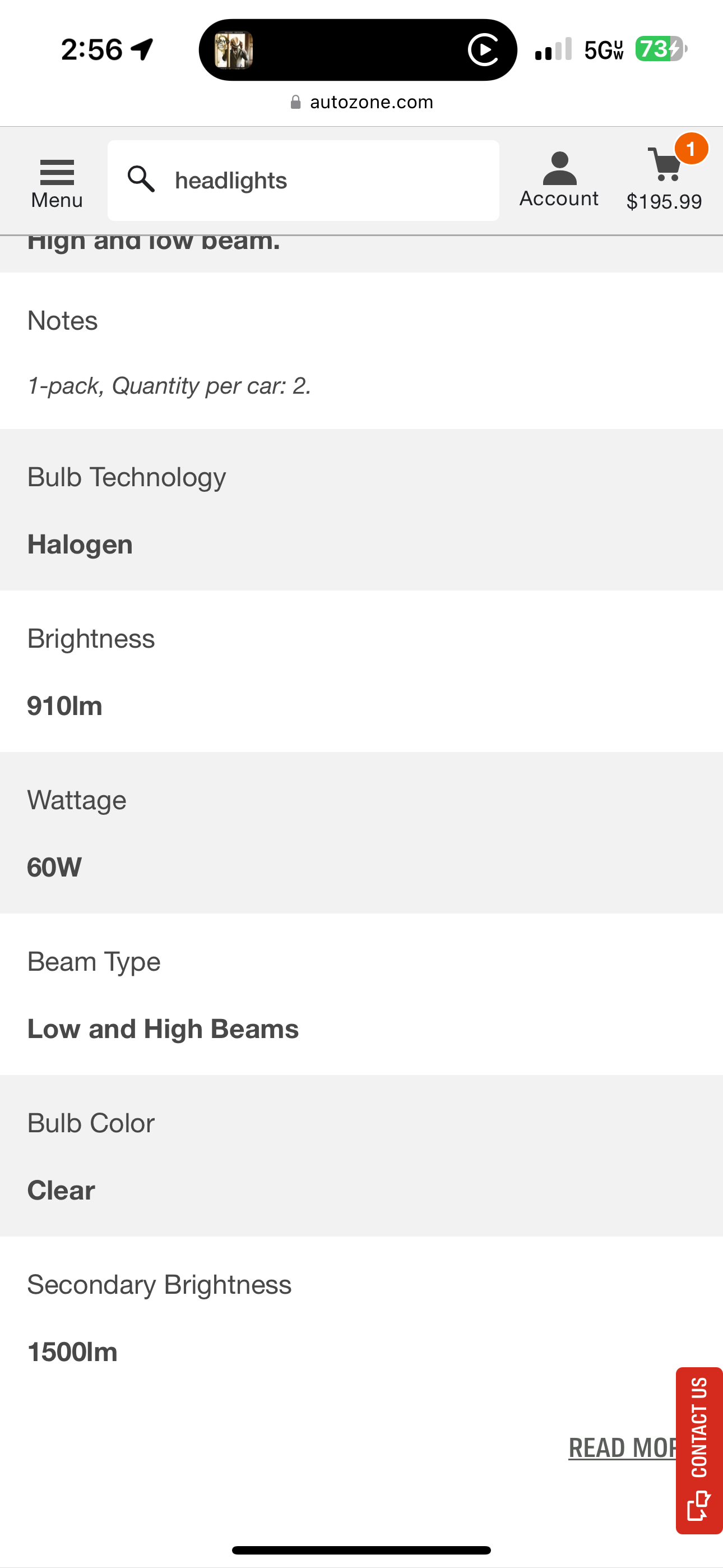

Okay, so what Halogen lights would you recommend that is brighter than the one I have now? I’ve attached a screenshot of the bulb description.

I generally use Sylvania Silverstar or Phillips Crystal Vision bulbs in vehicles that need better light from stock lamps. The drawback to those bulbs is a shorter lifespan generally. That is because to get the brighter lights the filament has to run hotter to generate the brighter light. You noted that you changed them a while back and they were brighter, that is also common with halogen lights their output gets lower as they age. Because of where I live and when my wife travels her car gets new bulbs every other year. Partly for brightness but also to combat the poor headlamp design on her car. Looking at the Sedan and the Note lighting, both look a bit underwhelming in design, similar to many modern vehicles. What I might do if the car were mine would be to change out the bulbs and look at adding a small LED light bar under the face of the bumper that uses a relay to turn on with the high beams.
For low beam operation see if you can add fog lights under the bumper.
