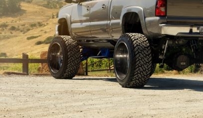

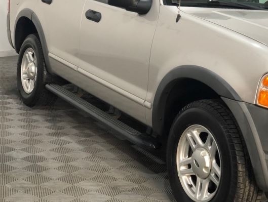

The bigger thing will be if the new rims have the same offset as the OEM in the first image, many people put on rims that push the tires out away from the hubs like the second image. That will do a lot of things, most of them not good. The steering radius will change because the tire is not pivoting on the axis of the steering knuckle, instead it now moves in an arc around it, next it will increase the stress on the wheel bearings a lot because of the leverage the offset on the rims causes. It also increases the likelihood of lug stud failure for the same reason and will not help with steering linkage wear. Lastly, because the tire now moves in an arc it will usually hit the body on sharp turns.
